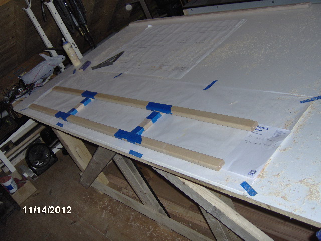

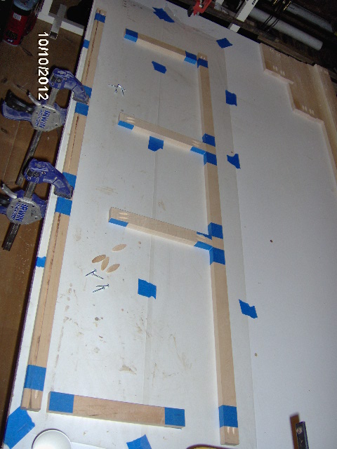

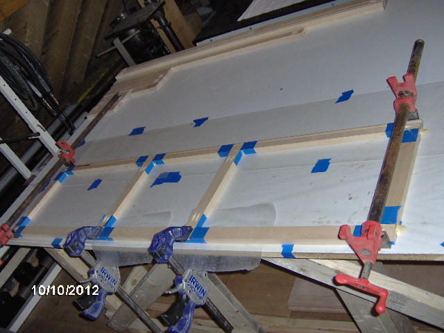

Last Wednesday (week ago yesterday) I put the second cabinet face frame together.
Dry fit and mask up.
Glue and clamp.

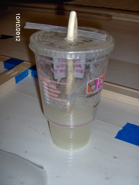

I don't think I've shown my glue brush keeper set up before. It's a large DD ice coffee cup. I use the cheap 1 inch chip brushes and just wipe them a bit w/ paper shop towel after use; poke it up through the straw hole in the lid just enough to expose the hole in the brush handle; fold the end of the straw in half and stuff it through the hole in the handle (trim straw to length); replace the water filling just up to the bottom step every once in a while; and it keeps the bristles clean and soft, and the ferrule relatively rust free (as opposed to just dropping the brush in a cup, which leaves the bristles down in the gunk and the ferrule in the water to rust more).
The brushes are only about a buck, but they last indefinitely for TB2 this way.

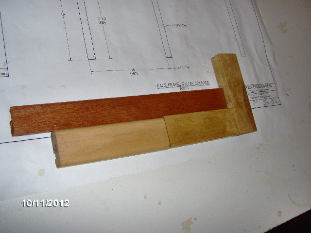

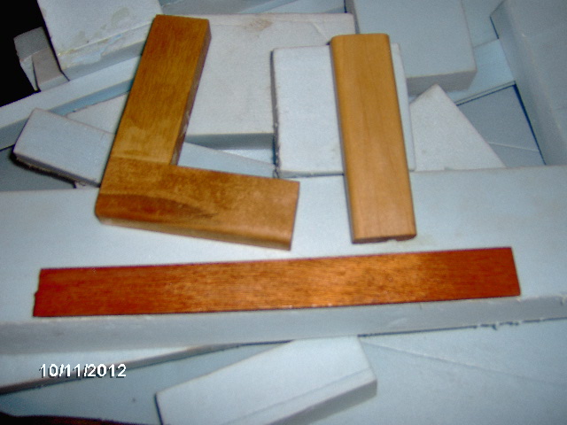

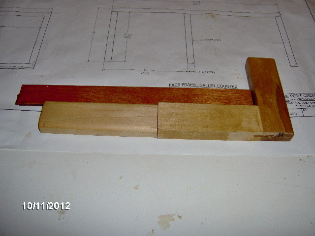

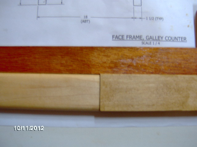

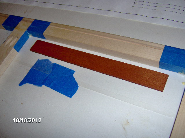

Wiped some minwax Gun Stock oil stain onto a scrap of Okoume and placed it near the maple for color contrast.
Thursday last I stripped the clamps and masking, trimmed biscuits, and sanded the slight variations in flush at the joints. Turning and re-clamping the glue and screw portions made a big difference there.
Couple of bonus shots of parts "in the queue".
Slapped some semi gloss poly on the Gun Stock/Okoume (wet here, yellow is from glare). On left is a test joint of maple with minwax Golden Oak oil stain (too dark for my taste and a bit blotchy...extra dark area is grain discoloration in the wood). On the right is maple with minwax Natural oil stain. I like it against the red Gun Stock.
Here they are closer together and swapped around.
Couple of angles with and w/o flash to vary the lighting. That yellow streak on the upper left of the Okoume is a blotch of glue that didn't take stain well.

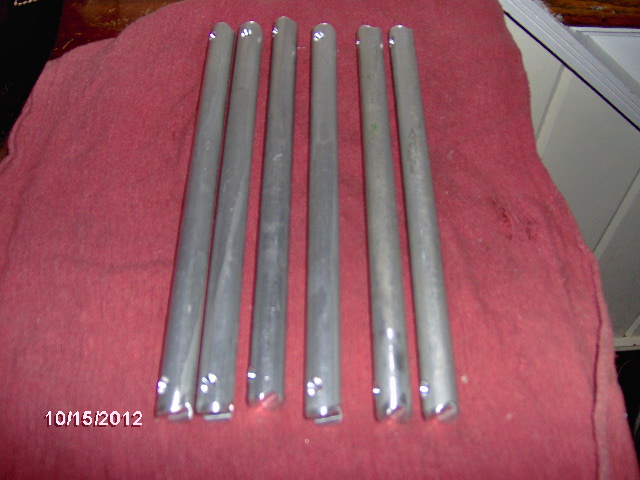

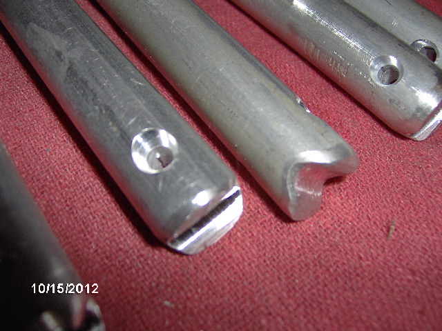

Monday I stayed after work and made these bow line separators out of 5/8 round aluminum. There are two bow lines that run from arm tip to arm tip on top and bottom, and at the center is a pouch that cradles the pumpkin. The attachment points on the tips of the arms are closer together than the pumpkin is fat, so these bow line separators spread the bow lines to keep them from cutting the pumpkin as it exits the pouch. The little knock in the ends registers on the bow line and the thru hole allows us to lash them to the bow line using thin nylon twine, that way when they hit the bundle stanchions with great force and break apart, we can replace them w/o having to restring the bow line. Hence the 3 pairs, one pair for each competition shot.

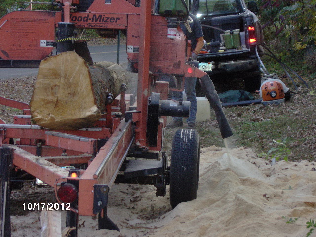

Yesterday I went to Mecca but got distracted by the ultimate wood working tool (saw dust teaser pic...story and more pics later).

Hehe...I worked on a site for a couple years where there was a guy came in with a woodmizer and milled 10,000bf of the cedar we felled. There was tons of cedar and fir left over: I've built two boats of it so far and am using the last of it in the trailer.
Once I win the lottery and start shopping for toys, that's near the top of the list.
Below the main battle tank, but still near the top.... :lol:

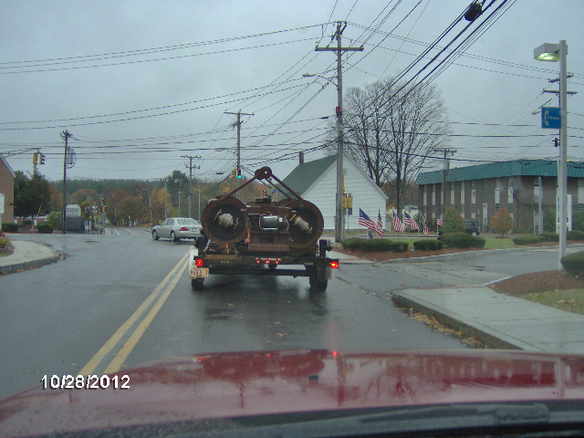

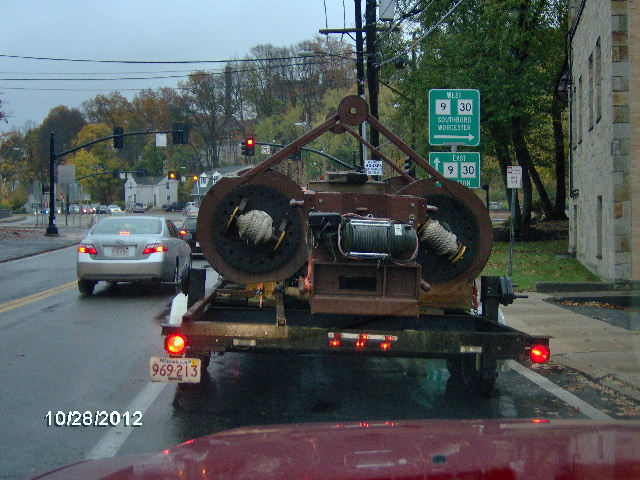

Last week Dave, Jeff D. (Nerd Herd Jeff, not smoked rib Jeff), Eric and myself met up at Eric’s place in MA to do the final pack up of both Mr. B and the small utility trailer that we use to tow support equipment (so towing is involved and that is how I justify using bandwidth here!). It was a drizzly day, but we made good time getting things ready. Despite checking the extensive lists of what goes where, it still seemed like we had lots more empty space than we should have, at least until we got everything in its place.
Since we travel on Thursday, we like to have Mr. B all packed up and over at Dave’s place for the transit down to Mecca (there is always some last minute fab work that needs to get done, and since the ride to DE is so long, Dave likes to pre-stage here on Wed. and have a driving partner for our early Thur. departure. On the same token, I will be towing the ute again this year, so I wanted to have that packed up and down here at Mecca, too. We used to leave late night Wed. and drive all night, but that gets old fast.

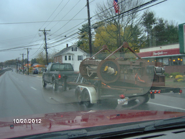

With the storm, Eric was reluctant to load his generator onto the ute, so we left that spot empty waiting to see who would end up with power after the storm. Karl’s power is not restored yet, so he is reluctant to commit his welder/generator. Still working that out, but we will need elec. power in the field, so … (update: Eric has power, so Dave will bring Eric's unit with him...Eric and others pile into mini van, so no room for genie there).
Here are a couple of shots of Mr. B on the road as Dave and I left Eric’s place. The rope bundles and forward stanchions are laid down on their backs and slide back over the axles during travel. The big black disks are 36 inch sprockets that we use to wind the rope bundles. The white blobs in the center of each disk (modioli… it’s Greek for “washers”) are the rope bundles consisting of 30 or 40 some odd wraps of 1 inch dia twisted nylon rope stretched really tight as it is wrapped into the bundle. The little round disks at the top with the holes in them are where we attach the hydraulic ram that we use to pull on the sprockets to twist the bundles. Between the ram and the sprockets we use a piece of roller chain, like on your bicycle, except that the rollers are 7/8 in dia and the pitch of the chain is 1 inch (IIRC). The side links on the chain are 1/4 inch thick! We call the chain "The Anaconda" because it is like wrangling one to handle it.
The winch on the back is a 15k lb Warn.

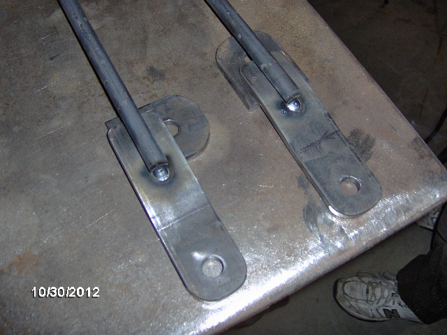

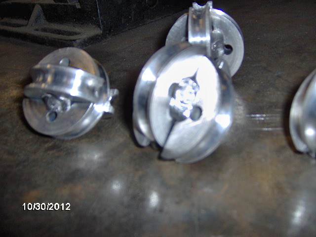

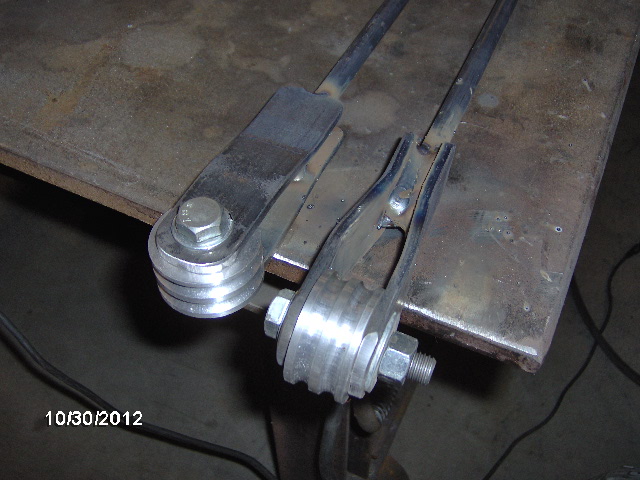

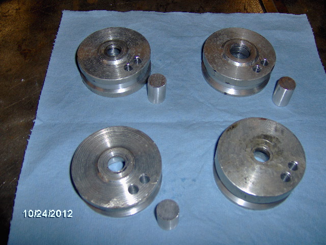

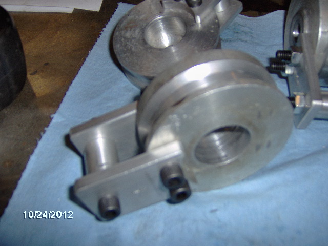

Anyway, here are some of the parts that I have been making for the compound bow line setup. These pulleys are fixed to the ends of the arm tips to give the eye splices in the bow lines something to wrap around. In order to compound we will be extending the bow lines (there are top and bottom lines that support a pouch for the pumpkin) so that a portion of line glides around each pulley (even tho the pulleys are fixed and should not rotate). The plan was to put a keeper loop around the front edge of the pulley to keep the bow lines from slipping off. Here you can see the two holes that Karl and I drilled in each pulley, and the little slugs of 5/8 round alum. that will be drilled thru to act as the keepers.
Whipped up some alum. tabs, drilled a few holes, and presto, arm tip pulley keepers.
In order to extend the bow line (which is some super swanky Vectran synthetic stuff, super light, super strong, does not stretch) with maximum strength, we needed a way to interconnect eye splices. Jeff D. came up with the idea from some electrical insulators and I ran with it making these couplers from 2 inch dia alum round. First I shaped a HSS cutter to groove the diameter; then I parted them off in 1/2 inch thick “pulleys”; then I drilled a couple of holes in each so that we could wrap the line with tie wraps to make sure that the couplers don’t flip out during moments of slack (like during installation and set-up); then mill a slot in each so that they can key together to form the coupler. Dry fit.
MIG welded on generator power.

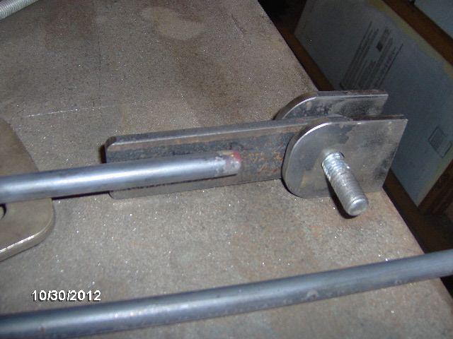

We don’t have enough of the expensive Vectran to reach all the way back to the available anchor point on the winch frame, and we would rather use material on hand than have to go out and buy wire rope cable and related hardware, so I devised these solid round bar link arms made from 1/2 inch round steel (about 4700 lbs. tension). The end that will get welded to the winch frame once we have Mr. B set up in the field and can figure out the final length of the links is shown dry fit here. The two tabs will get welded onto the winch frame with a little bit of space between for articulation. The hole in the strap tab that will get welded to the rod is just a touch over size, also for articulation. The bolt is 1/2 inch Gr 5.
The other end of the link needs to accept the bow line extenders and the best way to attach those is with more eye splices. In order for the eye splices to not slip out, they need to have some angle to the splice, which means that they need to wrap around something with some girth (hence the pulley like couplers above). So at the front end of the anchor link rod I devised a clevis consisting of bent flat bar tabs and alum double groove pulleys. Here are the formed clevis yoke halves tack welded onto the rods just before Karl MIG welded down all sides of the rod.
(The other tabs are just sitting underneath as temporary shims during welding.)
Here are the completed clevis' after bolting on the other sides using the pulleys as spacers and welding to the rod down both sides.
The two bow line extenders from each side of the ballista will be laid into one pair of grooves with one link rod located on each side of the winch frame.

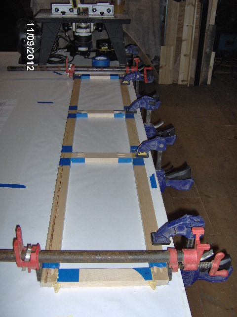

Tonight I went up to Mecca and glued up the last of the regular cabinet face frames; same as previous ones except shorter. This one is for the upper rear cabinet in the cabin. I took 2 pic's and will post eventually.
Left to do along those lines is the galley under counter face frame and the frame that makes up the front rails of the upper galley shelves. The later has a couple of vertical stiles in the center to tie the two shelves together.

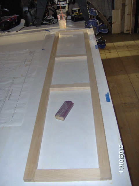

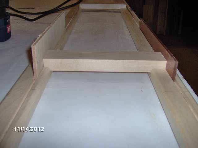

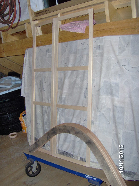

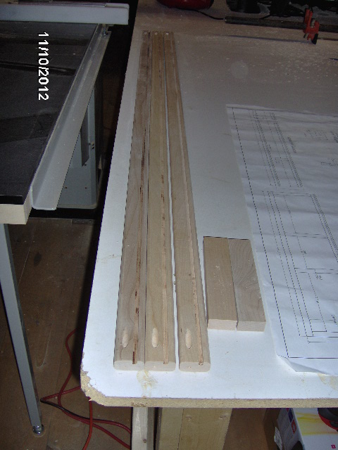

Anyway, on to Mecca. Yesterday I had masked up and glued the upper rear cabinet face frame.

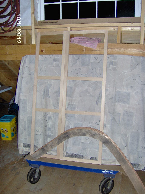

And today I stripped it down and sanded all of the joints flush, broke the edges a tad, and parked it with the rest of the pile-o-parts.
Karl commented that the face frames are looking good, so I guess I am doing something right! :thumbsup:

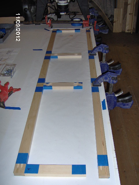

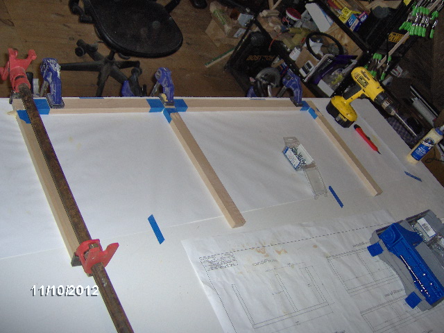

Then I masked and glued up the under counter face frame for the galley. This only covers the left and middle bays. The cooler bay on the curb side needs a little more height so the counter will only be supported by the trim edge on that side.

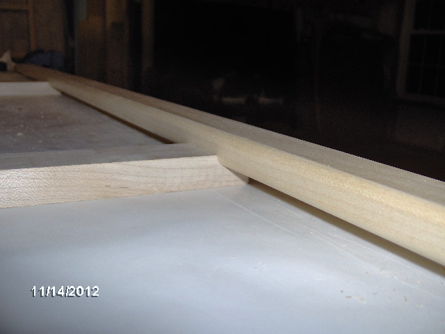

Then I moved onto the missing shelf edge, slotting the dado on the table saw and rounding over the edges on the router. This piece of wood has a slightly different color, a little more brown/coffee/chocolate than the white/yellow color of the first batch of maple. I'm hoping that it will not be so noticeable with the shelf set back under the upper forward cabinet, and once stained. That's it on the left of the three.

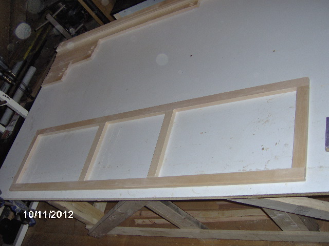

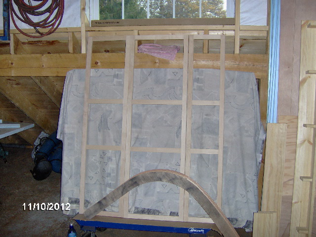

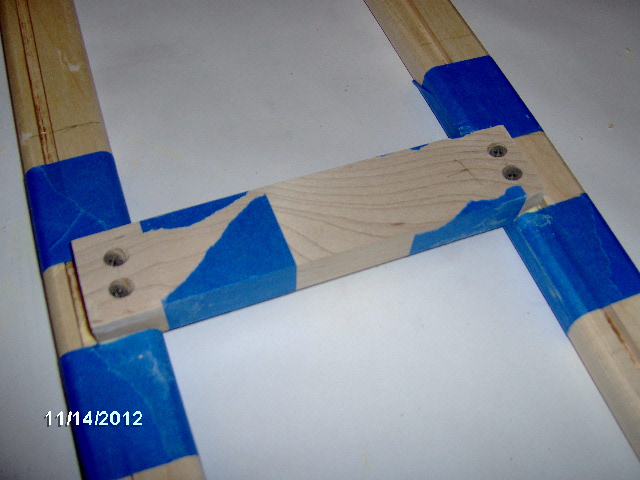

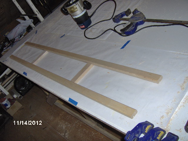

During the week I completed the cabinet and shelf face frames. Here's how it went.

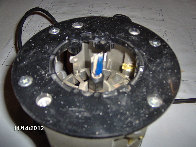

Changed the 1/4 round over bit in the router out for a straight flute. While I was at it I took the depth adjuster body/shoe assembly off and cleaned all the sawdust out of the big thread to free it up again; it had been getting difficult to adjust.
Moving on with the galley shelf face frame, I set the router depth to match the shelf slots in the back of the shelf face frame rails, laid out and clamped on some guides, and sort of partially freehand routed out some pockets for the galley shelf stiles.
And here is a mock-up of the shelf face frame to give you a better idea of what I've been trying to describe. The two front edge rails for the lower and upper galley shelves are laying face down on the bench with the lower rail to the right and the upper rail to the left. The two stiles (that are spaced the same as all of the other cabinet stiles) are fit into the pockets shown in the previous pic, and the slivers of scrap 5mm ply represent the shelf panels.
Here I am checking the dry fit from the front of the shelf face frame (er...that will be facing to the rear of the camper).

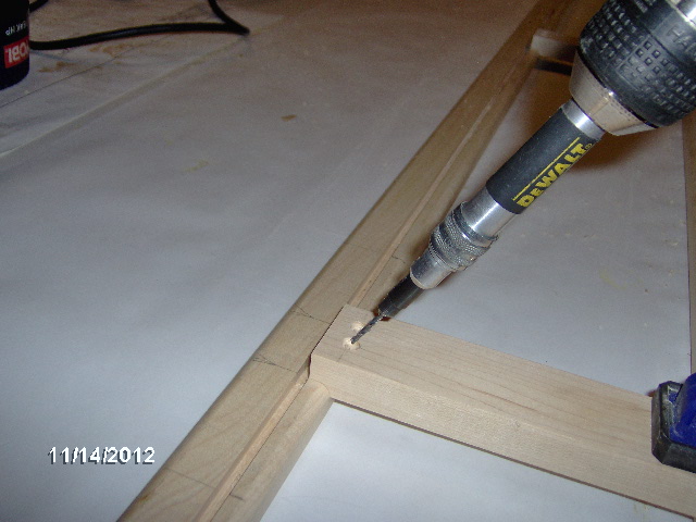

Not a lot of meat under the upper shelf slot, so when I pre-drilled and counter sunk for the screws I toed them in at about 60 deg. Had to do some careful checking of the drill depth setting, depth of countersink, and screw length to make sure that it didn't poke through the front side.
Masking tape, glued and screwed.
Here is the under counter face frame that trims out the two dividers that will support the galley counter and divide the space into three compartments. It was built in the same fashion as the other cabinet face frames. There will be another rail that runs across the top of this spanning between the walls of the galley and trimming out the front edge of the counter underlayment. That piece will overlap by the thickness of the counter, leaving a shadow line that will reveal the top rail on this piece. The third bay has been left open to give a little more clearance for the cooler on its slides without having the counter top get that much higher.

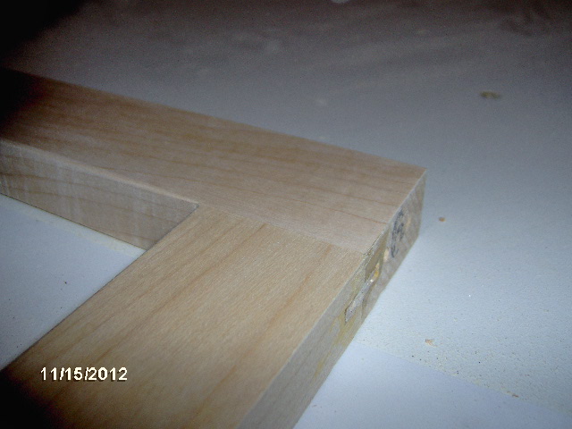

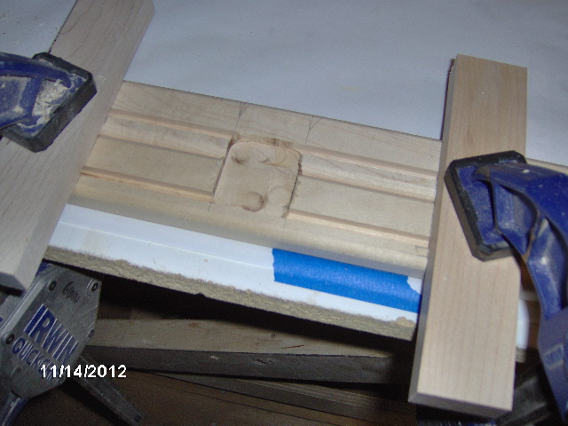

Okay, confession time. When I laid this out I did it to the drawing, but I was working from the rear and the drawing showed the front. Sooooo...the pre-drilled Kregg holes to attach it to the left side wall (and the biscuit for the leg on that side that sticks out the hidden side), and the second leg on the open end that was Kregg screwed up into the rail so that the open end would not show any biscuit both ended up on the wrong end...with the middle leg offset to the wrong side. (huh?...It was all bass-ack-wards). So the simple solution with the least impact to the final finish appearance was to relocate the middle leg (unscrewed it; popped the glue joint; sanded away the glue; filled the two tiny little screw holes in the underside of the rail; repositioned, masked, glued and screwed) and slide the frame over relocating the cooler from the curb to the street side. My cooler has clam shell lids that can be swapped end for end, so there is no problem with which way the cooler opens vs. where the drain hole is, and I was smart enough to include the extra blocking in the wall in case I wanted to add sliders to the street side bay, so it worked out okay.
Here's a closeup of the right side front joint showing the exposed biscuit and the Kregg screw holes that would have been exposed if I didn't flip the cooler over to the other side. This now goes up against the curb side wall, and the cooler goes in the open bay on the street side.
And the Pile-O-Parts grows.

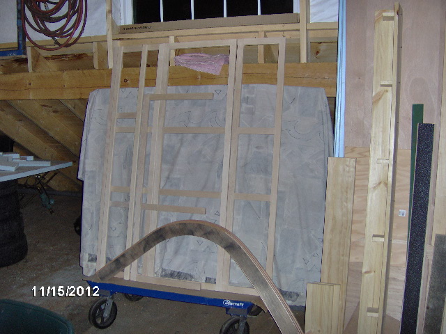

A little more on the cabinet plan. As noted, the face frames will also act as structural "spars" between the walls and supporting the roof. I'm not sure that I have described how the shelves/cabinet bottoms will be supported. In additin to the slots (dados) at the "fronts" (back sides of face frames), there will be additional 1/4 rnd trim fastened and glued under the "backs" and sides of each shelf/cabinet floor panel. I'm still pondering my blocking plan, and second guessing myself. The bulkhead and side walls are pretty well figured out, as far as the cabinets and shelves go, but I may need a few more points in the front wall. I need to spend some more time with the CAD model and do some tests trying to nail small maple trim... or resort to pre-drilling and doing it the old fashion way with a hammer.
Looking at the last Pile-O-Parts pic it looks like the stiles in the galley shelves are not spaced the same as the rest of the cabinets... hmm :? :o Maybe I screwed up... again? :roll: :oops:
