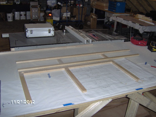

Started by figuring out what I had done wrong on the under counter face frame. Besides building it backward, I had built it out assuming that I had already cut all of the pieces to final length back when I did all (most) of the saw work. Well, turns out that I had not cut the top piece to final length (DOH), and that caused me to miss understand part of the problem. The other part was that the galley cabinets actually have the stiles placed at a different spacing than the inside cabinets (which I miss stated earlier, and is clearly shown on my paper hard copy of the plans). After measuring a few things and figuring out where I went wrong (...again this time), I reminded myself that the reason that the inside cabinet spacing and the galley cabinet spacing are different is because: (1) on the inside I wanted the middle bay to be a little narrower to accommodate a laptop or small net pad (in the event that I decide to add movie capabilities) leaving larger bays to the outside for clothing and personal items, whereas (2) in the galley the cooler width dictates that the outer (now left hand) bay be a little narrower (the cooler loads end wise), and for the sake of symmetry, also the right hand bay, leaving the middle bay wider. Clear as mud, right?
Anyway, the bottom line is that I reworked the under counter face frame again. Pulled the two Kregg screwed legs off, put the one back where it had been "before the correction", shortened the top rail, masked and re-glued and screwed the two legs (or stiles) back on.

Here's a pic of that counter face frame fix I mentioned. The upper galley shelf face frame is shown above, with the under counter face frame corrected and dry fit below, in reverse (i.e. looking at the back side..when flipped face out it will be on the curb side).
That was Wednesday eve. After dry fitting, I masked, glued and screwed, again.

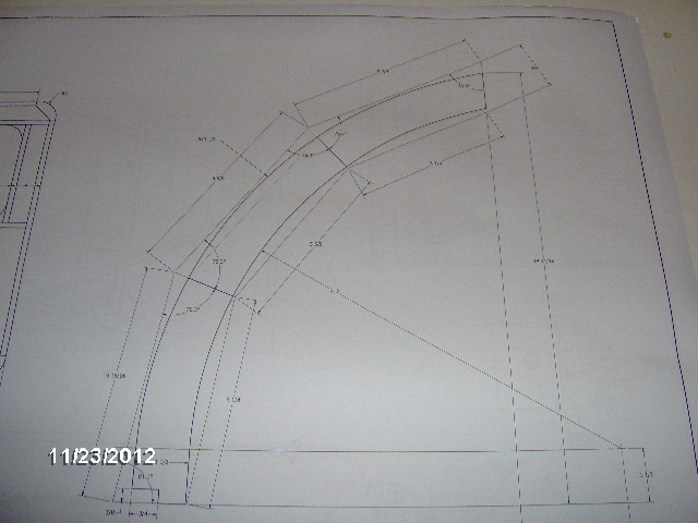

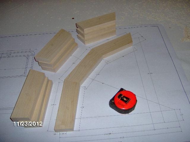

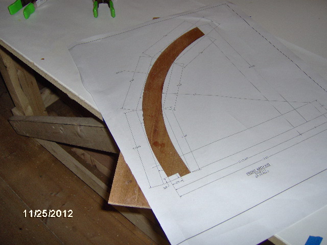

Finally moving on. Here's a pic of the full scale plan for the front radius arches.
The final arched rib detail is shown superimposed on the mitered stick assembly. The mitered joints are all the same angle, but the top and bottom cuts are each different. And, of course, the angles are irregular, 76.3 deg for the miters, 63.5 deg at the top, and 81.1 deg at the bottom. The power and curse of 3D modeling.

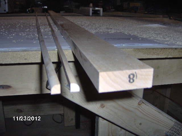

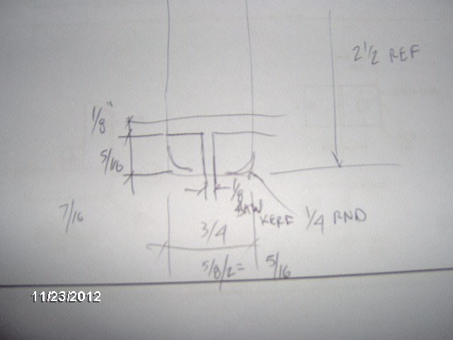

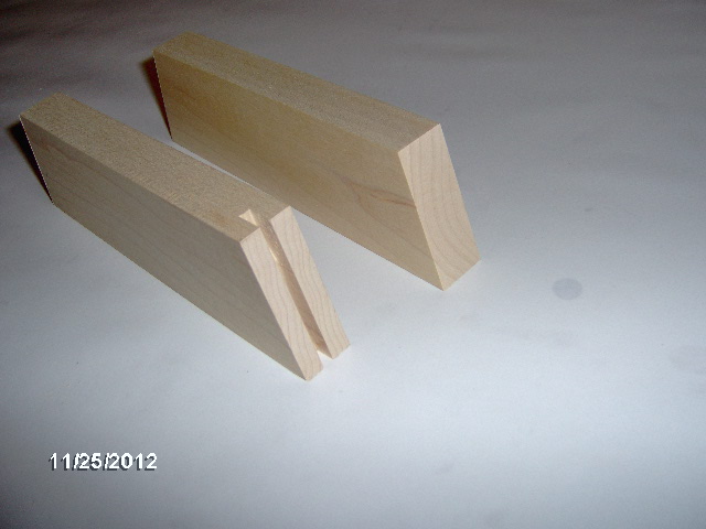

Well, the arch segment blanks only need to be 2 inches wide, and I need some small 1/4 round trim to use as the ledgers for the shelf and cabinet floor supports, so I started by making the 1/4 round out of the edge of the 1x3. First I set the router table back up with the round over bit and the feather board.
Here's a sketch of the idea.

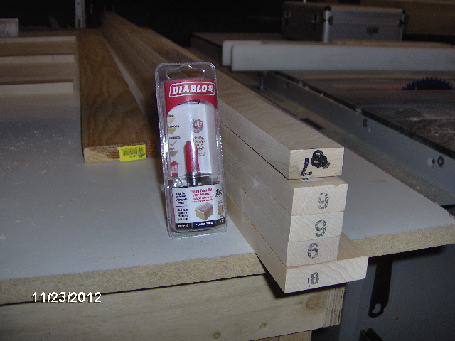

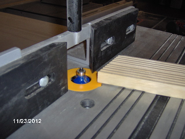

Then I ran both edges of the 1x3 through the router. Actually, I ran each edge through a few times because the board wanted to tip a bit due to it being so long and me working alone w/o out feed rollers. Not a big deal, just had to run it through until it was all uniform.

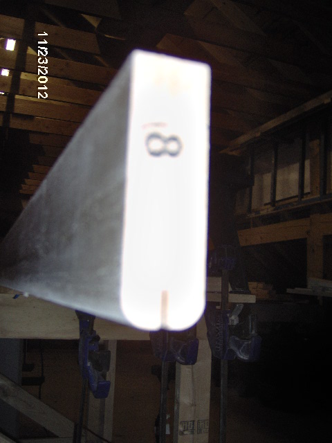

Then I ran the board through the table saw on edge with the blade depth set shallow, flipping it around and running it through again to make sure that the slot was centered.
Then, without changing the fence, I set the blade higher and ran the board though on its side getting this.
The board was still just a shade over 2 inches, so I reset the fence and ran it through again.

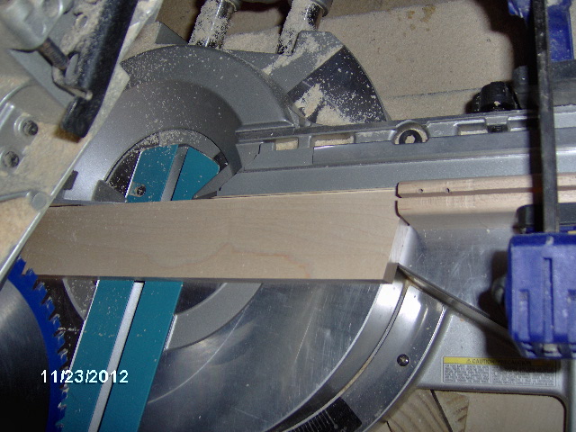

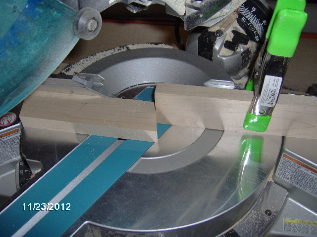

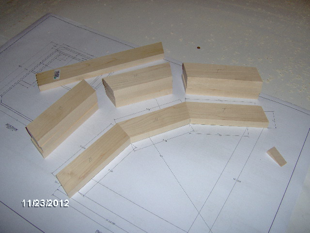

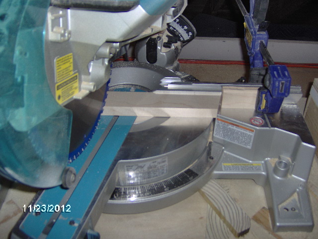

Then to the miter saw. So first I set the saw for the 76.3 cuts, did a test cut and laid the part right on the drawing to check. Once I was happy with the angle, I set a stop block for the length. After the initial cut all I had to do was flip the board, place it against the stop, make the next cut and repeat. That gave me the middle pieces for all four arch ribs.
Then, in order to maintain the exact complementary angle, I left the saw the same and cut the top and bottom pieces a little long using the same angle at each end.
Then I reset the saw and stop for the top angle, running the top pieces for their second finish cuts. Then reset for the bottom angle and made the second cuts on those
Ending up with this.

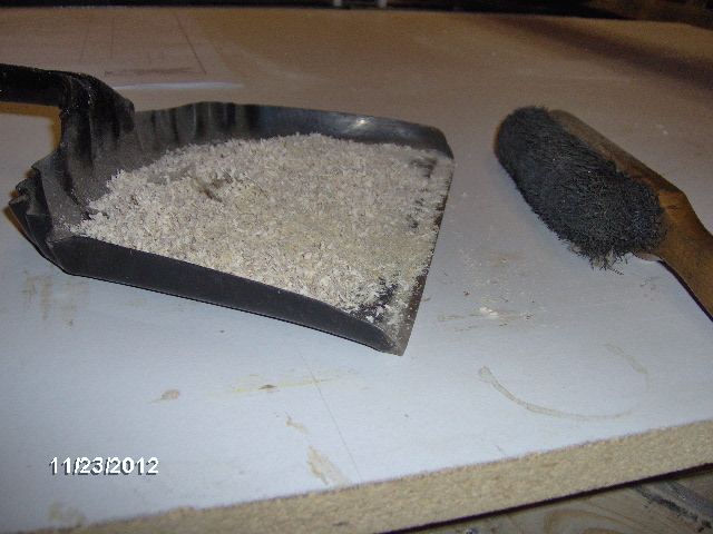

This evening we are serving a fine helping of maple saw dust and chips.
And with that I called it a night. Hope to make a bunch more progress tomorrow.

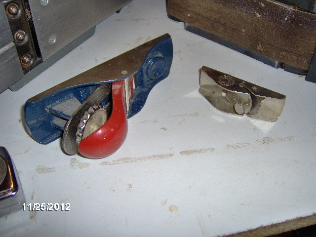

Spent some time sharpening the blades for the hand planes, but forgot to take a pic of the bald spot on my wrist where I scraped some hairs away. Ran a few of the motors, and those worked fine so far.

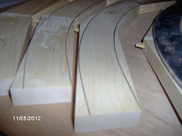

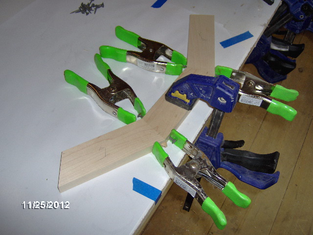

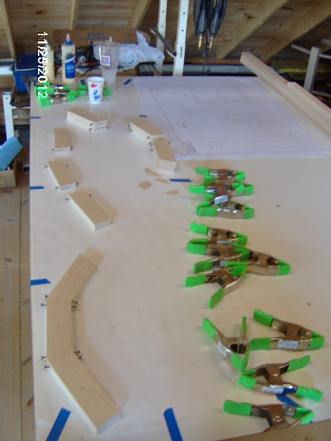

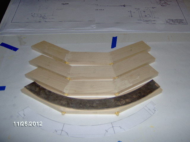

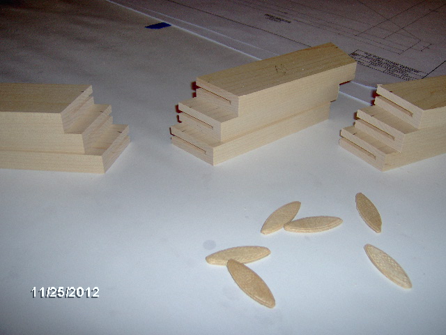

Then I went back to working on the front arch ribs. Laid them out in sets and figured out where to put the biscuits so that they would not poke through on the inside/exposed edge. Ran the biscuit slots, except that I had one piece kick out and the slot ran away through the piece... had to make another from the left over drop.
Here are the mitered pieces with slots.
And dry fit with the edge screw clamp technique.
Some (or all) of the screw holes might show in the finished part, but I will fill them with putty and they are going in the cabinet anyway, so I'm okay with that.

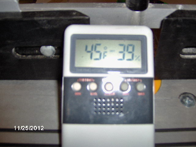

It was a bit cold in the loft, about 10 deg colder than the TB2 says is okay...hope it still works.
All laid out and ready to glue.
Guess I forgot to take a pic of the assemblies after glue and clamps.

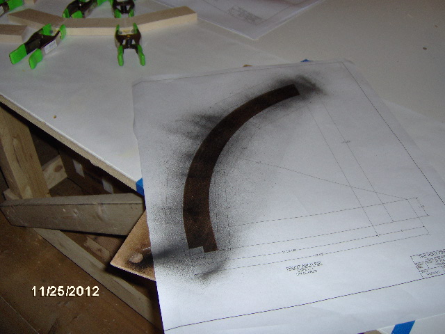

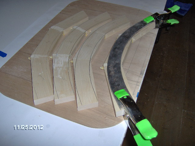

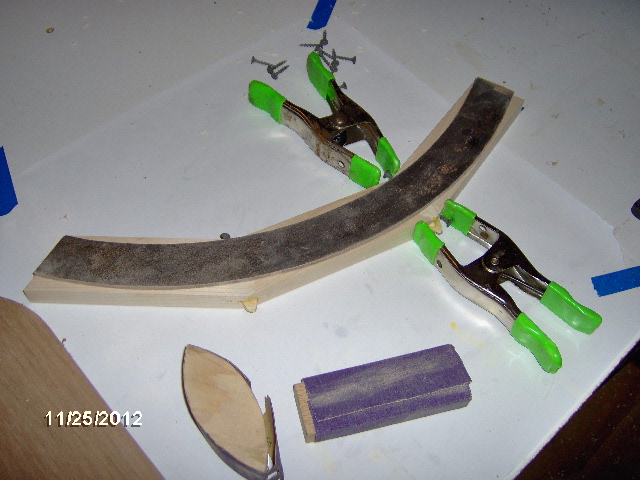

Then I switched to making a router template. At first I made another, longer circle template, and was going to make a fixture to hold the parts for routing, but after some layout I decided to do it the same way I did the hatch ribs. Used dad's panel saw to cut a piece of 3/16 underlay, cut out the full scale plan cleanly with a razor knife, spay adhesive to stick the plan onto the blank...
... and fogged it with some black paint for a more durable transfer.
Note the glued up riblet in the background.
Here is the template after peeling the paper off; running it through Karl's (or maybe it's Ben's?) antique, though highly functional wood band saw close to the line, then sanding with the small blocks, and finally laying it on one of the blanks to check fit.
It had been an hour or so after gluing the blanks, more than the 1/2 hour noted on the TB2 bottle, but not the 24 hrs. required for "loading". When I pulled the clamps and screws from the above rib blank, I dropped it on the floor and one of the joints popped clean off. So I had to scruff it with a little 100 grit, put the screws back in and re-glue it.
Here are all of the riblets after removing the clamps and screws.
And here I have fit the template to each piece and traced it with pencil to use as a guide for roughing out the blanks on the band saw before routing.
And that seemed to be a good stopping point, since I did not want to risk breaking the uncured glue joints by subjecting them to the vibrations of the band saw.
