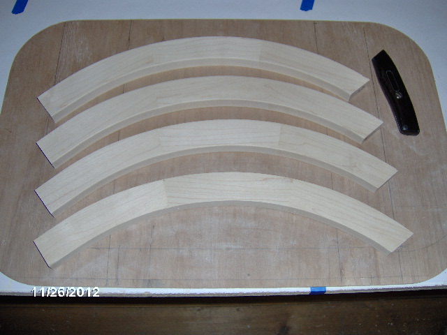

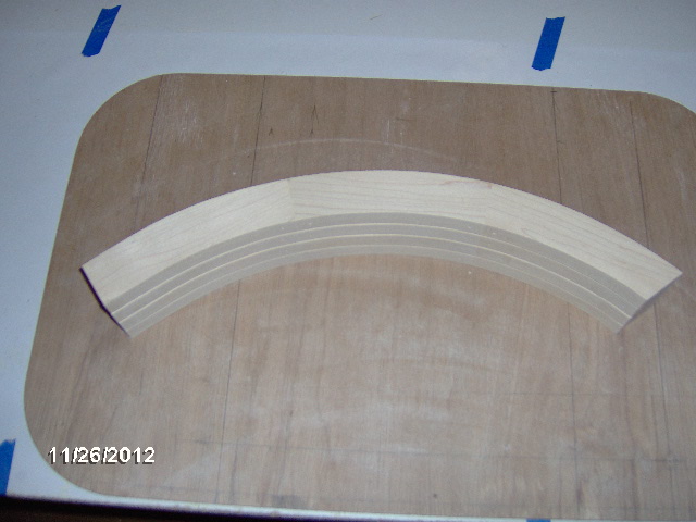

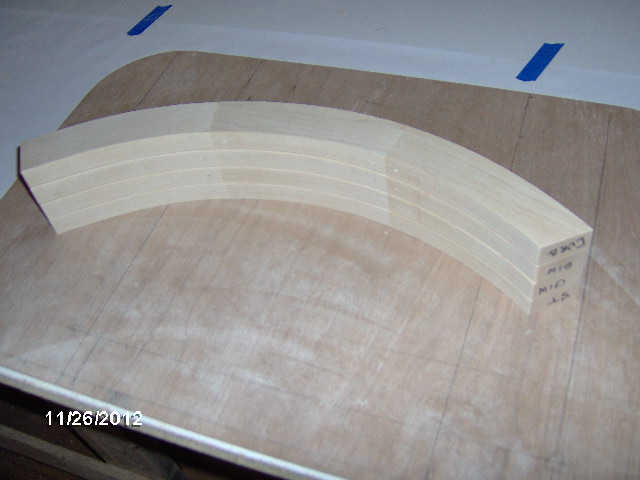

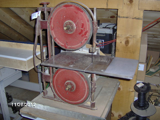

Tonight I continued making the "riblets", the ribs for the 13-1/2 inch radius at the front of the cabin. Here's a pic of Karl's antique band saw. Works great!
Rough cut all of the ribs.

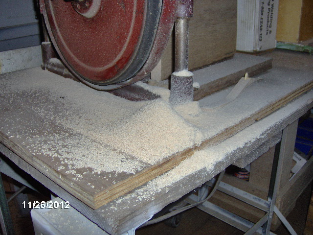

The first course on this evenings menu is a nice uniform grain of maple sawdust.

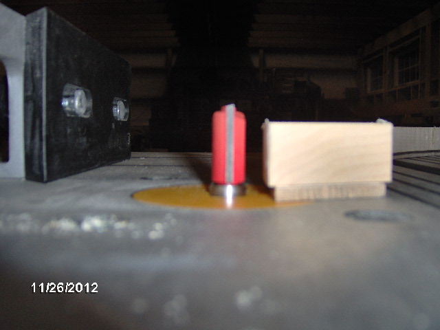

Then I fiddled around with another not so good router option before deciding that, because the part is small and narrow, the router table would be a better option. Here you can see the end of a rib with the template carpet taped underneath next to the top bearing flush cutting bit set in the table with the bearing adjusted to ride on the template.
Even though I made sure to make the cut in the climbing direction, near the leading edges of the first piece the cutter bit in due to the angle of the grain, tending to chip and grab the piece from my hands. I found that so long as I started in from the end where the grain was leading back into the curve of the part, I didn't have that problem. But I did have to reposition the template on to the other side of each part to complete the cut; with the rest now leading into the grain again.
For our second course, a nice big pile of fluffy maple shavings...oops, no pic (...but since I broke the cardinal rule and did not sweep up after myself, I will have another chance to take a pic).
After hand sanding the glue joints and pencil marks with the little oak block and the curvy block, getting the chatter and chip out fair, labeling them for orientation (curb, 2x mid, and street), and knocking off the appropriate inner edges a touch, here they are, substantially identical.
The utility knife is there for scale.
Just need to push a dab of filler into the little screw holes from the clamp set up, then later, when fitting them to the cabinet frame and ledger, I will make the notch and add Kregg pockets in the outer edges (where they will be hidden by the ceiling panel).

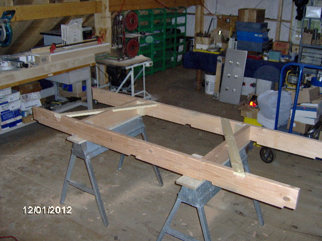

Okay. So the plan for Wednesday got interrupted by our washer machine going ka-put and me having to troubleshoot. No bueno. Going to lose another day and dinero to a service call.
This evening I swung by the ho-de-po and got a couple of 2x6 x 10's (and a few bundles of firing strips for Karl). The plan is to build a cradle to support the floor assembly on either saw horses, up off of the loft floor, or on casters during the cabin construction. I hadn't modeled this, so was "winging" it a bit. Imagine a ladder frame with two main stringers, a couple of xmbrs for blocking and several slats spanning across to spread out the support.
Once at Mecca and unloaded, I visited with Karl for a bit. He wanted to keep the stairway hatch closed to keep the wood stove heat downstairs, both for Simon overnight, and so that it holds some heat into tomorrow. The loft, being vented, would just shed this heat as waste. Anyway, after a very short time Karl was complaining how cold it was (about 35) and suggested that I hang a plastic sheet booth and place a heater inside (ding, ding, ding...light bulb going off). Said that he would never notice the difference in the electric bill, as it is so varied with all of the fab and equipment use, even though I offered to chip in if he notices a big change in power bill. Not sure if plastic sheet would be enough to make a difference.
Anyway, after showing him the lights, he beat feet back downstairs to stoke the stove while I started in pulling the kerfing jig apart to salvage the 1x6 pine boards. Ran them through the table saw to rip off the beveled edge.
Then ripped them in half and cross cut them in the miter saw to make a stack of slats.
Some of these will pick up the middle xmbrs embedded in the floor so that I can screw the cradle to the floor as if it were the trailer frame. Thus the cabin won't get shoved off accidentally, and the cradle can be used later as a rigging device to tip and lower the cabin down through the hatch in the loft floor.

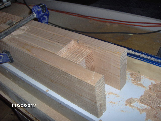

Then I turned my attention to the 2x6's. In hindsight I should have left them a bit longer, and maybe gone a bit wider, but I was trying to get by with the material at hand. Another key issue is to hold the cradle back from the edges so that it will not interfere with wrapping the canvas under the floor by a good 6 inches or so. Karl came and went a few times giving me a hand here and there, before succumbing to the cold and excusing himself back to the warmth of his couch.

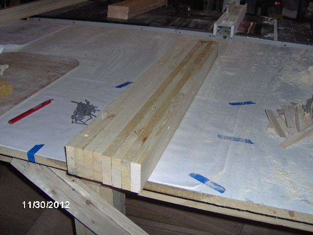

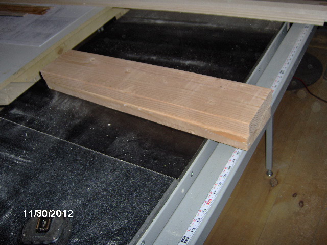

Cut 28 inches off of each 10 footer to act as blocking between the two stringers.
Then I cut the remaining sticks to the same length (one was 120-3/4 inches to start, and the other was 120-1/4...great QC work by the mill).

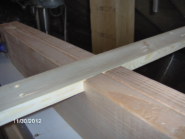

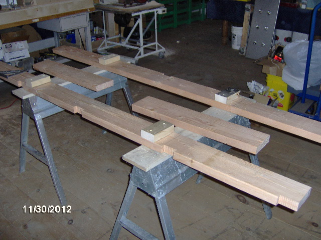

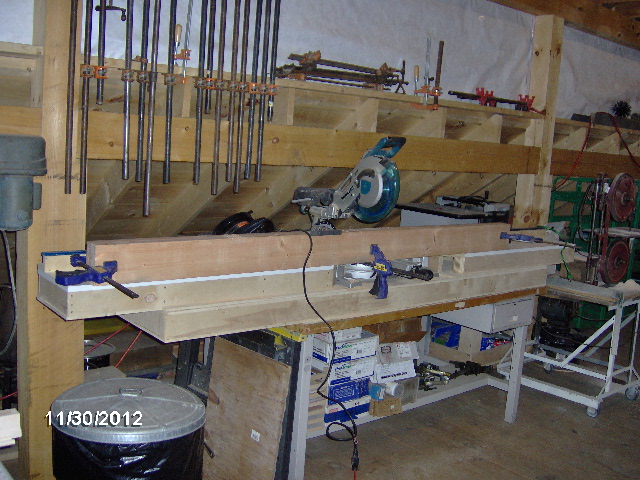

Next I sandwiched the two stringers together and laid out the notches for the slats, using the miter saw table as a work bench, only.

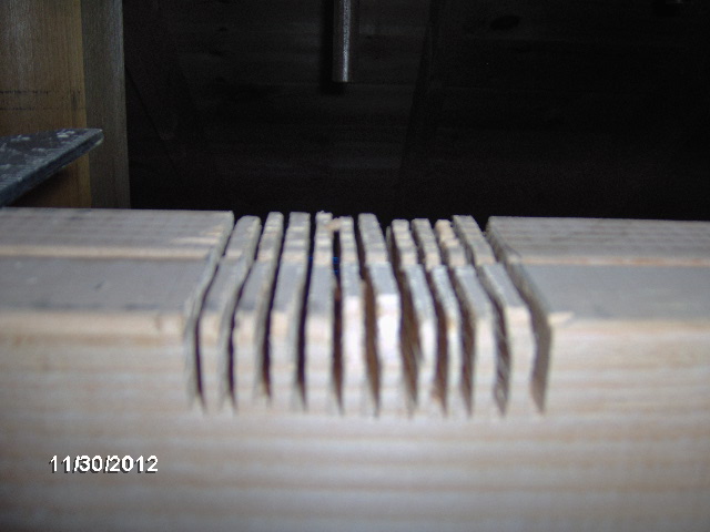

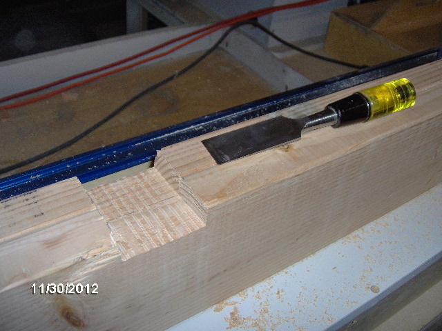

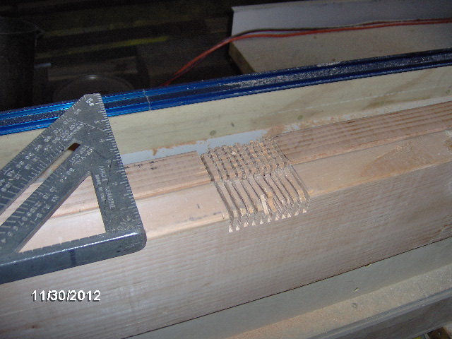

Used a quick square to guide the small panel saw (set to the thickness of the 1x slats) to kerf cut the notches.

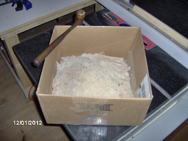

Then I used the metal button on the butt end of my chisel to knock out the kerfs, and then the chisel to just roughly knock down any gross high stuff.

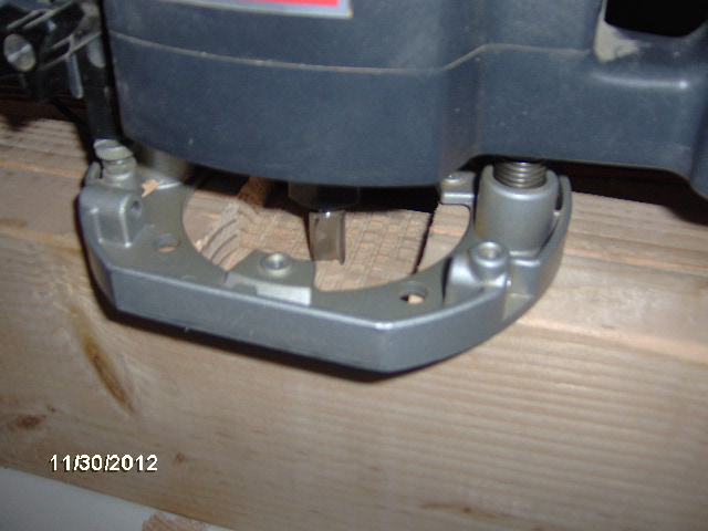

Next I set up the router and just sort of freehanded the notches to clean off the bottom to a uniform depth, knocking off the high spots that the rough chisel work did not get.
On the end notches I had to get creative so that the router would have something to ride on, so I just clamped the two blocking pieces along side to act as supports.

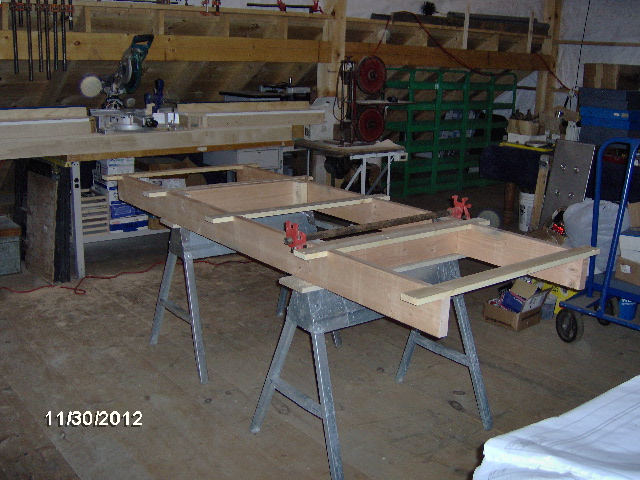

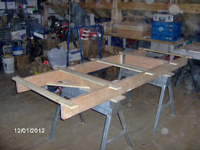

Checking the fit of the slats.

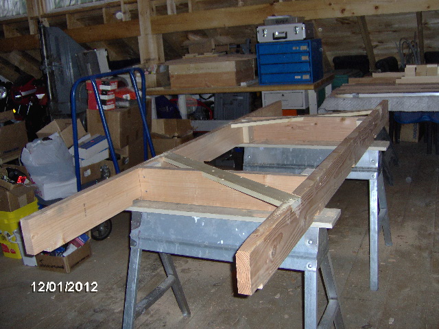

Next I cut and screwed some corner blocking on to the stringers where the xmbr blocking will go, rather than only relying on screws into the end grain.

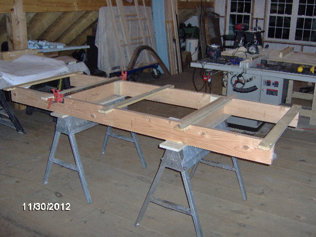

And here is the whole cradle frame mocked up in a dry fit before running out of deck screws and calling it a night.

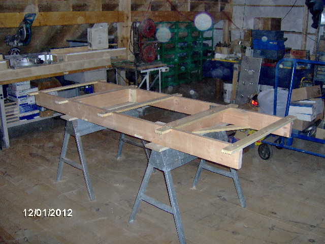

Okay, after running a bunch of errands this morning it was out to Mecca with my box of 2-1/2 inch coated deck screws in hand. I used some of Ben's pipe clamps to pull the stringers and xmbrs together, and some quick clamps to pull the xmbrs into the corner blocking, then screwed it off. Checked for square and decided to let in some more slats, on the diagonal, into the under side.
Then I flipped it back over right side up and screwed off the top slats.
Looks like it's time to clean the sawdust off of the camera lens again!
Then I laid out the bolt pattern for the four bolts, the ones that are in the middle of the floor, onto the
slats that straddle the center of the cradle and drilled those off.
Next I had a field day in the shop, putting away the random tools that I had left out, and sweeping up the accumulation of sawdust (I had been falling behind a bit in my cleanup efforts this week).
Pretty good box full.

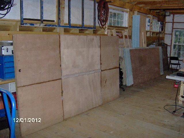

Next I brought the door assemblies up, then got Kris and Karl to help me bring the walls, floor, and remaining sheet of 5 mm ply up. Could not have maneuvered the stairs w/o their help, and the floor is a little awkward and heavy for just one person.
In this pic the walls and doors are behind the sheet of ply.
I was reminded of just how incredibly light the wall assemblies are, at least at this point with no coverings. Like a feather.

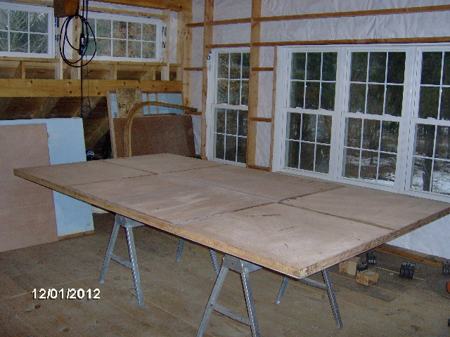

Next I got the cradle into position over the floor hatch (although turned 90 deg), made sure I had plenty of space all around, and toe screwed it into the boards on top of the sawhorses.
Next I got Karl's help again to set the floor up on the cradle bottom side up so that I can finish filling the staple indentations and make sure the seams are sealed up tight (maybe lay a few coats of the mixture on, if you guys think it will be compatible with the Bondo polyester filler, otherwise maybe a dilution of TB2.
