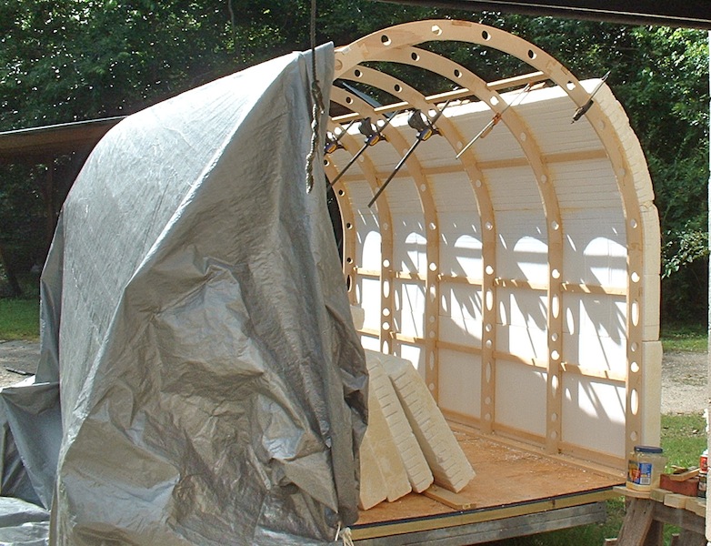

Looking at the progress you're making, you've definitely made a case for CNC cutting the wood.
Any guesses on what it would have cost if you didn't have a friend like Vinnie ?
In looking at your pics, does the back wall sit inside the side walls or does it project off the back of the deck ?

W2, I really have no idea of the rib cost other than the price of the plywood ... But I’ll ask Vinnie !!! It’s writing the program that was the time consuming bit ... the machine was pretty quick to cut things out , so "machine time" is not much .. I’d guess an hour or two ...
The back wall just adds on over the outside of the last rib ... Trying to keep it as simple as possible ... Have door framing to consider , just have to buy a door for the final measurements .... or make one .... but "You know who" wants a real door and a screen door too .... so a commercial RV door looks like the ticket ... :thinking: She’s buying it so no worries eh !!! ;)

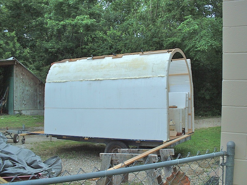

Got the top of panel 3 glued on ... You can see it’s clouding up ... :o

Wobbly Wheels wrote:In looking at your pics, does the back wall sit inside the side walls or does it project off the back of the deck ?
GPW wrote:The back wall just adds on over the outside of the last rib
:thinking: I kind of saw what WW saw in the previous pic, it doesn't look like there is much floor (plywood) behind that last rib in the pic's. But in this newer pic it looks like you are going to use that plank as a sill to fill in the back of the trailer frame and act like a threshhold... place to put your shoes if they get muddy, and a spot to land that back wall (maybe?). Looks like you are leaving plenty of side wall/roof foam overlapping that back rib to do that.

KC, Yes we have to do some framing on the back wall .... just waiting to get a door and frame up from there ... with the correct measurements ;) And yes the foam will hang off the back a little , but will be wrapped under with the skin ...the plan is to cut the existing foam flush and just add foam over the top of that ... (theoretically) :thinking: :roll:
Got the top of the last #3 panels glued up , just missed the rain ... :rainy:

Ps. you can see the last two kerfed panels inside , still have to hot wire an inch off the top of the thick one ... should go quick ...
