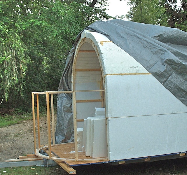

More Rain today .... already the day starts warm at 80F right now ... if things clear up for a little while , we can test fit the nose cage ...Maybe !!!
Re: FoamStream...
Postby GPW » Mon Jun 10, 2013 7:38 am

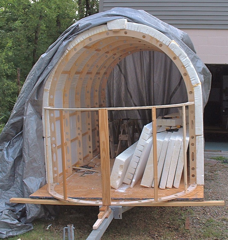

The Nose fits ... :thumbsup: Now I can trim the floor to fit and figure out how to support the nose ... :thinking:
Re: FoamStream...
Postby wagondude » Mon Jun 10, 2013 8:48 pm
That looks good. A simple block (maybe an inverted trapezoid) between the floor and the tongue should be sufficient.

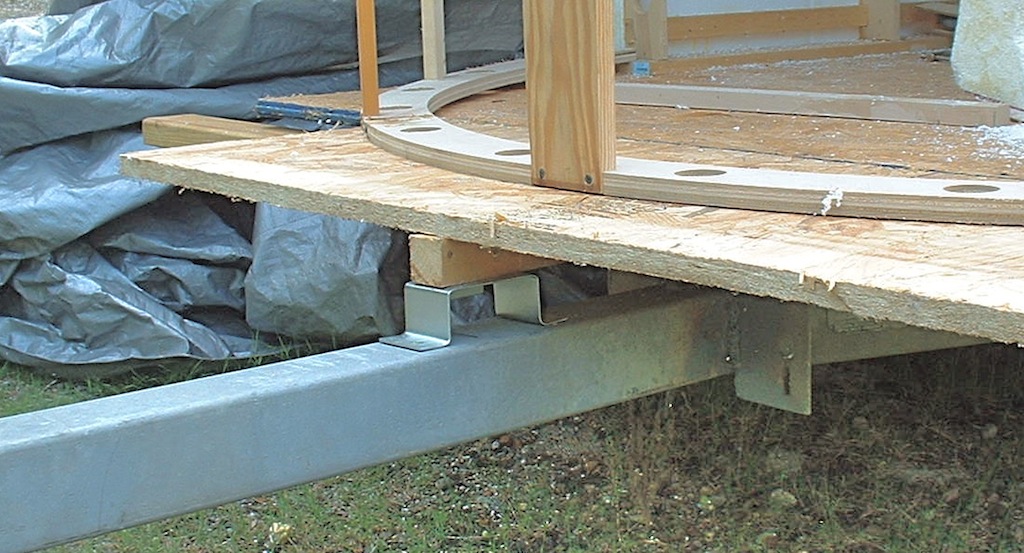

Have to get the nose floor sorted so we can attach the cage , kerf the foam (sideways this time) and get that part done ... Luckily I found a box of those left over Harbor Freight trailer clips , the ones that go on the sides to accept 2X4s like a stake bed... There’s my front attachment ... just have to drill a couple holes and attach it to the frame and floor ... I’ll take more pics as it proceeds ... Although I have a tendency to “over-build” in these areas, the floor is really Strong already as I’ve been climbing all over it all along (225#) ;) ...and that’s on the outer parts that will be trimmed away, so a little “float" won’t hurt a thing ... still very strong !!! :thinking:

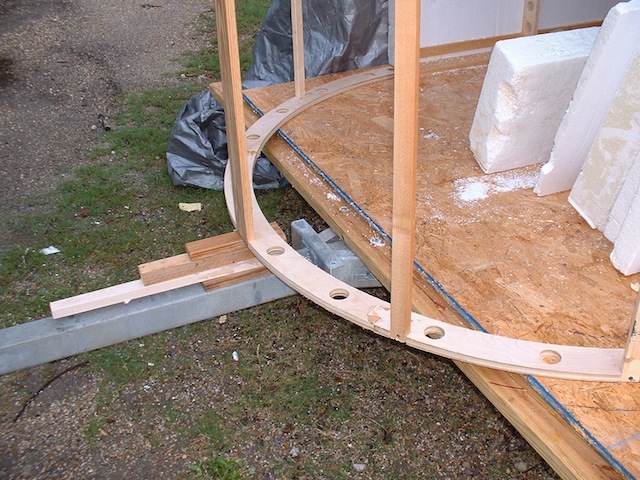

Here’s a quick mock up of the nose floor and HF clamp thingie' ...

Glen, that looks nice. I love the symmetry and neatness of the CNC parts. Trying to make that curve manually would have been a painful and slow process. I love it. :beer: :beer:

Glued together two pieces of scrap for the nose floor .. had to do some custom fitting to get the T&G to cooperate ... than I added the 3/4” spacer which will make it fit exact to the floor level .. Glue drying now ... Time for Lunch and perhaps a little siesta during the hottest part of the day ... :fan:
