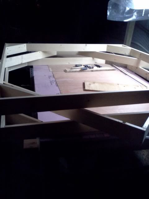

A little more progress today:
I got the seams in the panels sanded and taped and I got the formers done for the framework that will hold the sheets in position while I glass them.
Each of the three frames is 5' X 5' and will be standing up, screwed through the deck into the stringers in the box floor. They will be spaced four feet apart starting at the back so they'll support the back 8' of foam panels that make up the boxy part of the body. From there forward it's 2' for the door and then it runs forward into the nose cone so I'll have to come up with a separate bit of frame for that. This one will allow me to attach standoffs that will screw to the edges of the frame wherever I need them and attach pads that will hold the foam - as long as I remember to make sure that all the screws are accessible since I'll have to crawl inside the box to remove them and the frames. The front will still be open then so I can pull the frames out complete to use them as cold frames next spring (always thinkin'...)
Hopefully I'll get them up tomorrow or Friday because I want to start putting walls up this weekend. I'm going to miss not having a flatdeck trailer - it's come in handy a few times.

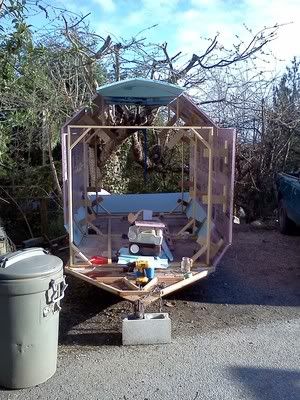

Postby Wobbly Wheels » Sun Mar 25, 2012 8:16 pm
As of today, my trailer has finally gone from a flat deck and some flat panels to a 3D shape.
I thought it apropos to go back and read my OP from June. Despite several pages of dithering on the shape, I'm back to a side-door, rear bed layout. It's done now and the only way is forward.
Reading back did give me an epiphany in terms of what I'm going to call this crate: Project Glacier.
Mostly because it accurately describes the speed of the build, but also because I am building what is essentially a giant rolling cooler perfect for keeping those frosty beverages glacier-cold.
Personally, I wouldn't believe it without pics, so here goes:
I clamped the door in place temporarily to show about where the finished inside height will be (~1" above) and to start working on how best to transition from the cambered side panels to the vertical door jamb.
This week, I'll be working on shaping this foam, then next weekend I'll be pick up the foam for the nose and get that into place...

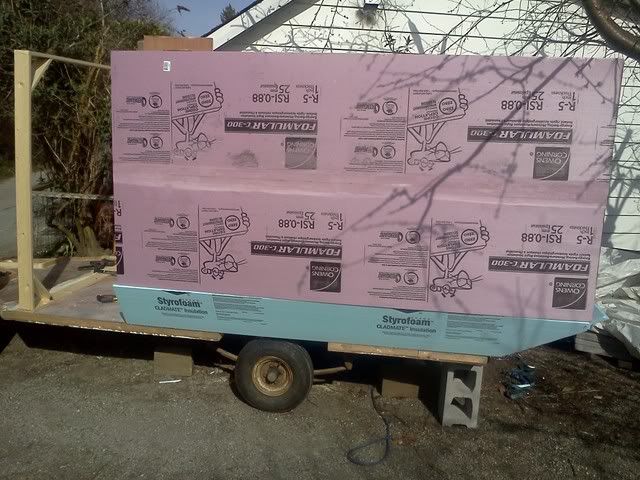

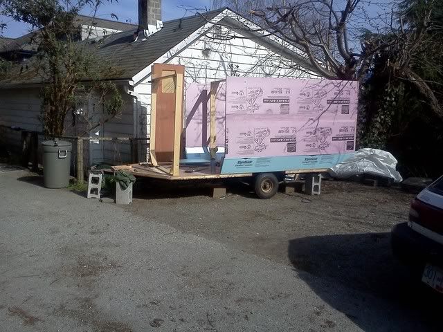

Postby Wobbly Wheels » Sun Apr 01, 2012 8:44 pm
Awright...Project Glacier is clipping right along.
The outside sheathing has been glued up and I've fabbed the center roof section:
Now that the exterior dimensions are set, I had Mrs. Wheels come out to assess the job and got a seal of approval so funding for the upcoming fiscal year has been justified...
