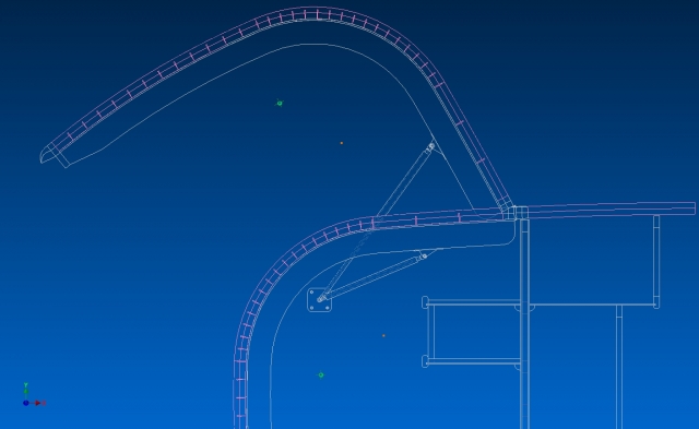

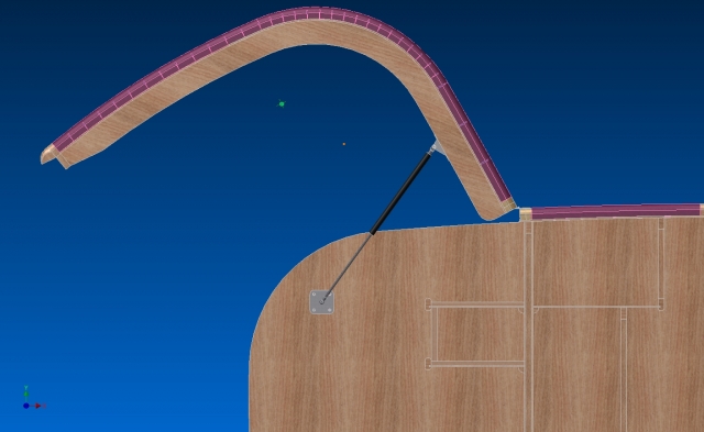

A little more design time on the hatch struts and I think it is pretty well defined now. Switched to the eyelet ends on top with the under slung brackets at the ribs, and fine-tuned the sketch for the anchor locations based on the slight differences in built up length and the actual bracket offset.
Here are a few screen shots showing a see threw composite with both open and closed superimposed, and shaded models with edges turned on of both closed and opened.
You can also see that I have detailed out the lower anchor plate. I’m still thinking about Bogo’s recommendation to use threaded inserts. At first I thought he meant to use these for the strut ball studs, and I didn’t think they would provide rigid enough support for that cantilevered load, but now I am thinking that they might be a good solution for screwing the wall plate to the wall, if only I can figure out a way to imbed them in the back of the imbedded wall blocking, and then find the holes again after skinning the interior wall. :thinking:
Maybe if I make the lower strut blocking full 2x through the whole wall thickness, then drill a small pilot hole through the threaded inserts and the inner ply from the outside that could work.
Still haven’t ruled out tying the lower blocks into the wall edging, but that looks like a lot of extra wood that might not be necessary (think airplane not tank).
I’ll lay out the new wall edging scheme tomorrow.
Still need to run the calculations for the strut load ratings and play with the FEA to see if they agree.

This High Strength Threaded Insert might be a better solution for the strut anchor plates.
I can glue the hard blocking into the foam; skin it; locate the anchor plate; template/transfer the hole locations; drill; install the inserts after the fact; and install the anchor plates.
Thanks Bogo for greasing the skids of my brain.
Seek and ye shall find a solution. :thumbsup:

If I may, here are a couple of thoughts to get you "over the hump." Regarding how to attach the strut brackets, I would not use threaded inserts. It's not that I'm averse to using them - I've used them in quite a few other woodworking projects and jigs for woodworking - but they're not really necessary. I have a rather long and heavy hatch and the brackets are sufficiently held in place by screws. (On my side wall bracket the screws are perpindicular to the plywood lamination. On my hatch bracket, the screws are parallel with the plywood laminations.) Plus, I think that the relatively close spacing of the inserts for the strut brackets could weaken the anchoring blocks.
Regarding the sidewall radii, I would use plywood if you have a way of matching the thickness. I can't say for marine plywood, but general 3/4" plywood is not 3/4". An option is 3/4" MDO plywood. It is true thickness with one or two MDO facings. Typical this plywood is used for exterior signage so weathering shouldn't be a big concern. If you have a template, I would rough cut the plywood to size, laminate the double thickness that you need (clamping the laminations to a true flat work surface), and then use the template and router to arrive at your desired profile.

Thanks for the tip on the thread inserts. I was just over thinking/over engineering that one, I'm sure. Precious is the voice of experience. I think I have a few chunks of the Red Grandis left over from the hatch ribs that should be large and hard enough to use for those wall blocks. Or I could probably come up with a chunk or two of oak, or maple; will use a hardwood there for sure.
