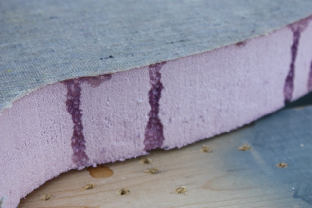

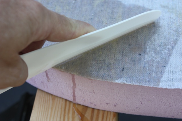

Mike, when you cut that foam with canvas/TB2, what type of blade did you use?
Just thinking about using saw I envisioned the threads being pulled out. Sort of like drilling through carpet, that just does not work.

Since I have a piece of canvas covered scrap, I figured I'd try putting some fiberglass resin on part of it to see if it hardens...
I notice that it's melting the foam!
:shock:
Postby GPW » Sun Jun 05, 2011 8:05 am
Well, at least you know the canvas will stick well .... :lol: Must be polyester resin huh ??? Epoxy won't melt it AFAIK...

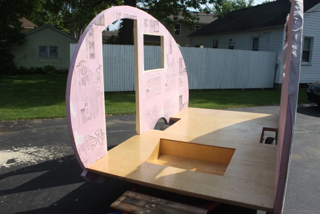

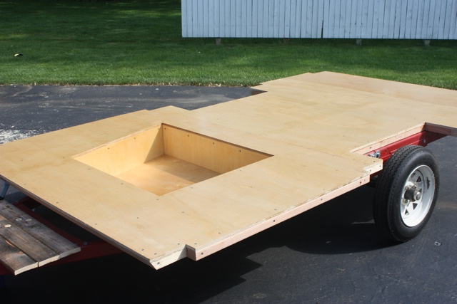

But the floor is coming along nicely... Here, you can see, the chassis and floor is almost done. Still have to do the wheel wells, and then flip it over and add reinforcements to the dropped floor. Then the black goo!

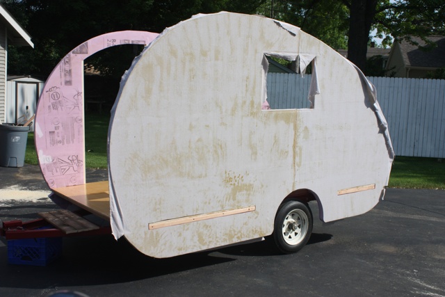

Just for fun, I dry fitted the walls again...
Here's an interior view...
And a profile view...

Postby Conedodger » Sun Jun 05, 2011 5:50 pm
Mick:
Are the walls more solid now you have the "Keys"?
Conedodger
Posts: 129
Joined: Thu May 12, 2011 2:24 pm
Location: United Kingdom
Postby mikeschn » Sun Jun 05, 2011 5:59 pm
Conedodger wrote:Mick:
Absolutely. The weight of the walls is resting on the floor, not on a few screws... :thumbsup:
Thanks for making me rethink the mounting...
