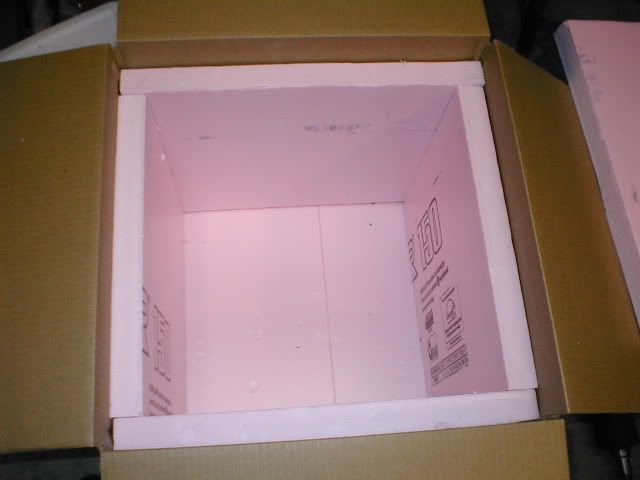

In Ohio it is easy to find pink foam at HD, blue at Lowes.
I use the pink for lining shipping containers for transmissions.
1.5" works perfectly.
