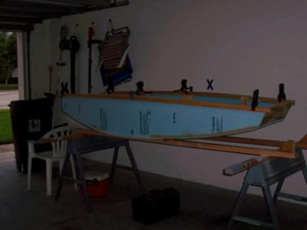

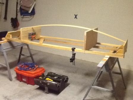

Started a Kayak foamey build yesterday. The boat is now 3-D. :thumbsup:

Will the ends be square punt style or foam 'pointy ends'?
Covering with canvas?

Punt style. The design is a Flats Rat boat. I am planning to add a mast and leeboard so I can have the option of paddling or sailing.
Have another boat but too heavy to bring along when we camp. I am hoping for a weight of 40 lbs or less.

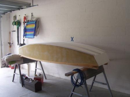

Postby clermont cubby » Thu Jul 25, 2013 11:59 am
Ran into to a problem with the foamey yak. Glued canvas to foam. Next Morning the sides held firm but the canvas on the bottom was bubbling. :frightened:
Went to lowes and found a sheet of 1/16" x 4'x8' pvc. Used loctite power grab to adhere pvc to canvas. Time will tell if it the right solution.
Larry

Postby clermont cubby » Thu Jul 25, 2013 3:22 pm
I used TB II. Picture below of my solution.
PVC cladding on bottom,bow and stern

Re: Foamey Yak
Postby GPW » Fri Jul 26, 2013 5:44 am
CC, that should really protect the bottom ... :thumbsup: 8)

I was pleased to be able to discover the pvc sheets. Was familar with FRP and used it as a ceiling material for our TD Cubby, but I believe the PVC will make a better cladding on the bottom. After building the hybrid foamey Puddle Duck sailboat last year, wanted to try a smaller lighter boat (single sailor) that could be easily transported on top of the teardrop.
Should have the boat painted and float tested next week. Later, install sail rigging. :applause:
Larry

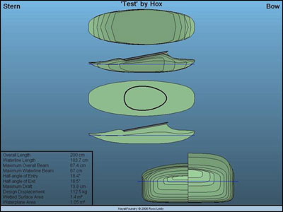

Postby tonyj » Fri Jul 26, 2013 9:38 pm
GPW wrote:You guys seen this ??? Since I can get 10’ blocks of foam ... :thinking:
It's a surf kayak.

Postby atahoekid » Sun Jul 28, 2013 11:13 am
Those "surf" kayaks are designed for whitewater and the like but are not very directionally stable. They are designed to be maneuvered. The paddleboard is meant to go straight and though you can certainly surf it, it is not meant for whitewater kayaking. Except for the facts that they are meant to float and designed for one, they are almost totally different watercraft. Hmmmm, back to the whitewater kayak. One billet, a bit of carving. How to keep the wall thickness even???? Will want a fairly rugged outside shell. You should expect to bounce off of rocks while doing whitewater kayaking.... Maybe selective reinforcement. :thinking: :thinking: :thinking:
