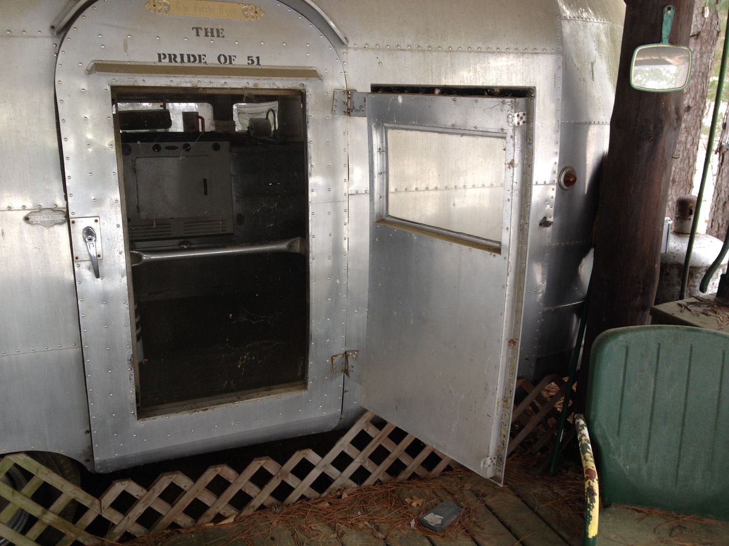

Now who doesn’t want a screen door .... ? Saw this in the GD , posted by Steve.... A door within a door .... It looks like this would be pretty doable on a foamie' , a little more complicated than a regular door ... but the idea of a screen door might be appreciated , camping in really Nice weather ... I need to make some drawings ... :thinking:
http://i6.photobucket.com/albums/y230/B ... 0f8fa6.jpg

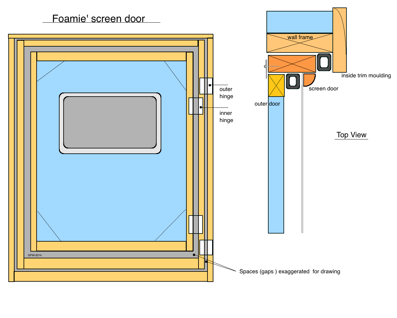

...and a sketch to just better visualize the idea ... :thinking:

I was thinking along the same lines when I saw Steve's post. The only thing I see with your drawing is the hinges might pose a problem. You need to use an offset hinge on the inner door section so the pins stay in alignment with the main door. Otherwise, you would not be able to open the main door while the screen is open (and presumably secured from flopping) without the doors binding.

Bill, our little RV trailer had a door within a door thingie’ .... I should have paid more attention to how it was made ... :duh:
