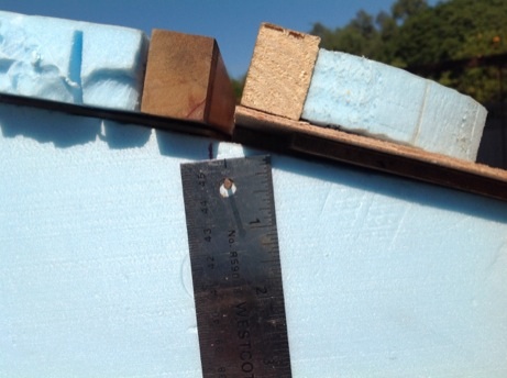

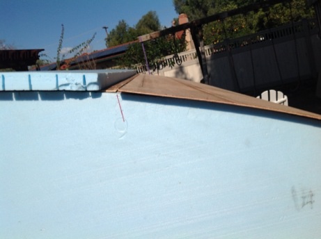

If you all don't mind. I would like a little feedback. How thick is the basic canvas paint layer? I need to allow for that I believe as I set up my galley. Right? Also if you have a look at the pic I'm wondering how much of a gap to allow for on the wall to boot lid. Does this make any sense?

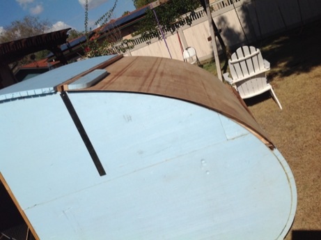

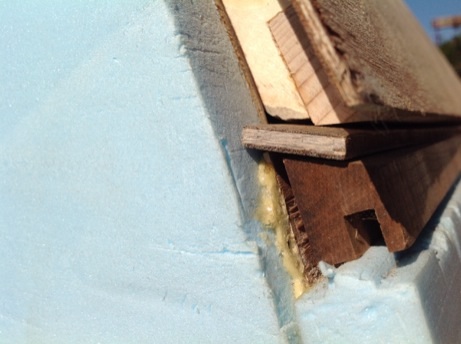

Postby RogHodge » Sat Feb 01, 2014 2:28 pm
Maybe these will help, or confuse the matter.

it will really depend on the canvas you use, your best bet would be to make up a sample with the paint and canvas you plan to use on a piece of foam, then after it dries cut it in half. you will be able to get the best idea that way.

Ditto that. The gap you need will depend on the weight of the canvas and how thickly you apply the paint. Wish there were a simpler answer than running a trial.

Well crud :NC
How about this...
How much gap do I want when it's finished? For gasket? Ballpark, cause I know you are going to say... "It depends on the gasket you plan to use..."
Feel free to tell me what to use

Postby atahoekid » Sat Feb 01, 2014 6:55 pm
Sorry I can't be of more help, but I have flat "cargo" style doors in the back so I never came up with that problem. I think Grant at Lil Bear sells the Hurricane Hinge and he should be able to tell you how much gap to leave. The Hurricane Hinge seems to be widely accepted as the best hinge for the hatch.

Postby RogHodge » Sat Feb 01, 2014 8:04 pm
I'm going with living plastic
Thanks though,
I'm thinking 3/8 should be sufficient

Postby GPW » Sat Feb 01, 2014 8:50 pm
Rog, I think I’d make the gap just maybe a eighth of an inch smaller than the gasket thickness...again , depending on the gasket material ... :thinking:

Postby rowerwet » Sat Feb 01, 2014 9:28 pm
my galley hinge is also live plastic, I don't have any gasket underneath it, the hinge is waterproof if installed correctly. (just don't goof like I did and cut the hinge shorter, leave it full length, if it sticks off the sides of the tear trim it flush to them but that is it, the hinge is a great gutter when the galley is open)
I made my hatch top flush with the galley wall/roof end then stuck the hinge on over it.

Postby Jst83 » Sun Feb 02, 2014 2:19 pm
My lid practicly touches the side and as foam compresses I figure very little space is really needed under the lip
