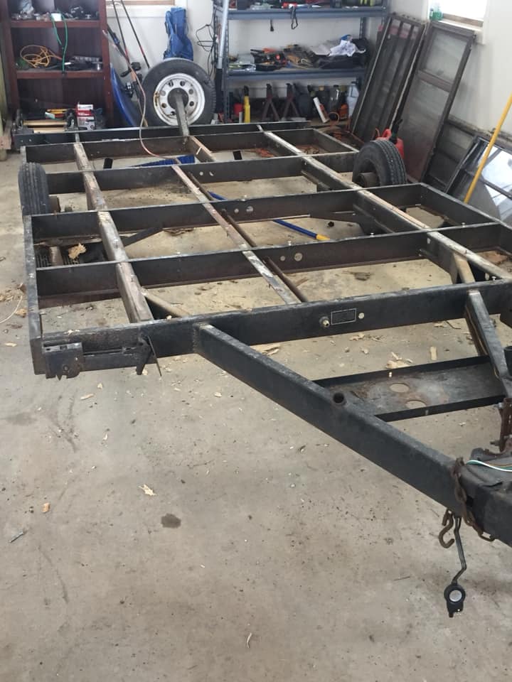

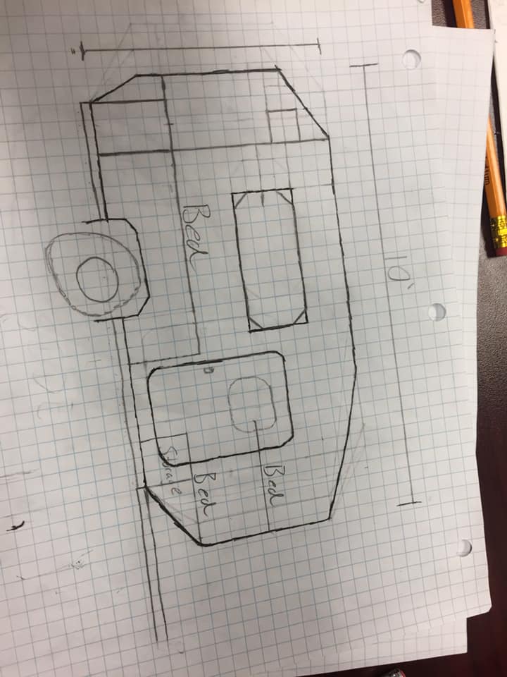

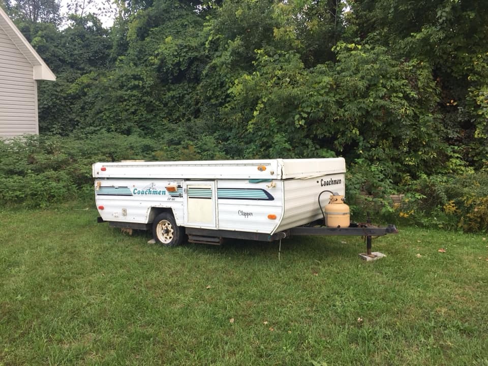

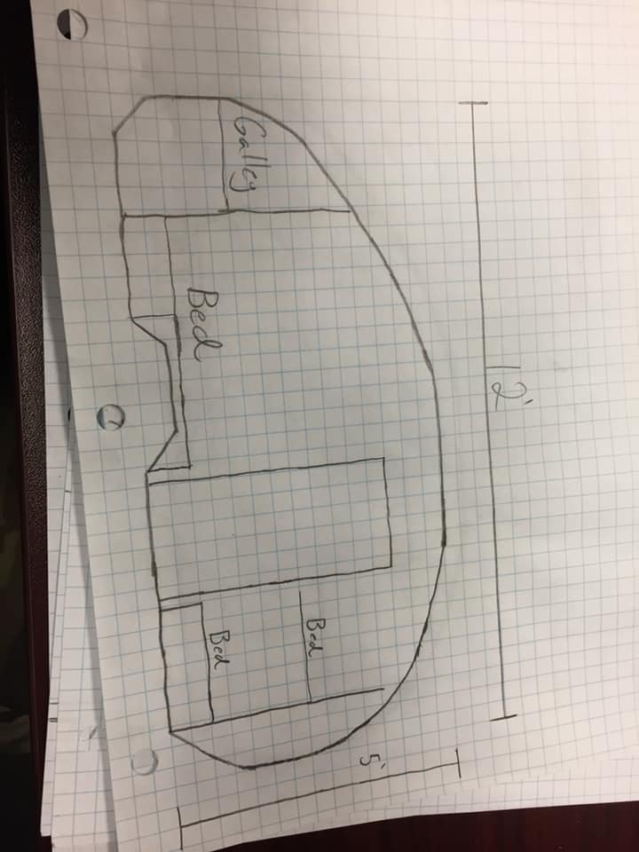

I'm building my first foamie. I'm trying to build it to fit my family of five. It is on a 6.5'x9.5' trailer with a bunk bed in the front, a trundle bed underneath the bottom bunk, full size dinette bed, and the galley in the rear. I was originally going to build a square drop, but since the trailer will be wider than my truck I decided to change that to a teardrop because I didn't want to pull a wall. Wish me luck.
What I started with
Decided to change the shape
New Plan.jpg (52.85 KiB) Viewed 4589 times
Original plan long before I bought the trailer.
Original Plan.jpg (62.22 KiB) Viewed 4589 times

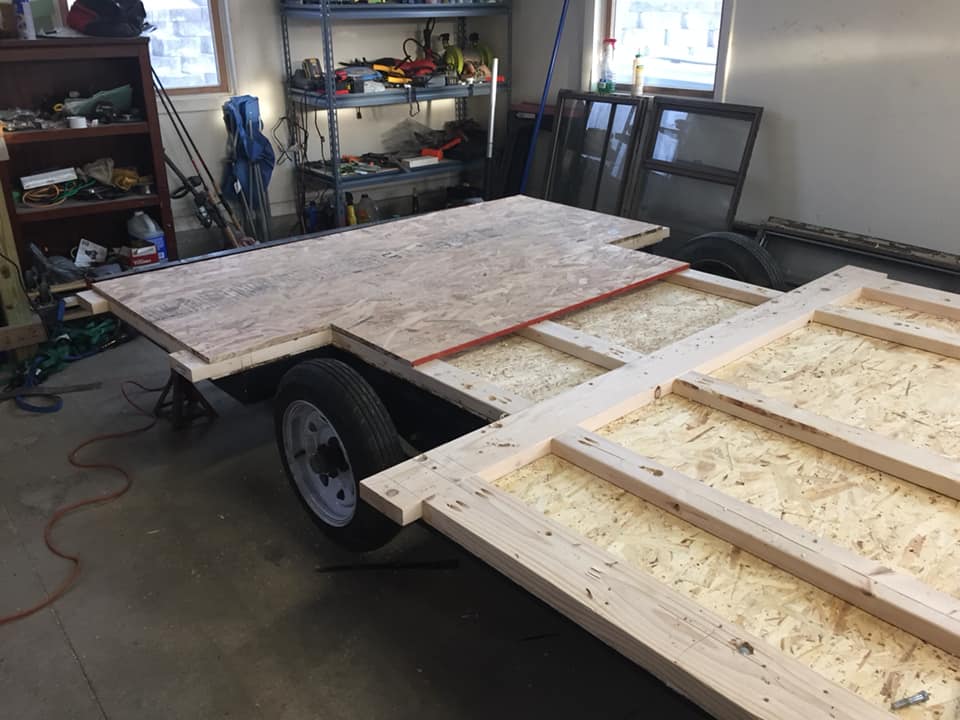

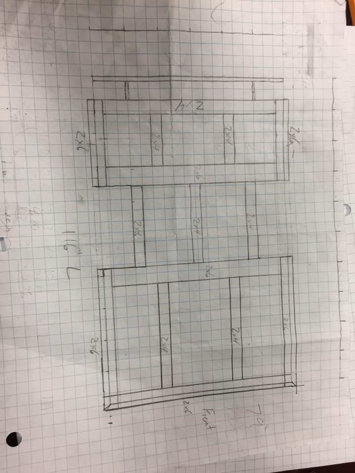

Making progress
I decided to use 1/4" OSB on the bottom of the trailer to hold the floor insulation in place

Postby stharding1836 » Wed Jan 16, 2019 12:32 pm

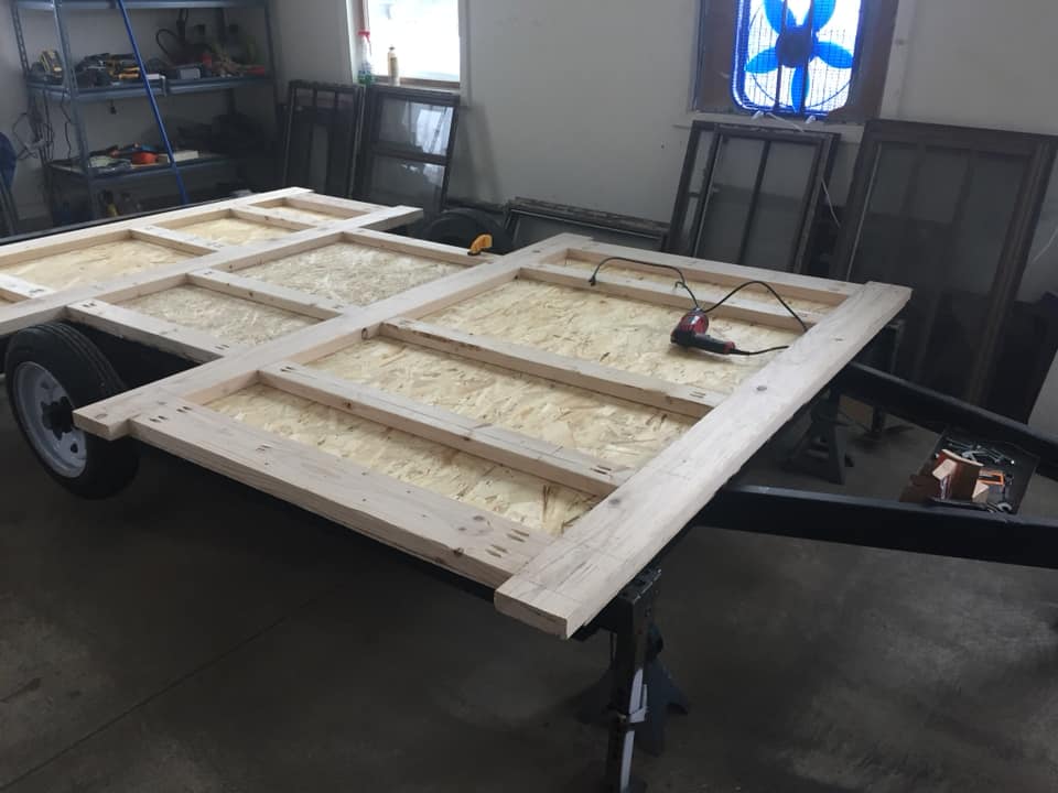

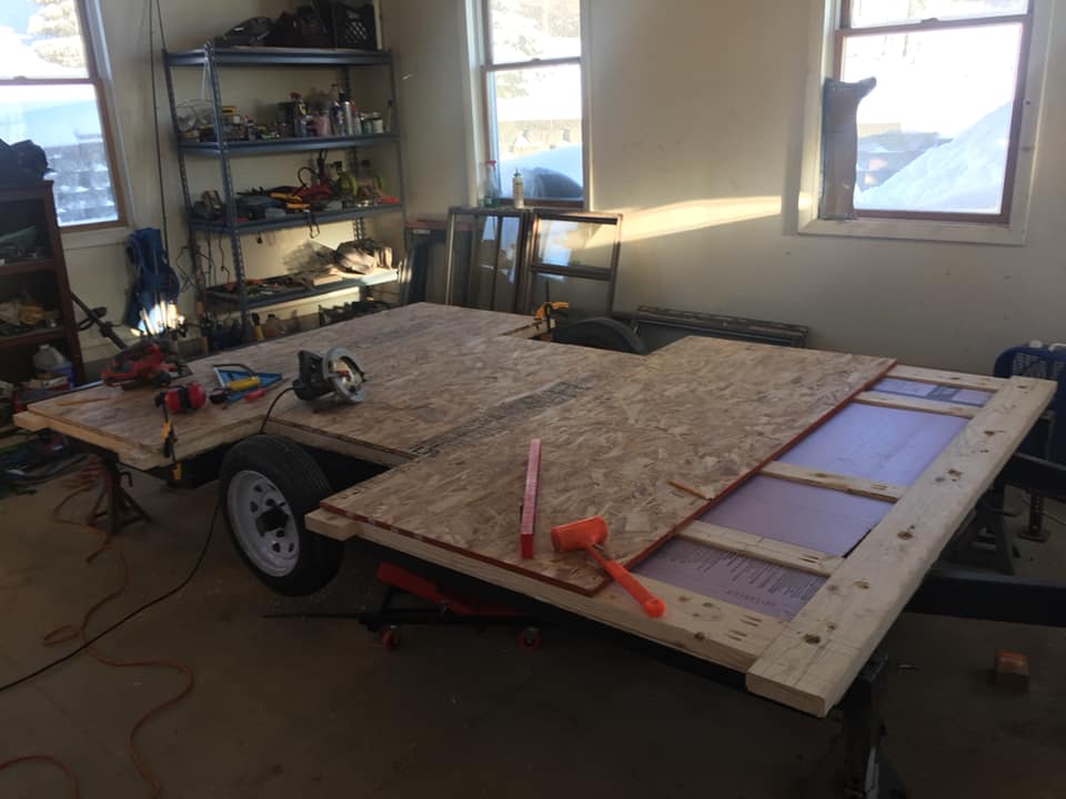

More progress
The actual floor will be 19/32" OSB that will be covered with a laminate
Partially Decked Floor.jpg (67.45 KiB) Viewed 4584 times

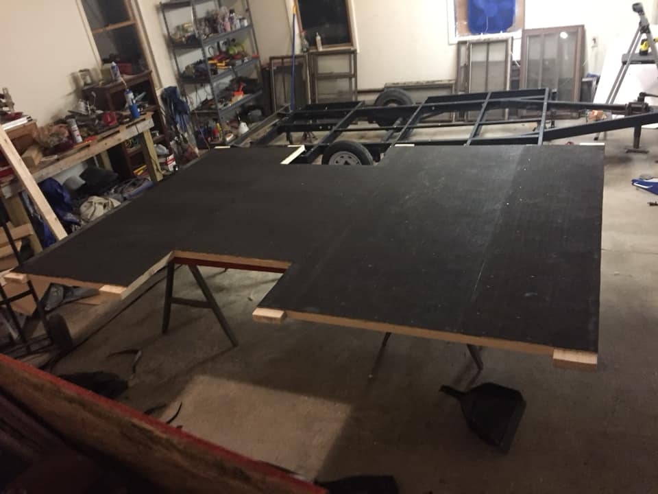

I sealed the bottom with a roll of water and ice
Sealed Floor.jpg (48.54 KiB) Viewed 4584 times

Water and Ice … ??? a “membrane" … ? :o
Re: My First Foamie
Postby stharding1836 » Thu Jan 17, 2019 6:23 am
GPW wrote:Water and Ice … ??? a “membrane" … ? :o
It’s a sticky tar paper for sealing the edge of a roof. I melted it to the trailer with a little hand torch.

Oh Cool !!! Never tried that before … Hmmmm??? :thinking: ( more testing !!!) ;)
Re: My First Foamie
Postby stharding1836 » Tue Jan 22, 2019 9:09 am
GPW wrote:Oh Cool !!! Never tried that before … Hmmmm??? :thinking: ( more testing !!!) ;)
I think it should do well, especially once the weather warms up and it really seals to the wood.

ST , I’d think it would be a Great idea to really soak that OSB floor with “the Mix “ to absolutely waterproof it … From our recent experience , the waterproofing can greatly increase the durability and longevity of the OSB flooring … We didn’t use it on ours ( forgot and was in a rush) and 5 years later we had to replace the floor entirely … Had we waterproofed it , it would have been fine …
And also we’d HIGHLY RECOMMEND using some "drip edges” all around to keep any repetitive moisture off your flooring … :thumbsup:
Ps … the Mix is 75% common Mineral Spirits , and 25% Polyurethane Varnish … well proven , well worth the effort. ;) Soak it in till it won’t take any more … once treated, a water drop will just sit on top and evaporate , never even wetting the OSB … We treat ALL our wood with it now . 8)

That's a good idea, thanks. :thumbsup:

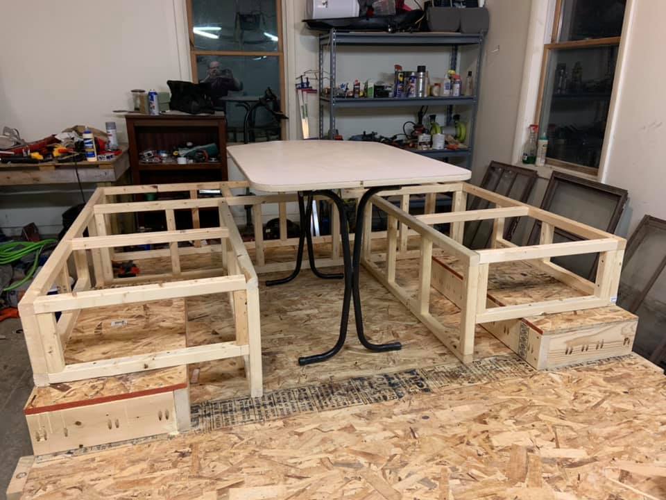

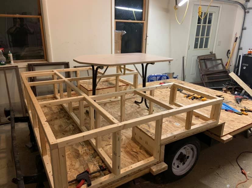

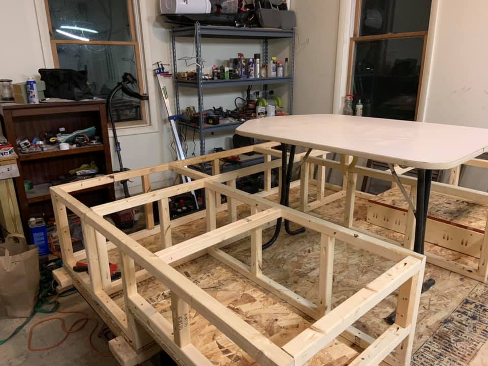

Postby stharding1836 » Wed Mar 27, 2019 7:31 am

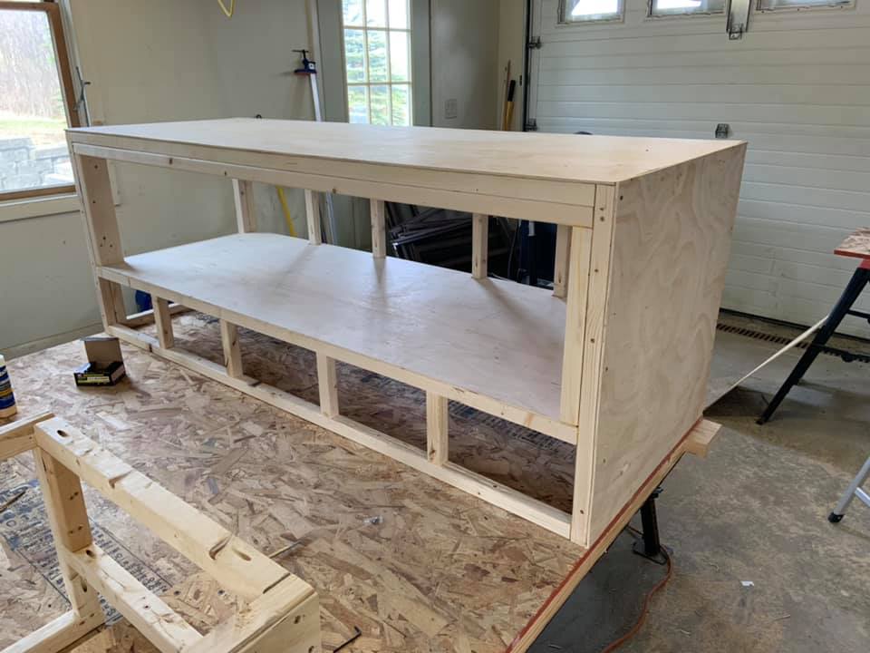

I finished framing the dinette/queen size bed. I've decided to nix the galley since this is my first build. My next build won't be for a family of five, so I'll put a galley in that one.
Dinnette 3.jpg (91.75 KiB) Viewed 4095 times
Dinnette 2.jpg (86.11 KiB) Viewed 4095 times
Dinnette 1.jpg (62.29 KiB) Viewed 4095 times

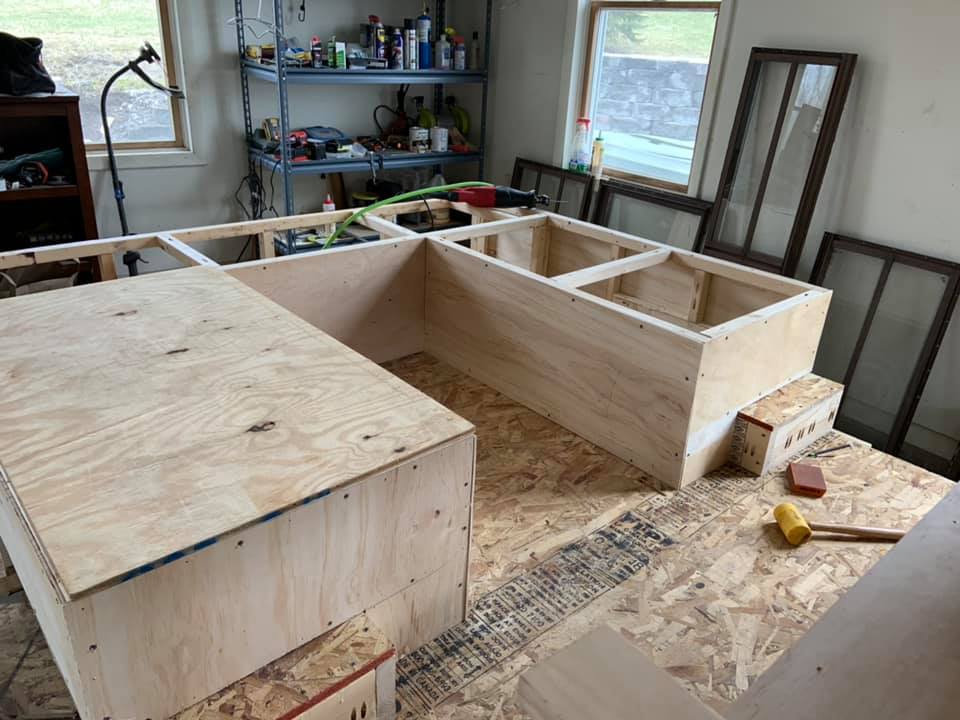

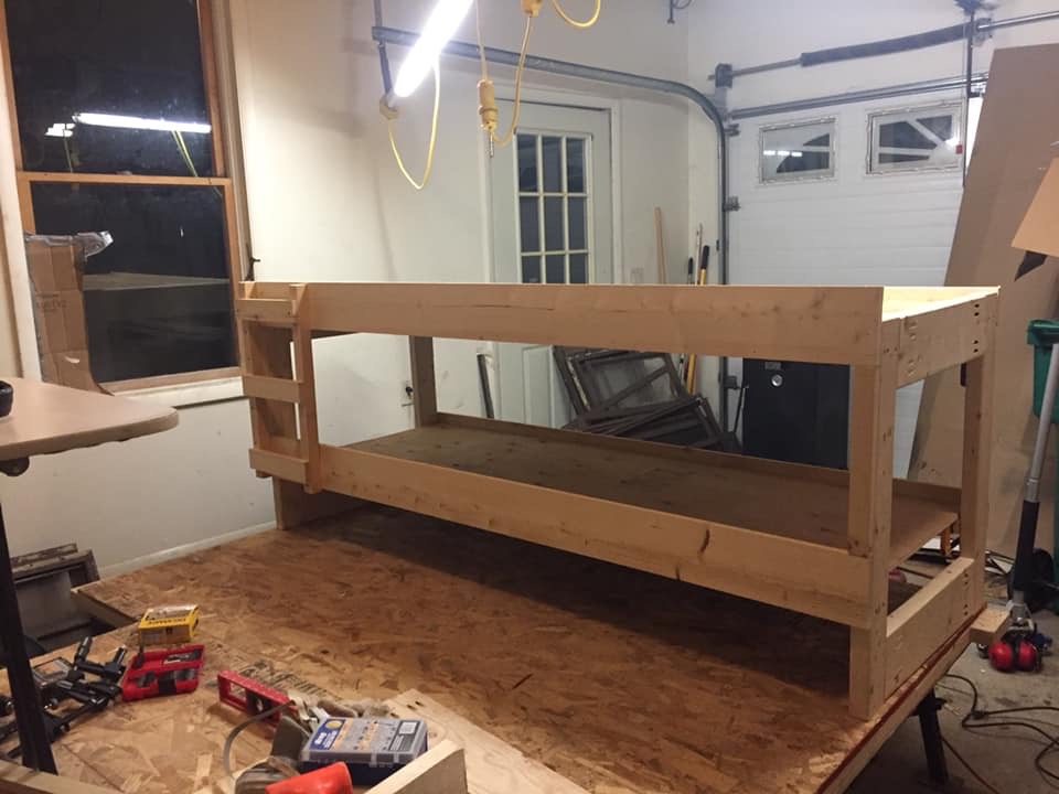

Postby stharding1836 » Thu Apr 11, 2019 8:23 am
Got some work done of the new bunk bed, and skinned the dinette.
