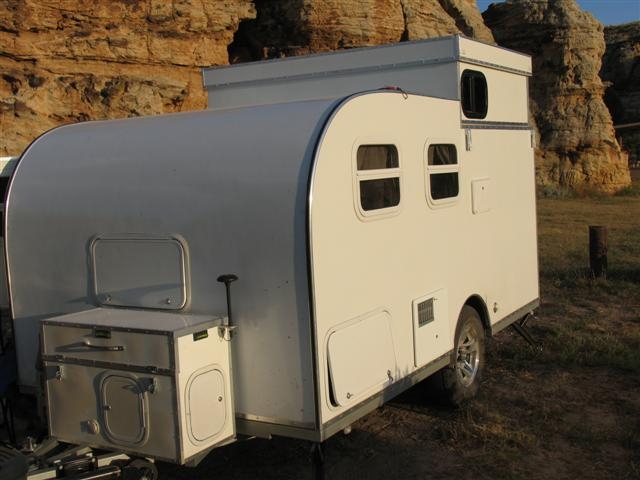

Pretty standard, I don't know anyone who hasn't floated their roof skin. My front wall is part of the roof and I wrapped the filon down to the frame:
