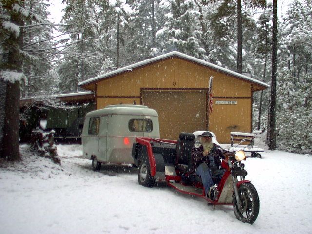

Postby triker45 » Sun Jan 24, 2010 7:00 pm
Pic test. My Puck and VW trike.
