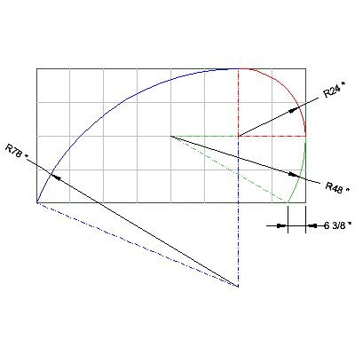

My guess is that circular/radial curves are used because they are easier to layout than elliptical or compound curves. My teardrop has all three types of curves. (The upper front quarter of my teardrop profile is the "Trailer For Two". The lower front quarter is flat/vertical with a lower 6" radius". The rear of my teardrop profile is a blend of the "Grumman" and "Cub" profiles.)

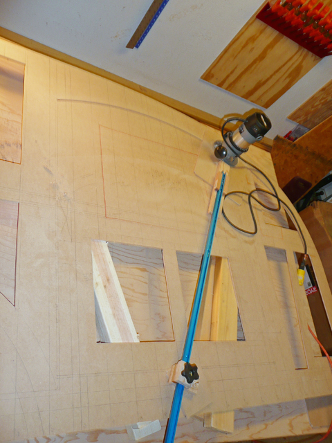

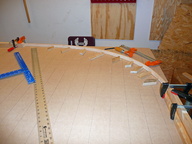

I used a template to cut my sidewalls. To layout the profile, I drew a three inch grid and plotted the approximate x-y coordinates. I then placed angled wood stops using double-sided tape at the "hard points" and stretched a wood batten around the hard points. This technique helps blend/transition the curves and lines so that profile was smooth and there were no breaks. (I believe the term is that the curves and lines are tangent.) It did take a few tries with the batten and rearranging some of the hard points to get everything as I wanted.
On a few of my circular/radial curves I used a router with a home-made trammel (compass) to cut arcs. However, the majority of curves were rough cut free-hand and then I used a belt sander to final cut to the layout line.

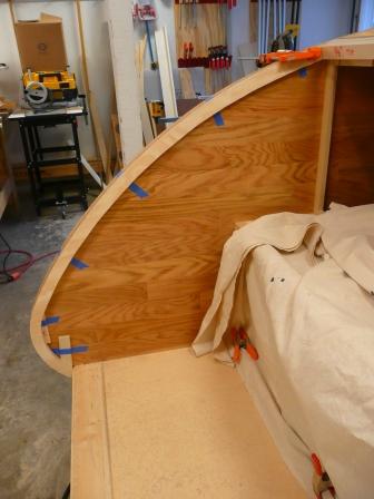

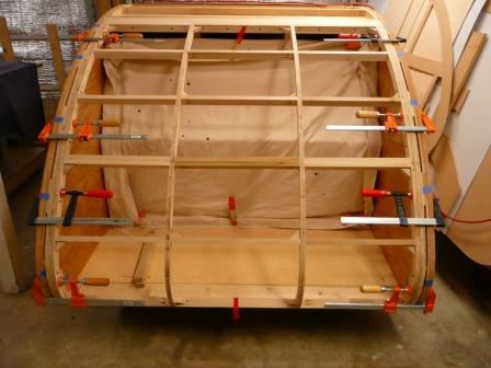

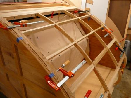

My hatch is a compound elliptical and radial curve. It is also longer (as are Grumman and Cub hatches) than most hatches. The lower rear radius of my hatch is 10". That was the most difficult part to "skin" with plywood.
As many others have said, it is best to frame your hatch in place. It will help greatly with maintaining the shape of the hatch and skinning it. If you do this method be sure you leave out part for the galley bulkhead so that you can remove the temporary fasteners to release the hatch.

I'm not sure what you mean by this. I don't have a picture of this but I made a jig to hold a pencil 1-1/2" inside of the profile line. I used this to layout the inner profile for the ceiling. (My spar depth is 1-1/2".)

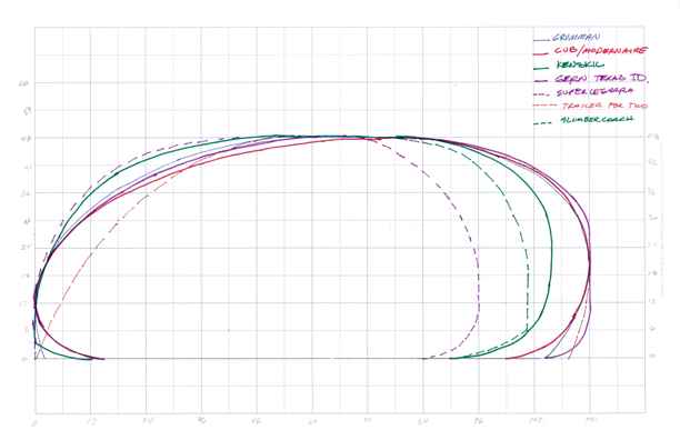

By the way, when I was trying to decide what profile to use, I overlaid several profiles. You can see this in the (very rough) sketch below:
The profiles are registered to the left side of the drawing (back of the teardrop). If there were profiles for the same design in 4' x 8' and 4' x 10' I used the larger. I had thought there would be greater differences but there were not.
Originally I was thinking about building the Cub/Modernaire profile; however, the extreme curves resulted in quite a loss of storage space. So I "Frankenstein-ed" several designs together to try to achieve a sleek profile but have usable storage space. This is what I ended up building.
To me, at least, the end result was attractive, and has been very functional.
