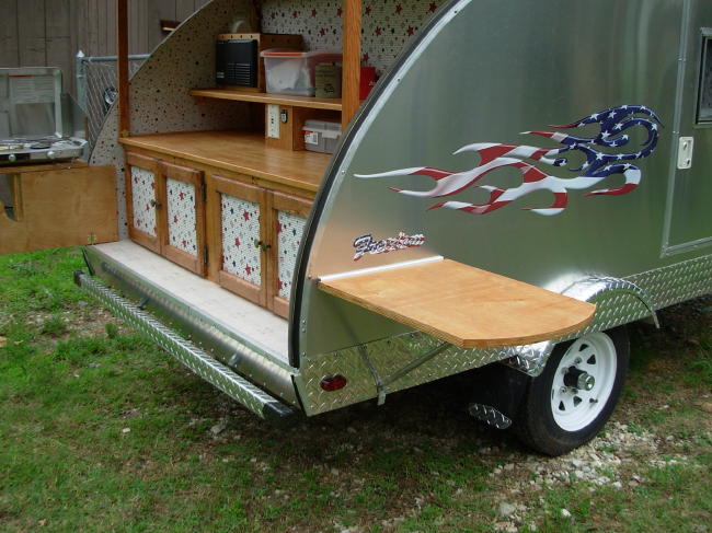

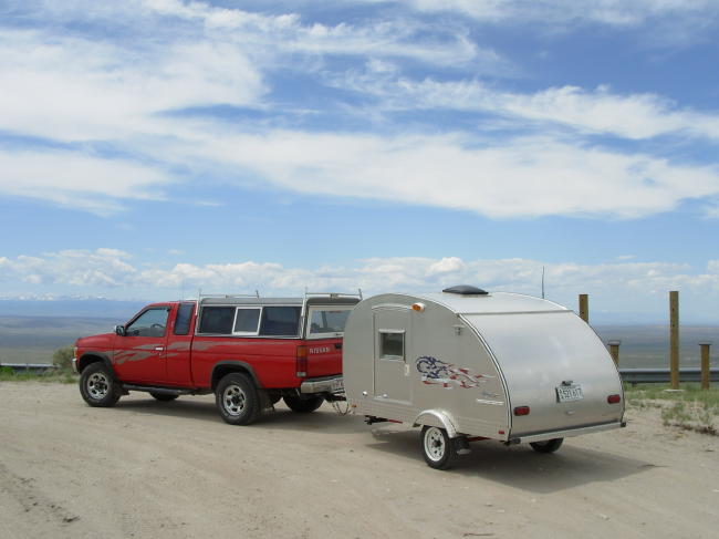

While my 'fenders' aren't as prominent as full size ones, they do add some 'bling' to the trailer. I built a 5x9'6" teardrop on an HF 4x8 trailer. Built over the wheels but the tires still extended slightly past the side walls & I didn't like the 'bare' look of the rig, tho I used it like that for the first few months after construction. Since I had the 'diamond tread' trim already on the cabin I ordered a heavy, aluminum diamond tread fender (for a 15" Jeep tire I think) from Northern Tool. It was wide enough I figured I could make 2 'mini-fenders' from one unit. Had to cut several inches off one end to make it fit my 12" wheels/tires. I then split it lengthwise using a metal cutting blade on my jigsaw, notched 1" of each 'inner' edge & formed a flange using a rubber mallet & a 'mold' of high density particle board. Drilled the flanges & attached to my TD using 1/4"x1" lag screws. Used the original 'cut-outs' from the diamond tread trim wheel wells as 'skirts' for the mini-fenders & fabricated some 'mud flaps' to dress it up a little. They may not be 'real' fenders but they look lots better than the bare wheel well cut-uts... We've towed it more'n 20K miles since modification with no problems or 'loosening' of the fenders.
one of our first trips (without fenders)
'On the road' (with fenders)

Thanks for the replies. Bobhenery you answered my question about weight. Now I will not worry about it. Harvey I like your idea. I will cut the fender in half. Your trailer looked great and I too think fenders add something to teardrops.
Thanks again ... Deborah
