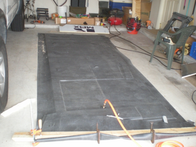

For an anticlimax, I also got the starboard wall glued and into the vac bag.
Wiring, then one more bagging left on this wall. Then on to the CNC.

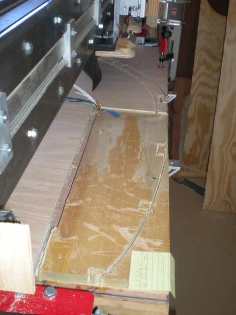

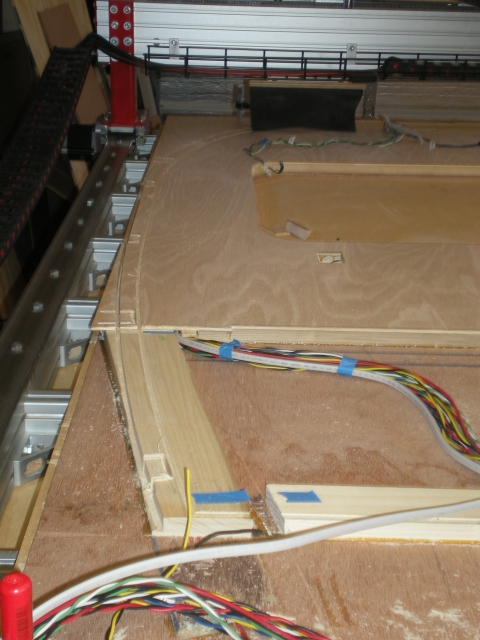

I'm making cuts into the framing under the interior ply all the way sown to the inside side of the outside ply. (Was that the least bit clear?) Just to be sure, I took the first rough cuts planned for the 1/2" cutter with the 1/4" cutter so extra meat would be left in case something went amiss. No problems. No video, either. Just the opposite af this morning. Keep reading.
Nose:
Roofline:

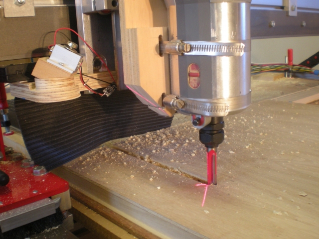

The CNC was down for maintenance yesterday. My Y axis kept drifting in the Y+ direction. I'll bet you don't have that problem. :laughter: I contacted CRP to see what they said. Make sure the motor set screws are tight. I just did that for the same problem, but what the heck, I'll try it again. The Y motor set screw's hex hole was munged up. I couldn't get an Allen wrench in it well enough to tighten it any more. Off to HD with setscrew in pocket to get a new one. So I'm trying to compare my set screw with the screws on their thread finder, and drop the d@#% thing, and it is lost down in the crack where all the washers & stuff fall. :fb Gone, never to be found again. :shock: Now I must come home with the right screw. So I made a couple of guesses, then stopped by the paint department to pick out a wood stain, then off to checkout. Luckily one of my guesses was right. I got that done and my Y axis worked fine this morning. I still can't figure out how it would drift only in the Y+ direction and not the minus. :thinking:

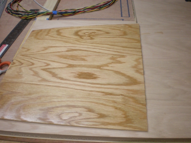

Had to try out my wood stain to see how it looks. Stained the end piece of the cabin cabinets. I like it. :thumbsup: The interior will get this and 2-3 coats of wipe-on polyurethane. Here's the stained wood next to unstained: :)

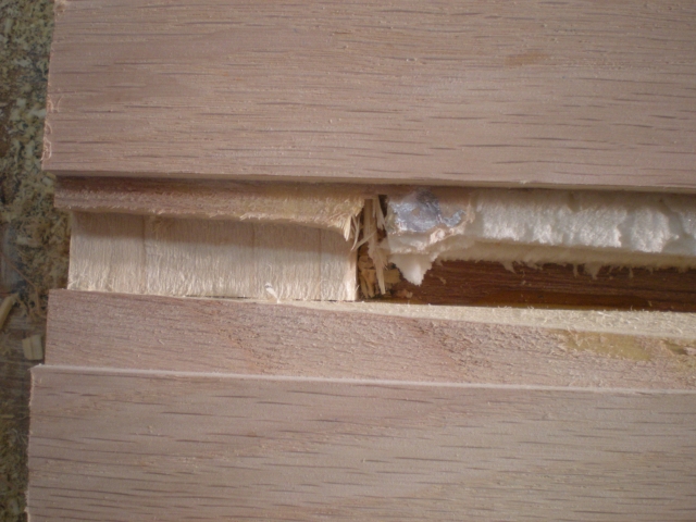

I managed to steer the router waaaaaaaay off course. :shock: :x :oops: :(

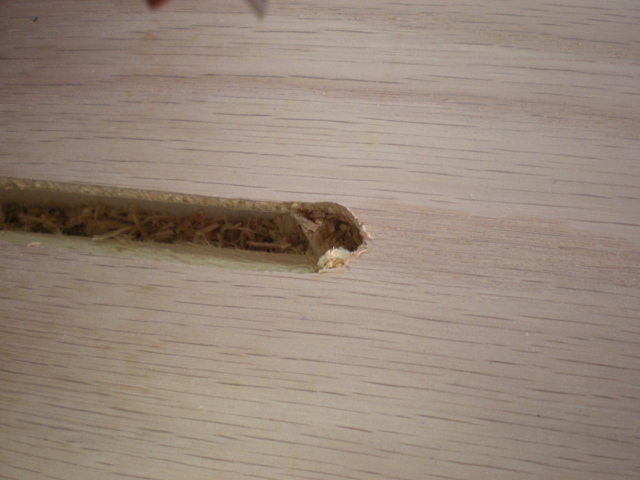

Another long story. I got the baseboard bottom rough cut and started on the cut for the aft bulkhead. These are the two most critical cuts of the whole project. If they aren't right on both walls, the Tear is going to look like my only tools were a dull hand saw and a rusty hammer. On my first rough cut for the aft bulkhead, the gantry was out of square and so was the cut. That won't do. :(
So I squared up the gantry, and I'm ready to make another cut. I want to pick up where I left off, so I position the tool where it needs to be and scroll to the line of G-code I want to run next. At this point, I need to digress for the sake of the non-CNC reader. :beerhat: To pick up and continue from a particular line of g-code, you first scroll to the line and then you have to push a button to tell the computer that's the next line. Ok, now even the non-CNC readers can guess that what's about to happen isn't going to be the desired result. From a tool position 3/8" below the bottom of the interior ply, the router takes off at full rapid for parts unknown. Based on the length of the gash, it took almost 3 seconds from stuff starting to go wrong to my recognizing bad stuff is happening to hitting the Emergency Stop button. You don't want me tailgating you in traffic. Ever.
Disaster Recovery
Here's a closer look at the carnage.:

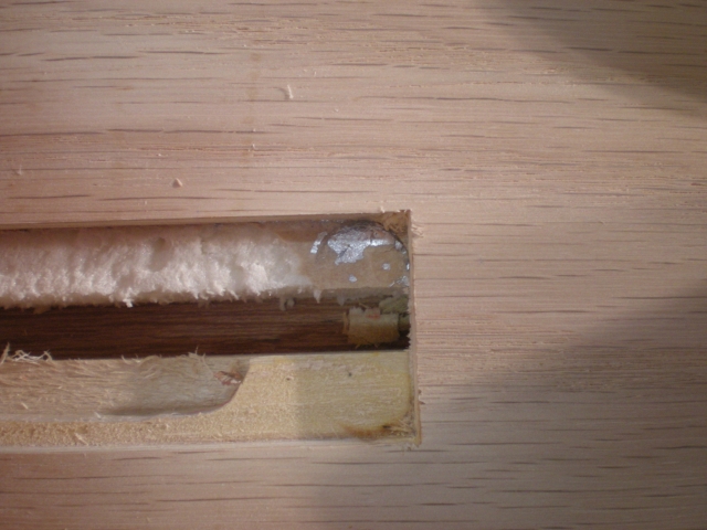

I started off by making a series of cuts to expose the baseboard and straighten out the gash, which was at an angle.
Did a little chisel work to square the corners on the one end. Note the round tool marks in the corners.
Dry fit a patch piece:
Just add glue and 220 grit:
It'll probably have a dark stain line around it, but it's down in the footwell, and I bet no one will ever know it's there. Except you, Dear Reader.
Stay tuned for more excitement.

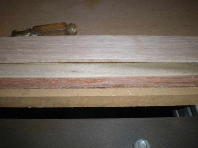

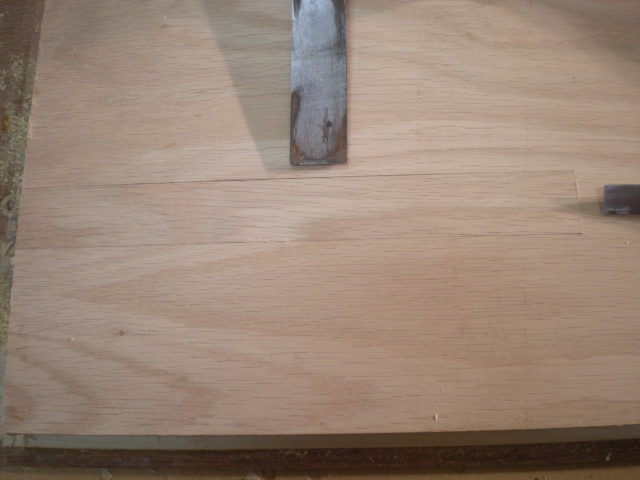

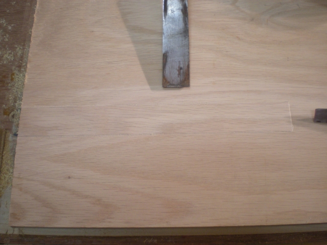

KCStudly wrote:Is the door warped up in the middle and down at the top and bottom?
Let's take a look at the pictures.
This one is taken from farther back, looking from the bottom edge of the wall. From the bottom of the pic: router's way (where the gantry goes back & forth), Darkness, the MDF spoil board, 1/4 marine ply with about 1/2 inch of surface exposed, poplar baseboard framing edge, glue line, 1/4 oak veneer interior ply. misc. tool, door opening.
Second pic:
from bottom: Darkness, router way, a little bit of baseboard framing, daylight, interior ply. The interior ply is bowed up from the framing, with little pillars of glue between it and the framing baseboard. The baseboard is basically straight, but the bowed ply causes it to bend upwards a little bit. To get the ply to lay flat, the compression of the ply must be relieved by cutting out a small section, and the glue between removed. This was caused by not having any support under the door opening while glueing the top layer in the vac bag.
The best way I can explain the Y drift is that if you start at Y=0, go do some stuff where Y gets changed, and you go back to Y=0, you actually end up at Y=0+something. The drifting to Y+ is intermittent, and it appears to be a configuration problem with the Mach3 software. :frustrated: :throw PC: I can change settings and make the problem worse or better, but how do I know when it's cured? :NC Rhetorical question. This stuff makes my head hurt. :hammerhead:
