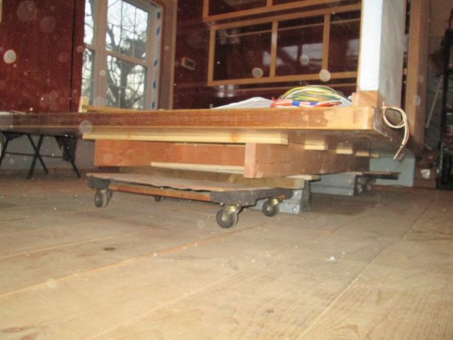

Karl had a pair of moving dollies. We shimmed them up with a 2x4 and some 1/2 inch ply which was just enough to lift the folded up sawhorses off of the floor.
Lifting each end of the cabin was not hard for one person (while the other slid the dolly under), but it was no cake walk holding it for more than a few seconds. I’ll try to weigh each end with the bathroom scale when we move it back.

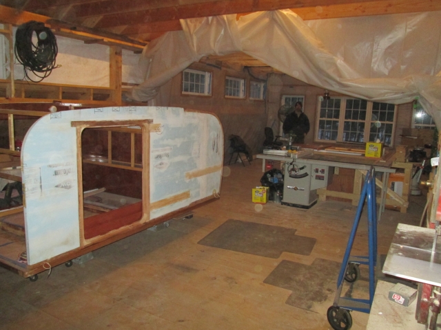

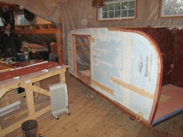

Here’s a shot during the move as we rounded the corner of the workbench.
You can bet I was a little concerned about gouging a big ole gash into the side of the wall on the table corner, but it all went easily with no drama.

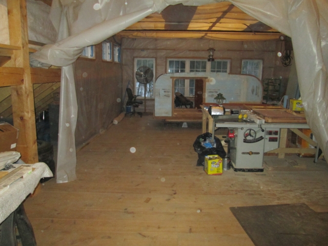

Looking out from the work area, somewhere in the haze of dust you can see TPCE in its temporary parking spot.
Looking back.

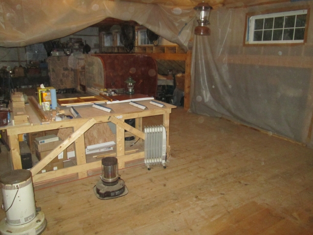

Karl and I both commented on how big the space was with the drape up and the camper off to one side. It really is a useful space if you don't fill it with too much stuff.

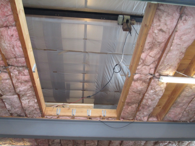

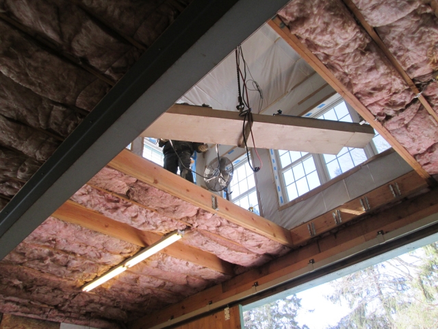

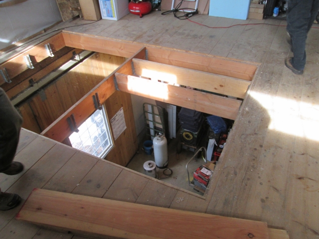

Here you can see that the floor planks, insulation bats and most of the floor girders have been removed from the joist hangers to open up the shipping hatch.

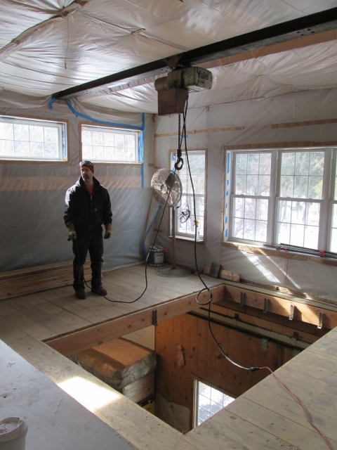

The last couple of girders and the center beam (joists) have been removed and the hoist has been plugged in and rolled over.

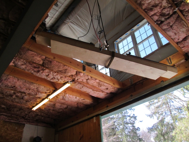

Mind the hole. Topside looking down… a long way down.
Ground level looking up.

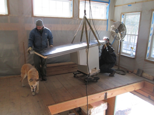

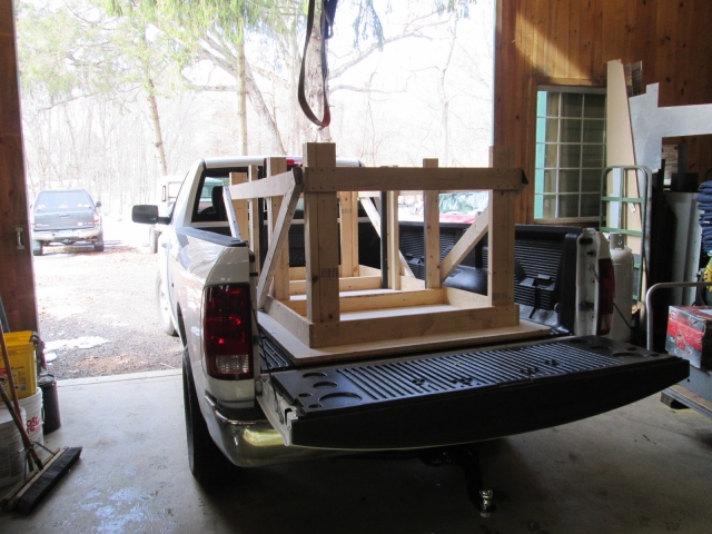

We flipped the work/out feed table over so that smaller items could be laid inside it more efficiently while in the back of Karl’s truck.
“Dropped it” right into the bed of the truck.
The miter fence goes. I pulled the truck out some and we slid it thru the legs of the overturned table.
Next we hooked Karl's UT up and put that under the hole.

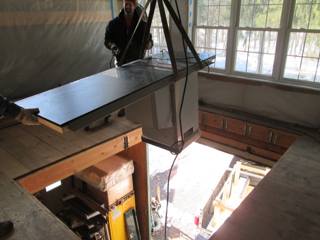

Then the table… :cry: … saw… :cry: :cry: went. :cry: :cry: :cry: The three of us just about couldn’t lift the granite topped saw to get it on to the dolly and over to the staging area next to the hole, so we took the outrigger legs off and tipped it to get the dolly under.
:cry:
:cry: (Don’t worry about Ben’s dog. She has lots of experience on work sites and was fully aware to mind the hole.)
:cry:
:cry:
:cry: Man I hate to see the saw go. That thing was a pure pleasure to use.

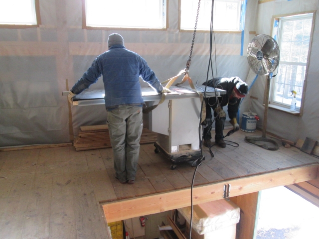

Looking down as I operate the hoist. Below, Ben unhooks the table that the miter fence sat on.

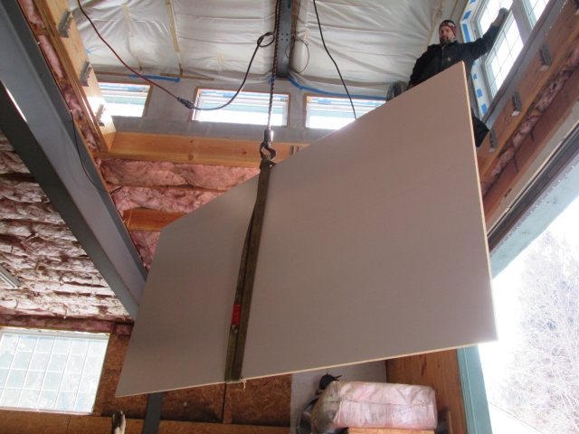

Last night after work I picked up a sheet of melamine and some lumber to build a new work bench. Here we are shipping the 49x97 inch sheet up.

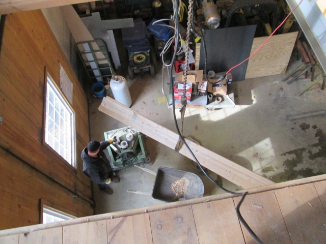

This rolls machine had been stored under the crawl space in the loft and Karl has a job coming up that he will need it for, so down it goes.

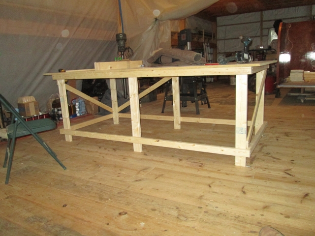

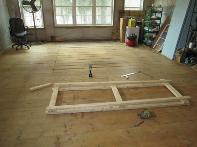

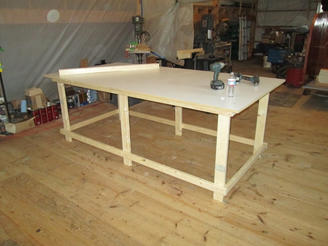

Karl was a great help feeding wood to me on the miter saw, and helping build the new bench. Here we have built one of the side frames (squaring the legs up, me pilot drilling and him impact driving the screws in; went fast that way), and are starting to align the second side frame parts on top to match.
Here is the new bench screwed to the floor with those cheesy little hardware store corner brackets, and the melamine screwed down to the top. I left 3 inches hanging over the frame all around for ease of clamping things down to the edge.
And finally, I fit and added some diagonal bracing on each end and across one bay at the back. This made the table rock solid, but doesn't block access too badly, so I should still be able to fit stuff under for storage
