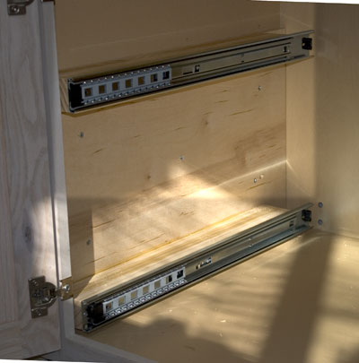

Postby oakinteriors1 » Tue Jul 01, 2014 7:29 pm
You want to stiffen up that pullout ..put another slide toward the top against the outer wall like the lower one...
like this...Image

Re: CNC Build -- Splicing the ceiling
Postby capnTelescope » Tue Jul 01, 2014 10:11 pm
oakinteriors1 wrote:You want to stiffen up that pullout ..put another slide toward the top against the outer wall like the lower one...
Great idea, OakInteriors! :thumbsup: I'm on it.
