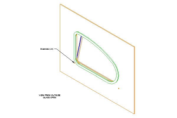

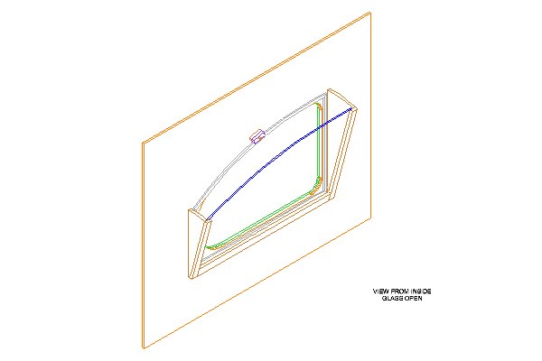

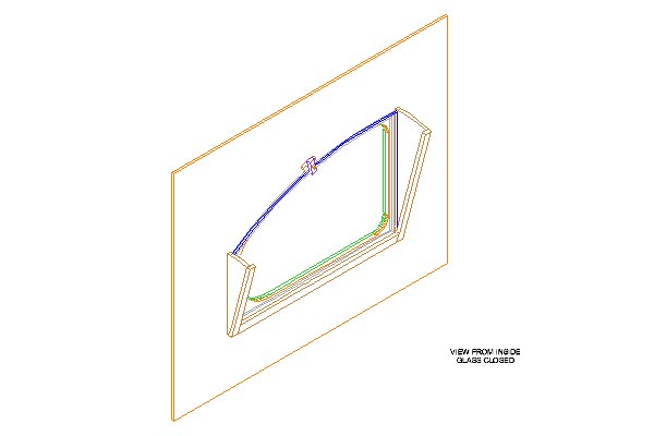

The wedge strikes me as something that will hold the window in the open position in a sailboat - but I can't see anyone wanting to hold the window open when towing, so I think a simple clip to hold the window closed is all that is required.
Hopper Window PDF

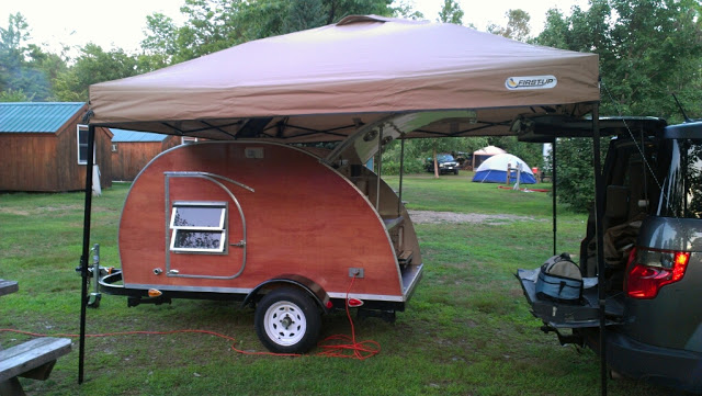

Postby starleen2 » Sat Aug 04, 2012 3:50 pm
LWW wrote:Again, go back and look at the pic in that thread. It's about the 3rd or 4th on in of the inside of the doors.Larry
Here it is:

Postby LWW » Sat Aug 04, 2012 6:48 pm
Thanks, I wish I could do that, make pics pop up like that. Those are right after I built my doors. I hadn't even sanded them down and put epoxy on them so you can see how they were built. I might add they work great too. Larry
