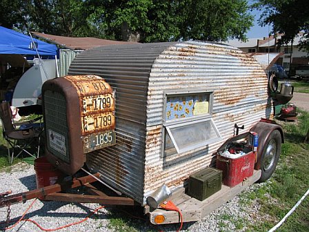

Postby bdosborn » Sun Dec 19, 2010 10:35 pm
My favorite galvanized tear:
There's an A/C behind that old radiator.
