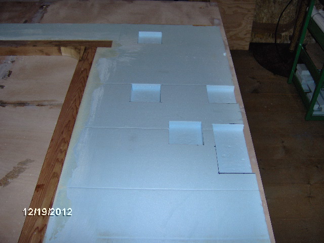

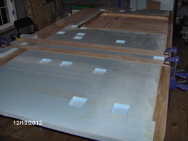

I made it out to the shop on Wednesday, and with Karl’s help manning the shop-vac nozzle, managed to get most of the street side interior wall blocking recesses cut out. Still made a big blue fluffy mess, but not too bad to clean up with the shop vac. Probably never get it all, though… little bits of blue in my clothes, in my ears, in my car…

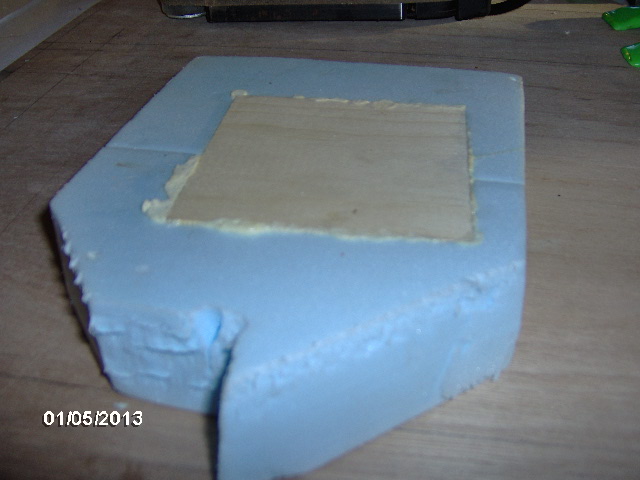

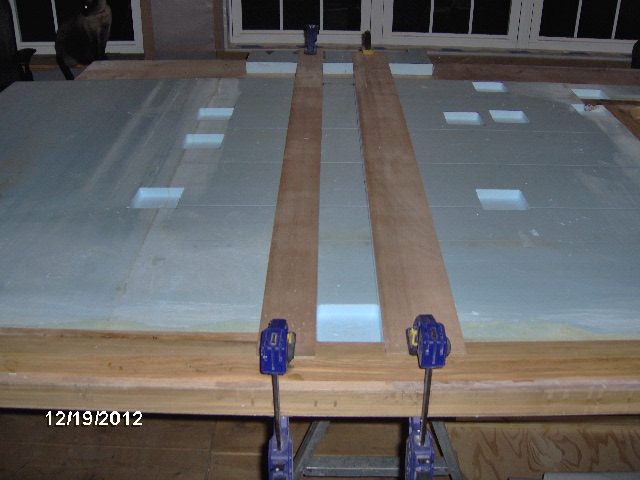

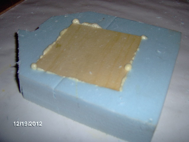

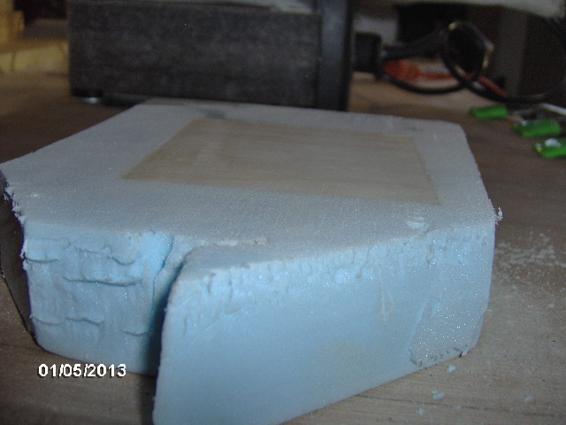

This is a test glue up using the piece of foam I used to check for depth of cut. I wanted to see whether the GG would force the blocking up past flush.
The recess is 3-1/2 x 3-1/2 x 3/4 deep which matches all of my “standard” blocks; select pine because it is relatively light and inexpensive. I know it is a little softer, so I will use the course Kregg screws to attach cabinets and such, and can inject glue in the screw holes to reinforce them at final install, after dry fitting.
Knowing that many of these blocks will be in the field of the wall, and will only be able to be weighed down while gluing, for the test I just clamped the block down softly near the edge of the bench. The quick clamp only reached just inside of one edge of the block and because it was only clamped softly the GG was able to force the far edge of the block up above flush by at least 1/16 inch. I’ll have to double-side tape it to the bench and do a test with the belt sander to see if I can make it flush without too much drama or distress to the surrounding foam. I don’t think the uneven expansion will be such a big deal with adequate and even weighting, but I may do another test or two, one with GG and weight, and another with TB2 which won’t expand at all. According to the reports on the forum TB2 between foam and wood works fine because the wood can absorb the moisture, right?
Here is the front section up by the head of the bed.
The two upper recesses closest to the door frame are for the front cabinet face frame; the upper one will actually be cut away slightly by the curve of the ceiling profile. The top of the cabinet frame rail will have to be shaved to match the arch. the corresponding recess at the front wall is for the ledger to support the "back" of the cabinet floor at the front of camper. The lower middle one is for the front of the key catcher shelf. The double recess handles the "rear" of the key catcher (front of camper) with the reading/courtesy light and switch below.
Here you can see the bigger picture with the front of the wall farthest away and bottom of wall to the right (in case it wasn’t obvious wink ;) ).
The hole above the back edge of the door frame header is for the dome light on that side. Below that, under the tail end of the door header is for a coat hook. The two pair to the rear of those are for the rear upper and lower cabinet face frames.
You can see where I have started to temporarily attach some scrap 5mm ply to guide the router for the bulkhead blocking recess. Before that I used the small square template to cut a starter hole at the bottom. That gave me the accuracy to nestle into the corner of the bottom stringer and the extra reinforcement strip for the galley drawer/ice chest tray glides. After setting the router up on the guide strips I quickly realized that they are too far apart and the router shoe will drop off on one side before reaching the other; so I will reposition the front one closer, make a first cut, space off of the rear strip to place the front strip in its final position, move the rear strip forward to suit the router shoe, and complete the cut in a second pass (another time).
After that, the two recesses on the left are for the two upper galley shelves, while the three others are for the side support ledgers for the galley counter and under counter face frame. Reflecting on it now, the lower most block on the street side is not required since the ice chest got moved to this side and there is no face frame stile on this side. Oh well, I’ll throw a block in there anyway, just in case I need to strap the cooler in, or whatever the future may bring.
The bottom of the laminated wall edge piece (one of the two curved arch pieces that I glue laminated way back when) will fit into that little corner formed by the wall sill and the added piece for the cooler slides. The rest of the wall blank forms the “bustle” of the hatch and will be trimmed to the profile later.
Here is another look at the bulkhead area. If you look closely near the top you can see a black sharpie line indicating where the top of the blocking will be. This too will be trimmed away by the ceiling profile and the top of the bulkhead will have to be shaved to approximate the arch.

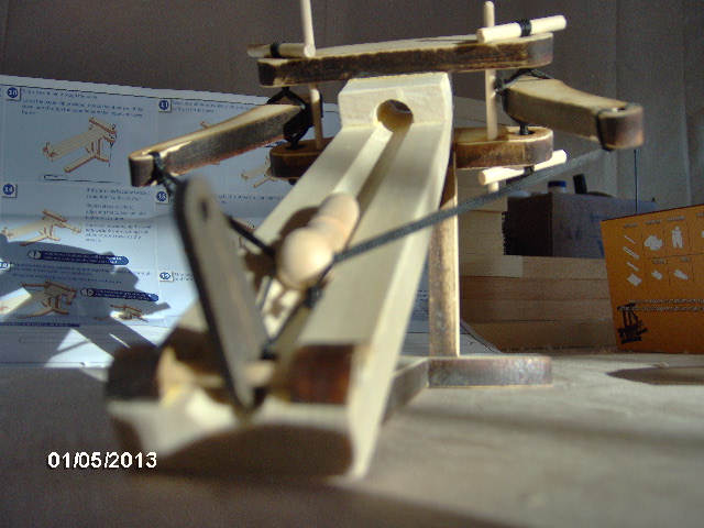

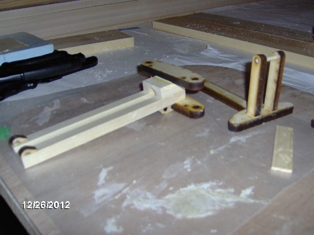

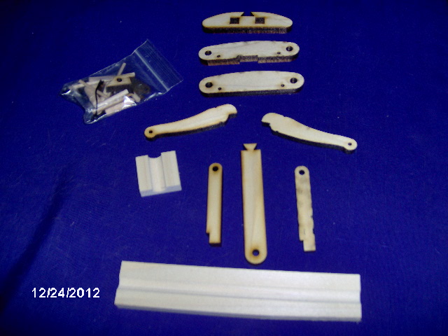

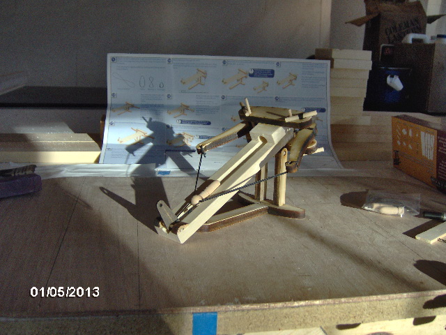

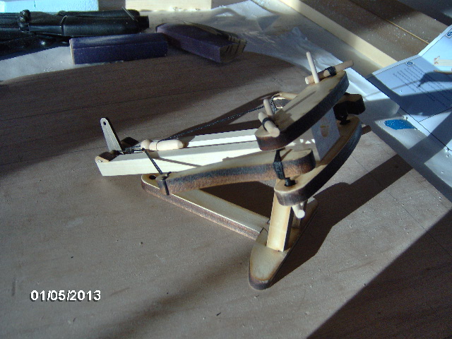

My sister had given me a toy ballista kit, and since it was too cold to do any gluing, and I didn’t feel like dealing with blue foam dust, I set in to assemble the ballista.
And after a week of freezing weather, today I finished it up.
A fun little project. It will hurl the little wooden bolt about 30 ft and has no problem throwing a volley of three all at once.

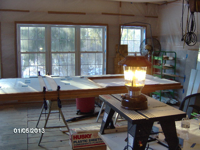

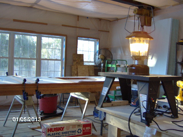

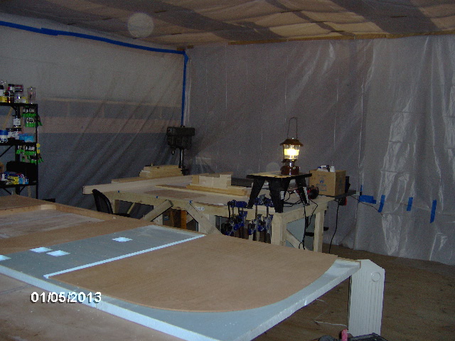

I brought the turd along to use as a supplemental heat and light source. When I opened the cap it still had pressure in it from months ago when I first got it, but I had to work the leather pump over again with my fingers in order to pump it back up.
When I first arrived at the shop around 1pm the outside temp was 40F (according to the Ford dash). With the electric radiator running on high the whole time since my last visit, the recording thermometer in the loft said that the lowest reading had been 27F and the high was 54F. The 54 was probably what it was when I last left, as the weather has not been much above freezing for most of a week. I know that we had some mornings that were in the low teens during that period. Current loft temp was 46F. At 4pm after running the lantern along with the heater the loft was up to 50F, but after the sun went down it started dropping back to 48. Which was when I left; the Ford said outside temp was 32F. So it looks like I’m getting anywhere from 6 to high teens rise over ambient. Still not up to the recommended 55 degs for TB2. Maybe I need to get the 228E restored and get it burning, too. Karl and I both frowned at me using a kerosene heater as they can be sooty and stinky (and there is already enough of that to go around from the metal shop downstairs.
Here are some pics of the turd burning.
A very pleasant addition to the shop.

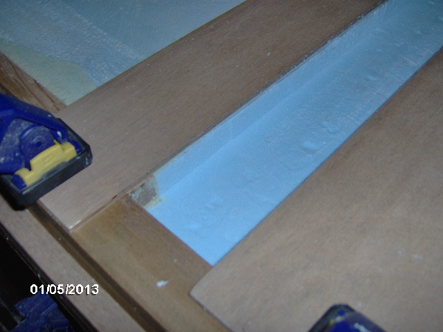

Next I wanted to do a test using the belt sander to level my little wall blocking glue experiment, to make sure that I could do it if need be without gouging out the foam. Stuck it to the bench blotter with a couple of patches of double sided tape.
At first I tried to use just the nose of the front wheel thinking that I could better direct the action that way, but laying the sander down flat on its shoe worked better (…makes sense, I guess).
I’m pretty sure that the low spot in the foam on the left was from an excursion while trying the nose wheel.

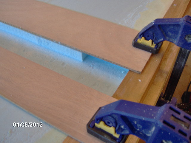

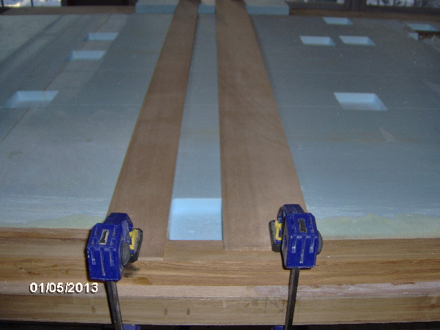

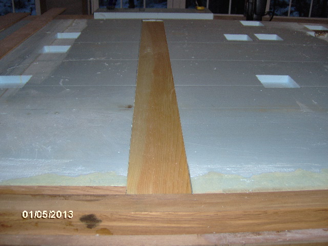

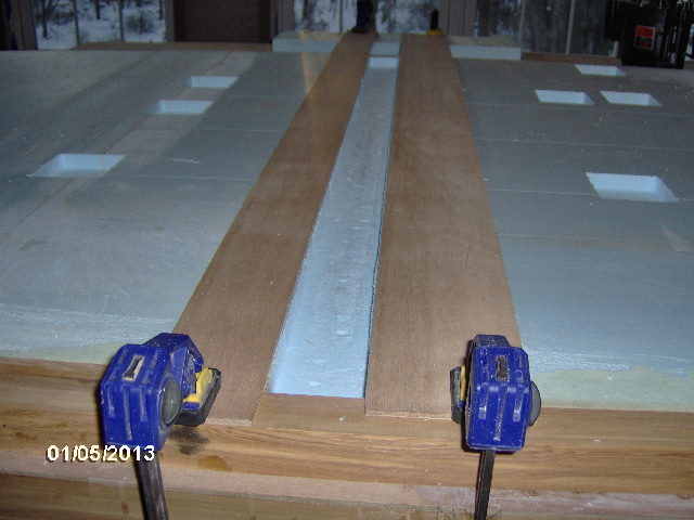

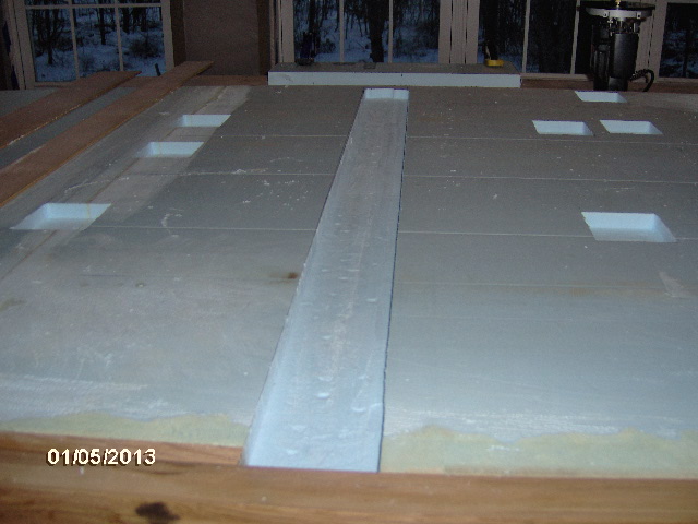

Here is the router guide set up for the street side recess for the bulkhead blocking. You can see that I have moved the front (right hand) strip back so that the router shoe does not drop into the hole.
Wielding the router and the shop vac hose at the same time was less than optimum, and with the heater on it ended up tripping the breaker, but I managed to make the cut.
Then I moved the right strip back to its original position (measuring carefully off of the rear strip), before moving the rear strip forward to close the gap.
Actually, after taking this picture I moved the rear (left) strip even closer so that the vac wouldn’t have to work so hard pulling on the open side.
Safety first. If you look closely you can see flecks of blue foam in my hair. I would normally be wearing my safety glasses with side shields, but must have left them at work… unusual.
Here’s the recess after a bunch of vacuuming and removing the guide strips.
And here it is with the 1x4 blocking test fit.
Not too bad, if I do say.

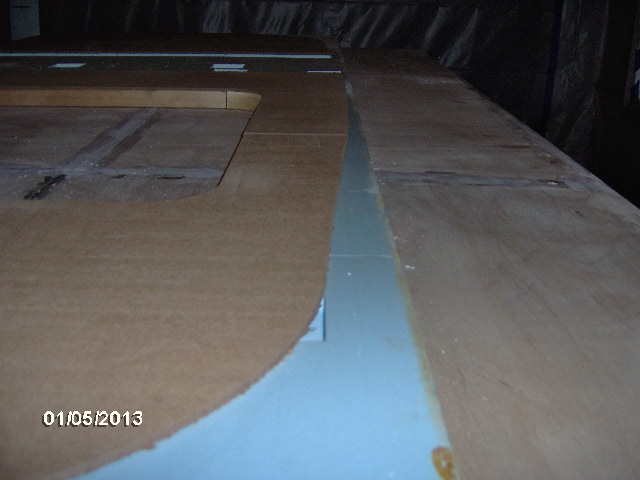

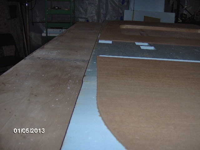

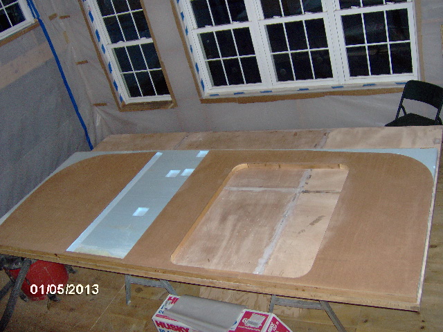

I wasn’t very ambitious today, but I decided to lay out the profile templates to get a good look at it before I left for the day. Unfortunately I found a few issues. :thumbdown:
For one, the middle piece is 18 inches too narrow. I guess Rover Mike was conserving material. The 520 inch radius crown appears to be correct on this piece and seems to end at the appropriate location for this width, so all is not lost. I can shift this piece around to use for that big radius, or use it to make another full size template.
However, the same ceiling crown on the other two templates, the front and rear ones, are inverted. They dish in instead of bulging out. Drat.
Front.
Rear.
The starting and stopping points appear to be correct, but the arc is in the wrong direction. Poop.
Nothing that can’t be worked through with more time and likely some more material.
