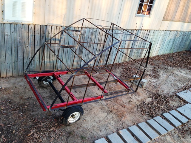

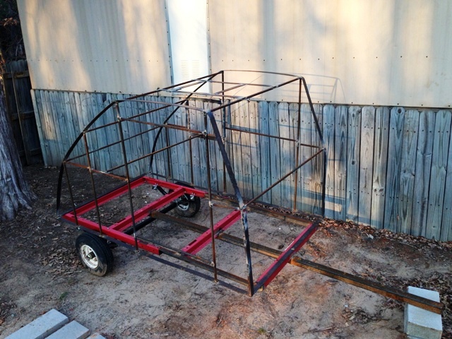

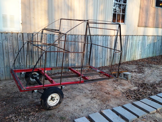

Here are some photos. The frame is 100% done, next is to coat the floor with roof sealant tape, do something for the inside of the floor and mount it. Cutting out and installing the interior panels and headliner should go pretty quick and then it will really start to take shape...

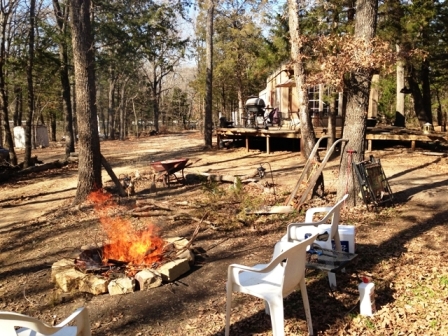

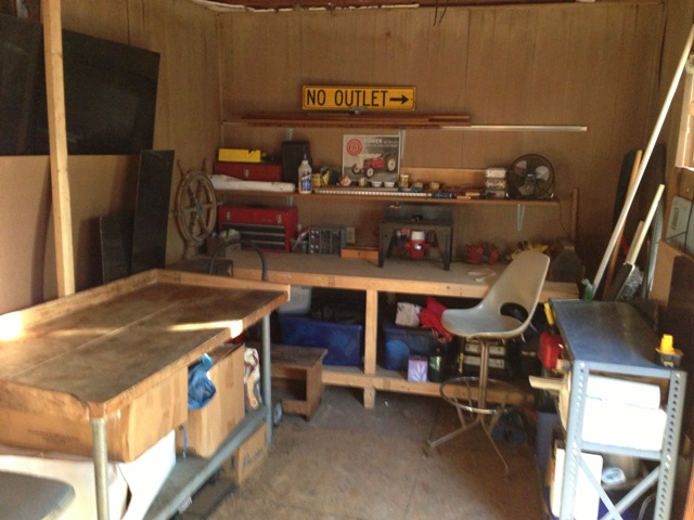

Oh, and I got the woodshop cleaned up and usable now, still need to run power to it, and I plan to do that when I run all my teardrop hookups!
Also dug a firepit... almost there!

Hey Thomas, it looks like you have altered your original profile? I noticed that the profile examples you showed at the beginning of the thread, in your signature, and the previous pic's of your side wall frames had a nice gently curved piece of flat bar on the perimeter, but the pic's you just put up have a more flat shape over the doors and the front wall-to-ceiling transition. I'm curious about the change. :thinking:
Re: 2bit build #2 "The Deuce" Welded frame is DONE!
Postby 2bits » Thu Jan 24, 2013 6:27 pm
KCStudly wrote:Looking good.
Yeah, the previous pics were the profile that I was aiming for, but I knew what the flar bar did was going to have the final say regardless of what I wanted LOL. I had hoped the front would gently curve more but the distance from the front of the frame to the first roof spar was so short, that the thick steel didn't want to curve and decided to bend instead. The roof ended up needing to be flat just for ease of installing the roof vent too. I think the aluminum skin will help alot and it will appear rounded except for that one spot. I think if I made that first roof spar a little lower it might have opened up the radius enough to let it make the curve, so I'll put that in the revisions pile for the next one!
