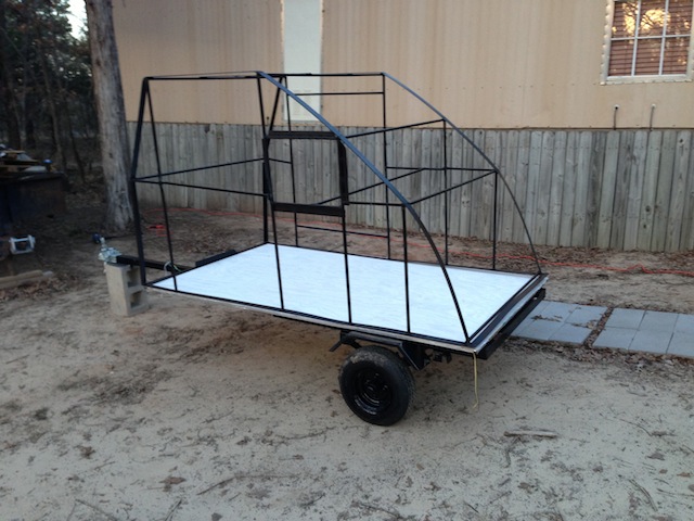

Looking good.

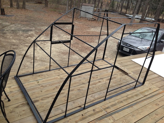

Hey Thomas, it looks like you have altered your original profile? I noticed that the profile examples you showed at the beginning of the thread, in your signature, and the previous pic's of your side wall frames had a nice gently curved piece of flat bar on the perimeter, but the pic's you just put up have a more flat shape over the doors and the front wall-to-ceiling transition. I'm curious about the change. :thinking:
Re: 2bit build #2 "The Deuce" Welded frame is DONE!
Postby 2bits » Thu Jan 24, 2013 6:27 pm
KCStudly wrote:Looking good.
Yeah, the previous pics were the profile that I was aiming for, but I knew what the flar bar did was going to have the final say regardless of what I wanted LOL. I had hoped the front would gently curve more but the distance from the front of the frame to the first roof spar was so short, that the thick steel didn't want to curve and decided to bend instead. The roof ended up needing to be flat just for ease of installing the roof vent too. I think the aluminum skin will help alot and it will appear rounded except for that one spot. I think if I made that first roof spar a little lower it might have opened up the radius enough to let it make the curve, so I'll put that in the revisions pile for the next one!

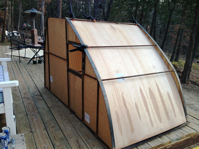

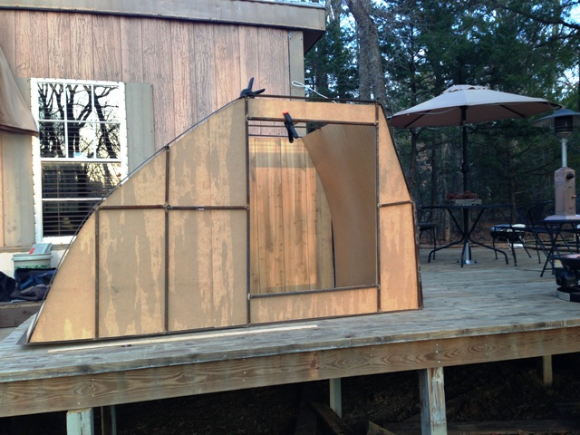

Re: 2bit build #2 "The Deuce" Interior Panels are cut
Postby 2bits » Mon Jan 28, 2013 12:46 pm

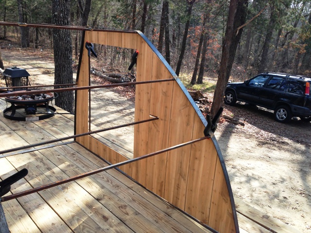

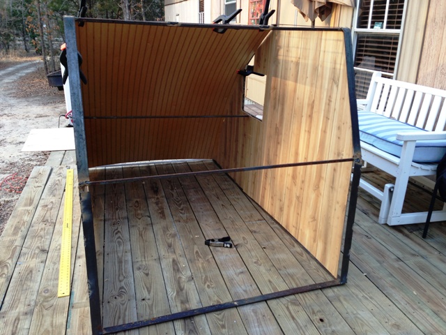

This weekend I got all the interior panels cut and fitted into place. It is supposed to storm tomorrow, so I pulled them out. I will do the same for the insulation and exterior panels and just keep them off to the side until I get the suspension and floor done, and then, I’ll be able to put it together in one sitting!
I put each interior panel up against it on the outside of the frame, drew my cut lines and within a few short minutes I had a wall, then the headliner slipped into place with a little trimming...
Postby 2bits » Mon Jan 28, 2013 12:50 pm
Final pics...

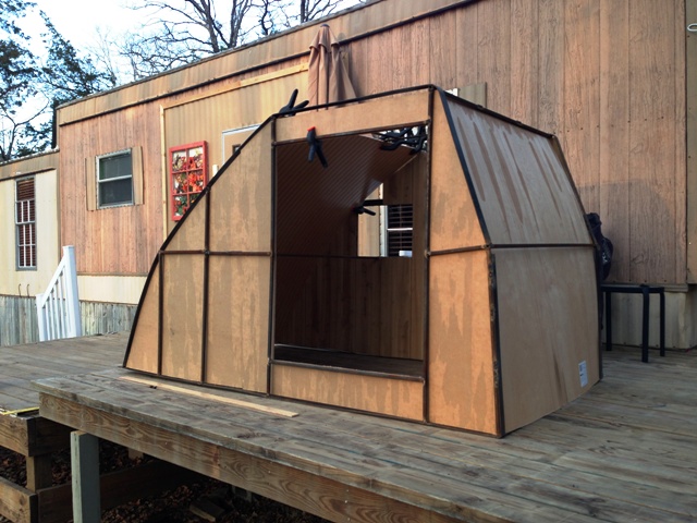

Got alot done today on the teardrop. getting closer!

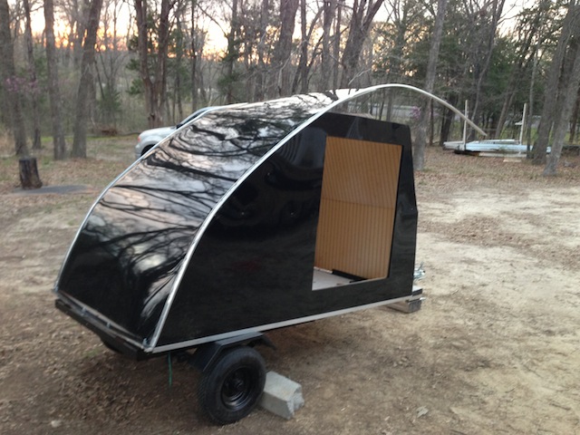

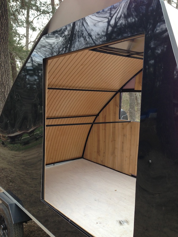

Postby 2bits » Sun Mar 17, 2013 11:48 pm

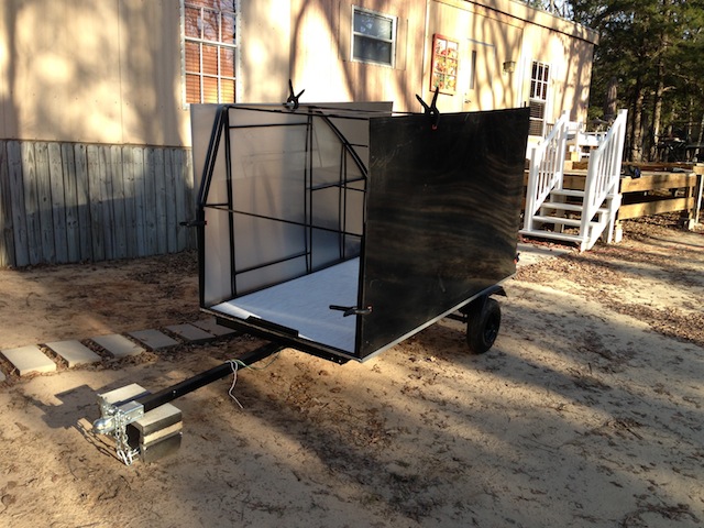

OK like... ahhh..... Beaver's Bend is Friday eh? No days off until then? Well I am REALLY glad for the time change because that gives me a whole hour after work to have daylight to get the teardrop campable!
Today the assembly finally happened! I bolted the frame to the floor, the floor to the trailer, installed the interior, insulation and almost got done with the roof skin. By tomorrow the roof should be done and Tues I will build the door frame Wednesday comes the AC, lisence plate and tail lights and Thursday (hopefully) the window and door handles will come in and I can build the door that night, otherwise I might be building the door Friday at the park!!!
Thomas
Postby 2bits » Sun Mar 17, 2013 11:51 pm
I like the black frame exposed...
Thomas
