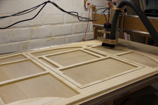

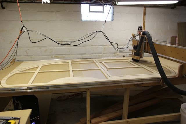

In 2006 I started exploring the idea of a nano cub, aka ultralightweight. In the second picture, look in the background. There is the 2006 ultralight!

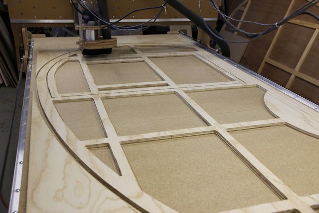

Over the past year I've been revisiting the nano cub. I tried cutting a nano cub side piece this weekend. I hit several snags, mostly on the Y axis... The y axis kept on slipping. I just barely managed to finish cutting the side, and the set screws came flying out of the side of the sprocket. So I am now dead in the water. New sprockets are on order.
But the bright side is, look at this pretty cnc cut side. I could cover it in epoxy, and not have to worry about delam.
I hope to be able to try again next weekend... :D

That is too easy! After the first side the second is gravy. Will you cut the foam the same way comping the reverse side of the lines? If I was to build another tear drop I would do the cookie cutter like that ,but I would have to do it the hard way with a cutout jig made with a Sawsall and router base sleeve. The stick method is not as strong (lots of joints)and harder to do (a lot of pieces verses one piece) I think. Have fun with the build.

Mike , that’s just TOO COOL ... 8) 8) 8) Did you make that CNC yourself ??? If so that’s Brilliant !!! :applause: Lots of uses for a side cut like that ... :thinking:
Just saying... I wouldn’t mind a couple sides cut like that out of 1/4” ply as an inner frame for a “you know what” ... I’m sure we’ll be discussing this in the Foamie’ section.... :roll:

For those of you who are interested in cnc, we installed some cable management today, i.e cable carriers...
Here's the pics...

I presume that's a 4x8 piece of plywood. What thickness is it....and how much does it weigh? and after you routed it out.....what's the final weight??

Micro469 wrote:I presume that's a 4x8 piece of plywood. What thickness is it....and how much does it weigh? and after you routed it out.....what's the final weight??
John,
Yes, it's a 4x8 1/2" plywood. I"ll run down and check the weight in a bit.
