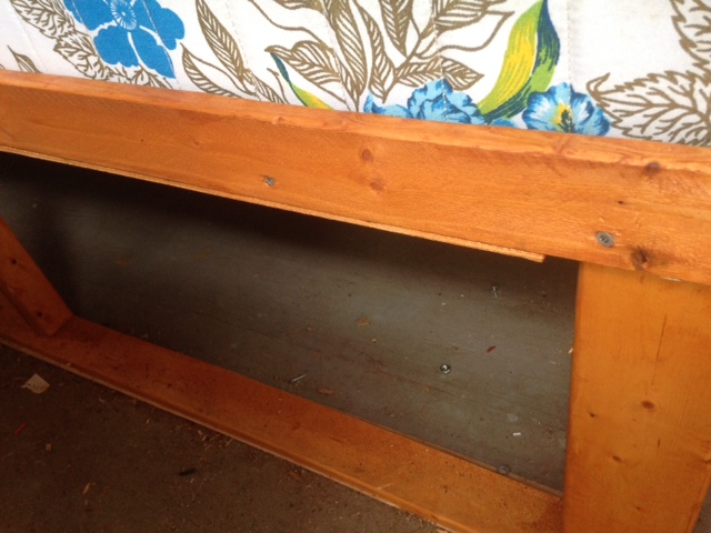

Postby Gold5one » Sun Jul 26, 2015 7:40 pm
I used a 1x3 for the sides of the bed frame and 2x2 for the cross members. The 2x2 is flush with the top edge, leaving a lip that can slide in the grooved board on the wall. I"ll post a few more pictures if the rain stops tomorrow.
Mark

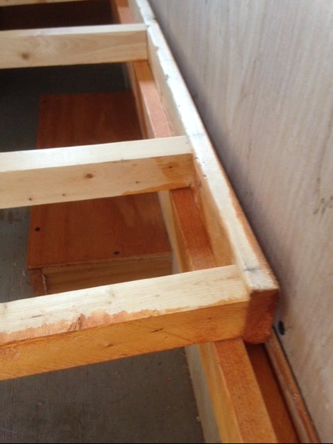

Postby Gold5one » Mon Jul 27, 2015 3:30 pm
I hope these pictures help. The bed weight slides on the 2x2's- use bar soap or paraffin to help it slide. 2x2's are on 12" centers, but use your own judgment for spacing- this is a single wide bed. I doubt that you could slide a wider bed.
you must screw a short plywood strip to the wall above the 1x3, so it stays in the track going down the road.
Mark
