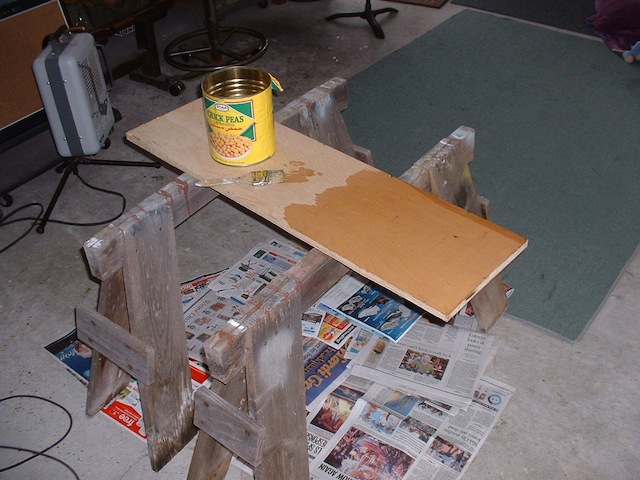

Just finished the first (soak) coat on my TT repair board and flooring ... Under the fan , the Min seems to evaporate very quickly , leaving the poly to dry ... The fan really speeds things up ... I'm timing it , and will do a "sticky" test and report ... Just FYI

Rob , ceiling fan on low , just to keep the air moving over it ... 2 hours and it's not tacky anymore , just not dry yet ...

Postby GPW » Sun Feb 27, 2011 6:37 pm
Here's a pic of the sealing .... you can see how it soaks in ... Image
Checked and its completely dry now ... :thumbsup:
