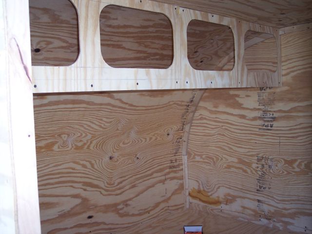

Gary
The lightest standy build I've seen was Steve Wolverton's Puffin. He used 1/4" plywood in both the walls and roof with very little to no framing. Just the door frame and shelves and a center rib on the roof for about 3 to 4 foot between the front and back shelf. He did fiberglass the outside which added strength though. If I remember right Puffin weighed between 700 and 800 lbs and I know that Steve pulled it with a Subaru outback with no problem.
Unfortunately the pics from the build thread are lost which is a shame. there are a few left in his gallery though.
http://tnttt.com/album_ ... ser_id=404
One of them plainly shows the lack of framing in the wall over the bed.
Gary
Ps here is the link to the build thread. It's interesting reading but without the pics you have to use your imagination.
http://tnttt.com/viewto ... ght=puffin
