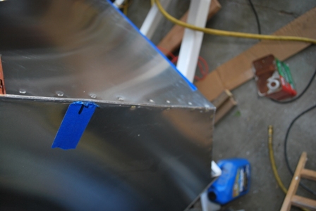

I essentially "floated" mine as well with the exception that I stapled mine around the edges to hold it in place.
(maybe my picture will show up after everything gets smoothed out tomorrow) :NC
Yea! I got the pic to work.
I made my own edge trim 3/4 x 1 1/2 so I wasn't worried about covering the staples. When using the store bought edge trim, you would have to be more careful if stapling the sides. They (staples) would have to be awfully close to the edge on the sidwalls, you'd have plenty of room on the top though.
Just my thoughts, didn't say they were good ones. :D
