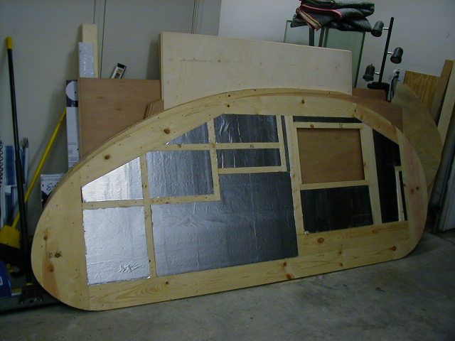

Like others, I made a template out of 1/4" MDF. (In the picture I had not yet cut the door opening in the template.)
44730
For "framing" I used 3/4" plywood. Lay the template on top of the plywood and trace the outline of the framing onto the plywood.
44904
Then remove the template and rough cut the plywood framing with a jig saw.
44901
I don't have a picture of it, but place the template back on the plywood, and use a router with a template bit to finish cutting the plywood framing. (I purposely did not cut the doors all of the way through at this time. I left the door framing in place so that the grain of my interior finishes would be continous.)
46030
As others have said, 1/4" plywood will work as exterior and interior skins but 1/8" plywood will be strong enough and will save some weight.

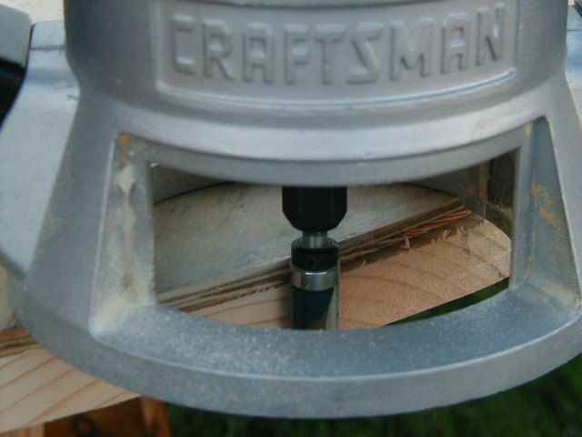

Like this?
Like I said, you don't need walls that thick, 1/8in luan is all you need for the faces. The whole reason to put the "studs" in the walls is the same for a house, so you can screw things to solid wood.
In this picture the template is on top, screwed down to the frame. The router bearing rides on the template and the flush bit cuts the wood underneath.
