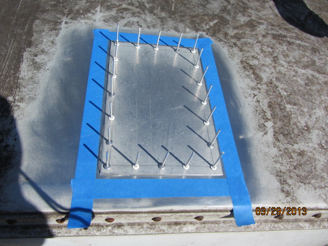

fixing a hole in the roof
Postby Irmo Atomics » Wed Apr 10, 2013 4:54 am
I got a little carried away with the rivets, but make sure you mask off the area that you don't want to get any caulk on.
