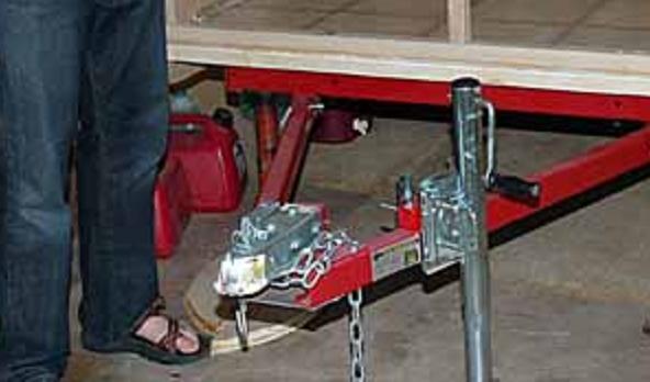

Get it towing level ! You have all the weight tipped forward. If you have a receiver type hitch get an up sweep ball mount. If you weigh it with this tongue height and weigh it again level you will see a hugh difference in the tongue weight.
Postby Dale M. » Mon Jul 25, 2011 9:11 am
Tongue weight???....... First off have you put tongue on scales....
Car seems to be sitting level in pictures and angle on trailer indicates hitch on car is to low....
Also the way coupler is on tongue looks funky like its to high or mounted wrong... Got a detailed picture (close up)...
Need additional information....

Postby bobhenry » Mon Jul 25, 2011 9:31 am
Looks like the standard HF coupler mounting.
This mod will get you a couples inches up and improve towing and backing by extending the tongue a bit.
http://www.tnttt.com/viewtopic.php?t=42166&start=0
Postby kzhorse » Mon Jul 25, 2011 11:53 am
bobhenry,Thanks for the link I will pick up a piece of 2"x2" from work and get this done before I take it out again.The first trip out was this weekend went to Gettysburg and every thing went good.I will have to replace the pins with bolts,I didnt like the bumping noise over bumps.

You don't flip anything but the little plate that the coupler sets on. simply un bolt the coupler plate and turn it over then slide the 2x2 thru to as far as you feel good about going. I took mine all the way to the rear and used the back end for a 1 1/4 draw bar receiver. My trailers are extended to 10' bodies so if I remember correct my 2x2 was 13' - 14' and extended my stock tongue forward 18"
