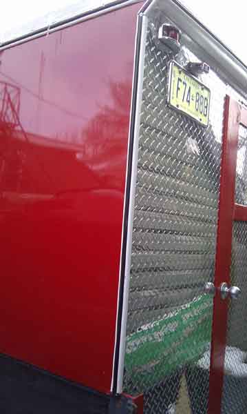

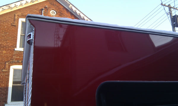

Got the corner trim on the rear corners
![Image](https://www.tnttt.com/gallery/image.php?album_id=24&image_id=88374&view=no_count)

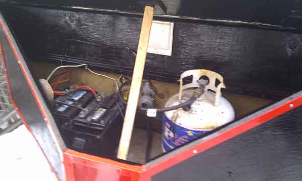

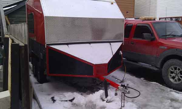

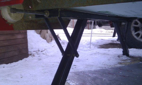

and it was so nice I decided to head to the front for awhile, got the front box and framing painted, plywood back in and painted,
painted the bottom of the lid
painted the tongue and wired a light for the front compartment.
Mounted the regulator and put the second battery in
Have the jack and handle mounted in there, is room for a second BBQ tank, shovel hatchet, saw and tire iron will all get mounter on the back wall of the compartment, and I'm hoping I will have room for my patio heater in there and maybe my Weber egg BBQ
Bottom half of compartment will get painted in spring or summer, too wet down there right now
![Image](https://www.tnttt.com/gallery/image.php?album_id=24&image_id=88376&view=no_count)
![Image](https://www.tnttt.com/gallery/image.php?album_id=24&image_id=88377&view=no_count)

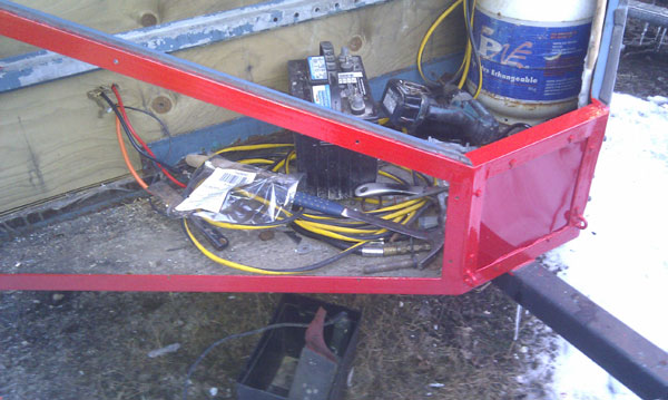

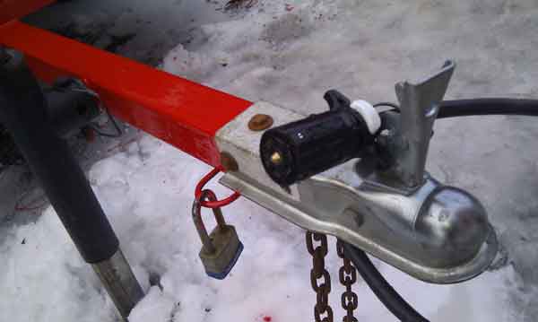

Seein as I got the tongue painted I fished my seven wire up through the tongue and got the plug on it
All splices tyeing into the existing wireing are inside the storage box out of the weather
Just have to run 2 wire back to the brake axel now and all running wiring will be done
![Image](https://www.tnttt.com/gallery/image.php?album_id=24&image_id=88375&view=no_count)

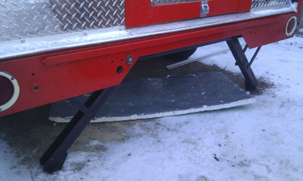

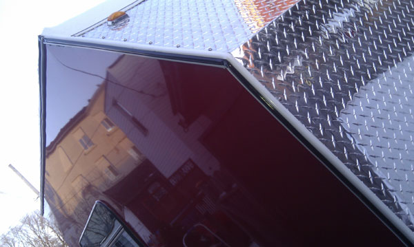

![Image](https://www.tnttt.com/gallery/image.php?album_id=24&image_id=88378&view=no_count)
Going to have some trouble with oilcanning though, sun came out for a bit and warmed the aluminum, EEK!!!
Will likely have to pull some corners in the heat of the summer and trim the aluminum a bit...OH WELL
