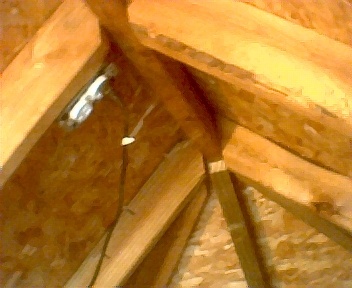

Ok, the roof air venting/heating/cooling. I finished the physical ducting and fan installation for the roof peak interior. 6 fans total. two "register"/air vents. Each fan intakes two roof compartments worth of air. Hot or cold. I will have the two fans on each side controlled simultaniosly. (left has two sets of two compartments. right has two sets of two compartments. front has only two ceiling compartments so only one fan. rear has only two ceiling compartments so only one fan.
Each of the 4 roof sides will have one temperature sensor (thermistor, these things can tell if a flashlight is on or off at a yard away), one temperature sensor inside. one temperature sensor underneath (ambient external sensor), and a sensor in the hot water tank. (ever felt a garden hose in sun? ever feel how hot the water is coming out? :-)

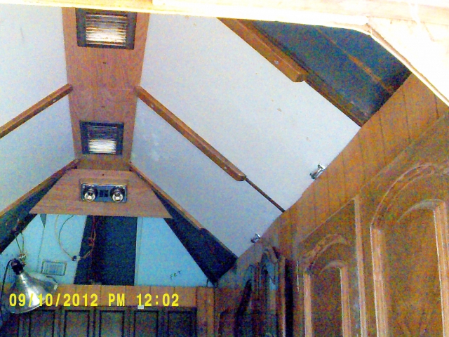

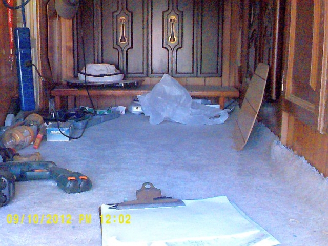

Ok, BIG progress jump!
First, I show you the interior look. Then in the next message I'll "prequel" the heating cooling system in the walls and ceiling, and how I finally resolved the ducting, fans and registers. After that I'll go into the wiring.
first picture

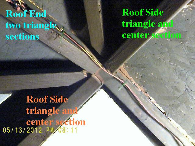

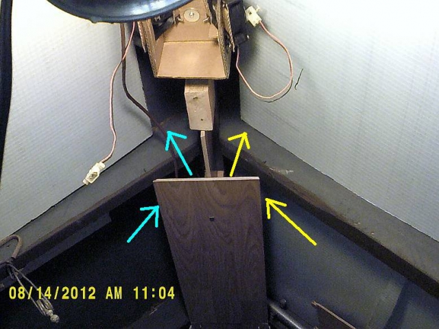

Note the blue marking of the inside roof beam locations. Each of the 4 corners have a triangle going each way, side and end. The middle of the sides have two spaces that are square/rectangle.

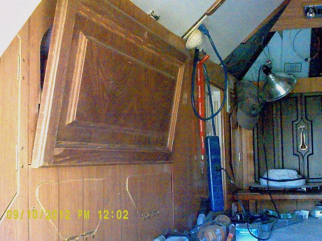

interior floor view. that "table" at the front also doubles at the back for travel to make sure nothing blows out the rear door from rolling, if I pull a wheelie while towing.
interior left wall view. note I now have the paneling in under the fold down desk, and two compartments under the desk, with the doors as paneling. These doors will be spring close, friction latch, and ribbon grab and pull to open. The idea is to avoid knobs that will poke me in the back if I lean up against it or take a chunk out of me if I brush past it. ( the handles on the doors at the front are recessed, so they were left on. )
this is the left roof interior. originally I was going to have these side roof panels slide open at the top, but that is a 90 degree angle to the next major surface. By placing the handles at the bottom and having them open at the bottom then there is only a 45 degree angle. The "guide boards" screwed to the studs are notched so the covers can slide, then the bottom latches by virtue of just going behind the wall piece. I have to cut down the guides, possibly in half. This is due to the cover pieces being MUCH more stiff than I had anticipated! The outlet was at the top for a center 110vac light, but I decided that with the end 12v spots, and I'll put in individual LED lights (4 or 5 variable brightness) that I don't need the light at the top and the cord(s) for any thing else would just get in the way. (One of the outlets is on a 3 way circuit with a switch at the front and rear, left side.) I am planning on cloth loops of velcro on the panel guides for attaching things, and screw-in eyelets in the corners for heavier stuff (so I don't loose my scalp hitting an eyelet they will be in the corners where my fat head can't reach. :-) This is also your first view of the ceiling registers installed.
right ceiling view. this only show the square/rectangle side-center pieces in. The corner triangle pieces (sides and ends) will hinge instead of slide open. the other end above at the ceiling duplicates what you see.
right side + ceiling.

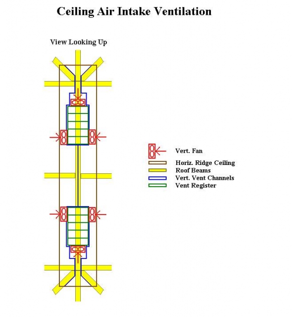

Postby PcHistorian » Thu Feb 28, 2013 3:26 am

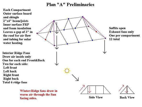

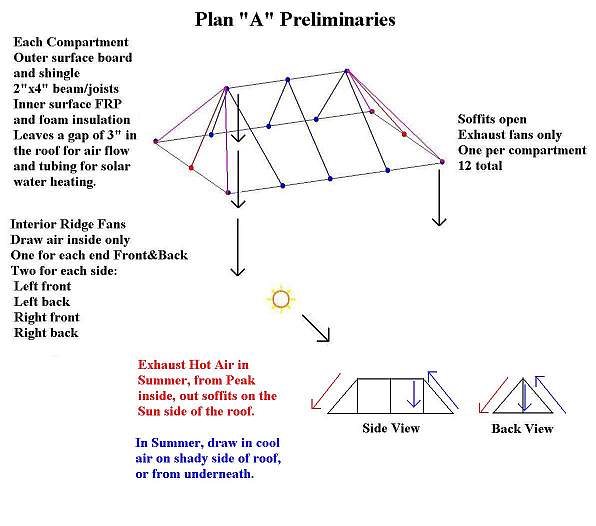

Ok, here is the AIR PHASE of the heating cooling ceiling system. (passive solar only)

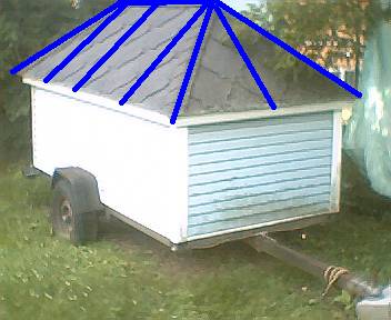

External roof view, with internal beams locations drawn in blue
wire frame view of desired summer air flows. (hot air out, cool air in.)
wire frame view of desired winter air flow. (hot air in.)
actual internal ceiling view.

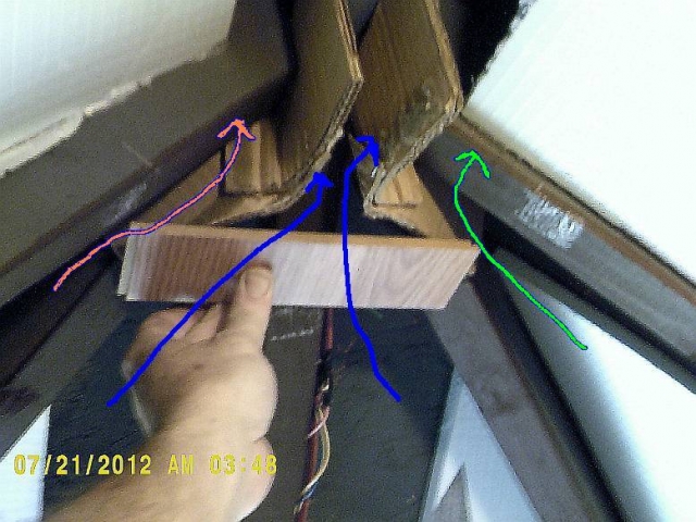

additional desired possible air flows. along one side, side to side across, and then from the outside to the inside or inside to outside.
ceiling stained navy blue. vertical view of ceiling where the beams join. (the wire is for the future van spot lights.)

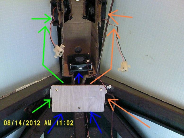

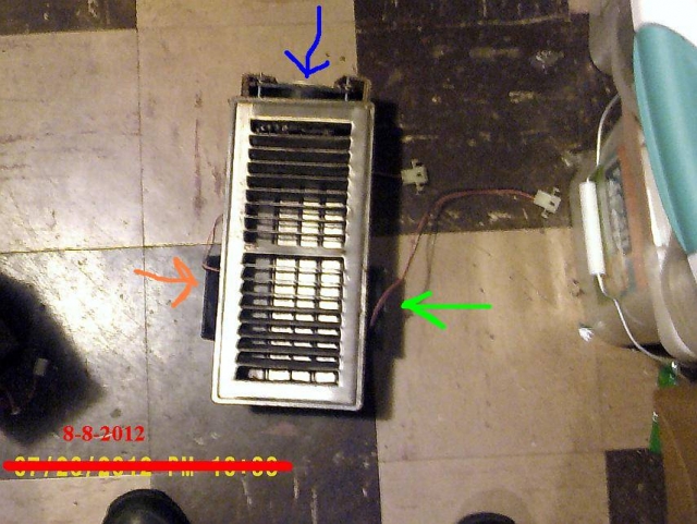

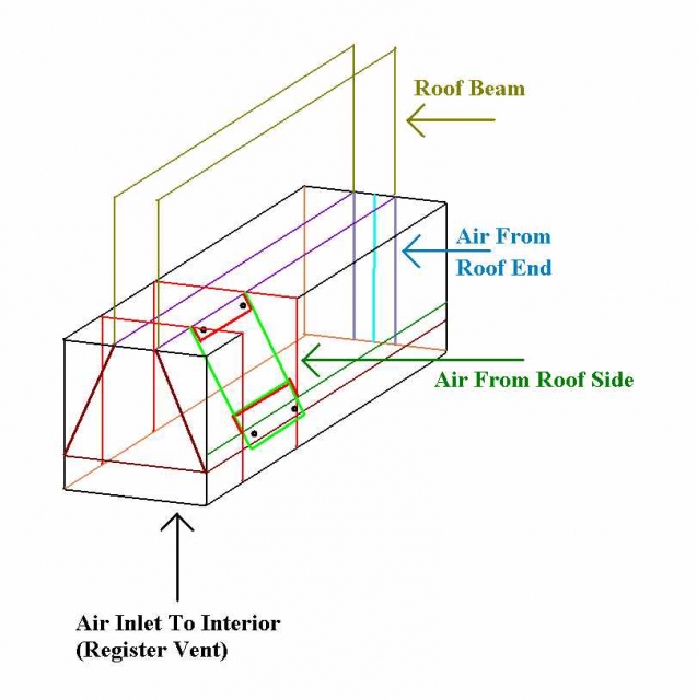

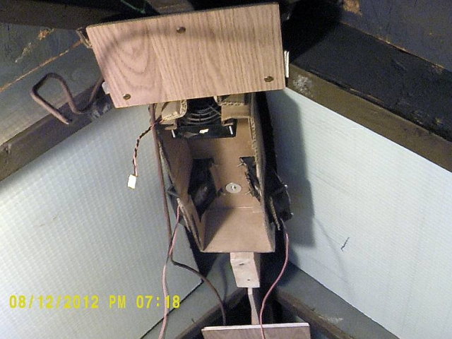

The Design of the air ducting. two end compartments to the end fan, two side compartments to a side fan. roof beams shown.
I was going to do the ducting in the same material used for the inner surface, what is used these days for psuedo-hard-wood-flooring, a highly compressed fiber like material (very dense and hard) but it was too hard to work with so I switched to cardboard and I'll either use that for the patterns of the final pieces or I'll just paint them with polyurethane for water proof and added stiffness. This shows the channeling for the end two sections into the single point, and the separate side triangle sections to get channeled in with their perspective side square areas.
this shows an actual full sized "end cap" in place and the routes of the air flows.

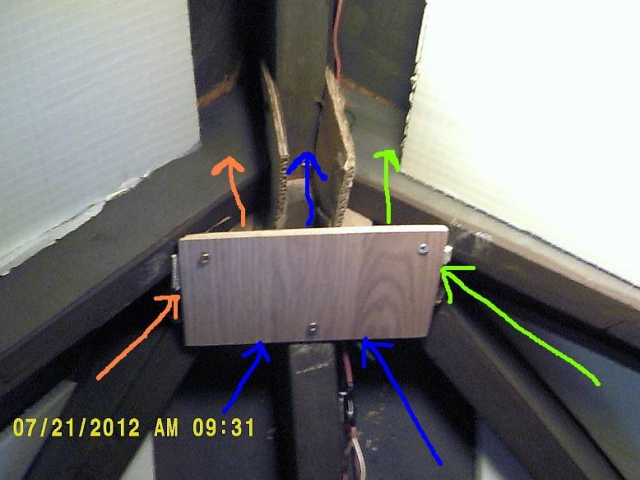

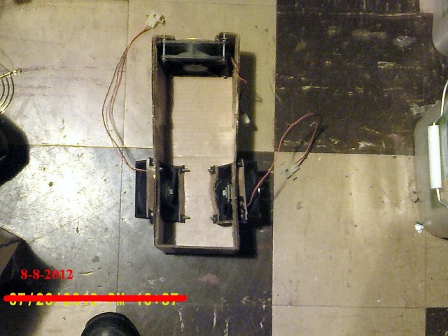

So I needed to make a combining "register box" that had a fan on the end and a fan on each side for input into the register.
(wire frame view.) The box would then be bolted to the center-line beam on top and the bottom would be open for the register/vent.
bottom view, assembled with fans.
Bottom view, assembled with register in place, 3 air flows displayed.

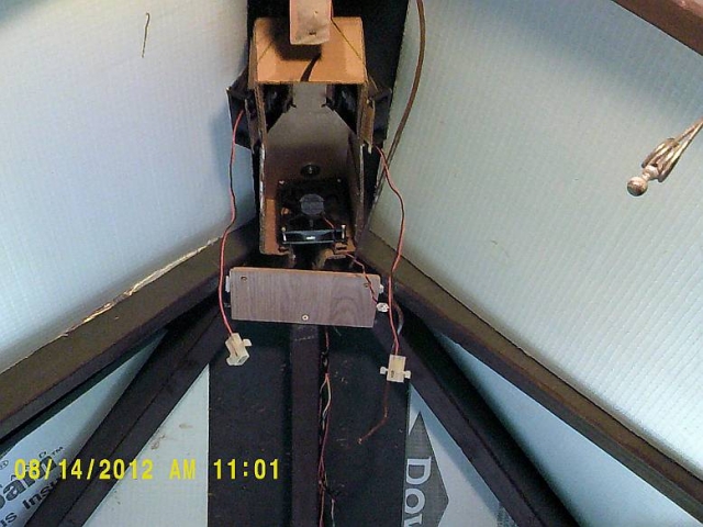

one register box mounted and interfaced with the end ducting, and cap
various air flows diagrammed
A ceiling register cover plate in place and more surrounding air flows diagrammed. This shows just the "along the side" air flow paths. Second box for the other end is installed. Note the divider coming down from the roof center-line beam to restrict the side to side cross ventilation, but just guide the air flows along the individual sides. One will be in the sun and the other in the shade, probably, unless the sun is overhead.

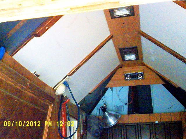

ok, the box at the near end ceiling.
this then is the final view with the registers installed in their cover plates, with the side compartments having their covers in place and the end spot lights installed.
So that is the air flow ducting system.

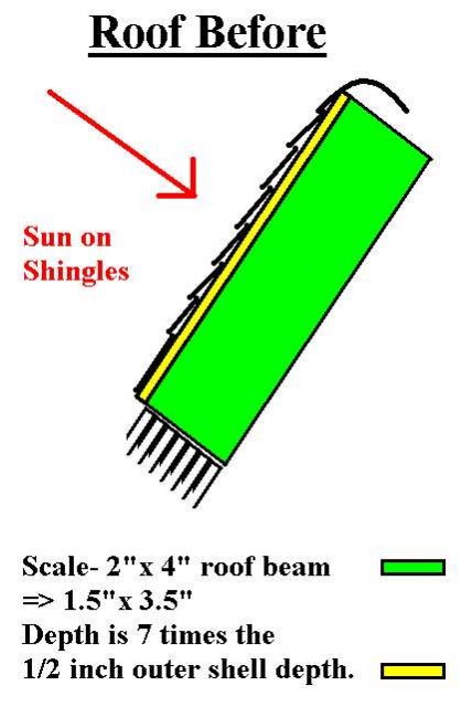

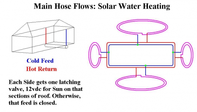

ok, next comes the water jacket part of the roofing solar system.
What this entails is a layer of small water hoses in loops to take up heat in the ceiling space, that is coming in on the sunward side. (this is only going to be water in the summer. It will be emptied come winter. (probably by pressurized air)

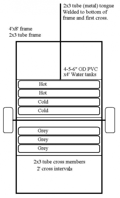

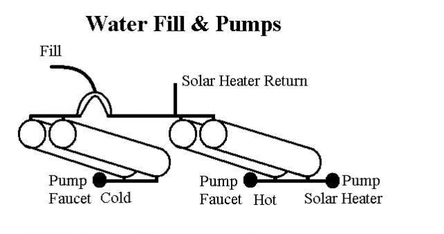

Let's start with the arrangement of the water tanks. The water tanks will be made from 6 inch diameter PVC or water safe pipes, capped and with hose fittings, and mounted between frame sections under the trailer, in front of and behind the axle. (Fresh hot and cold water in front of the axle, and the grey water behind the axle.
Next comes the fill and pump arrangement(s) for the supply tanks. Note that there are three pumps, one for hot, cold and solar heating the water. And, that there is a return for the heated solar water back to the hot storage tanks.

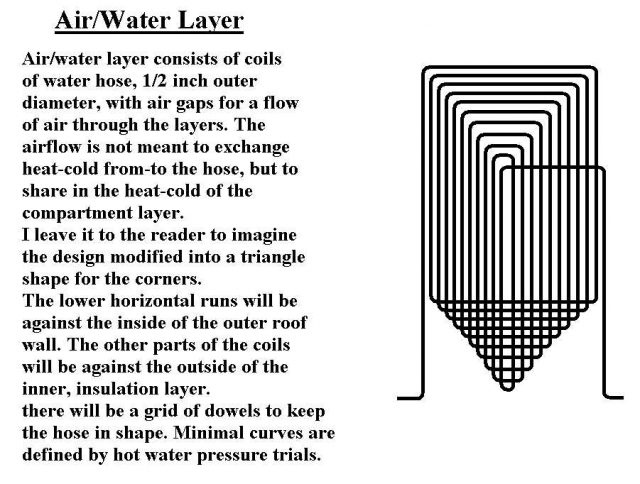

Then we see the 6 loops of hose in the upper part of the trailer. Two loops go around the top of the walls, one is a pressurized cold water feed and the other is the hot water return. Then there are four loops, one for each side of the roof. By doing it this way I don't run hot water through cold sides of the roof as a single huge loop, or requite 4 pumps, on for each side of the roof. Which ever side(s) are warm or hot from the sun, then a latching valve for that section of roof is opened to supply that loop with water. These valves latch open or closed so that continuous 12vdc power is not needed, just a short pulse to open or close the valve. A little bit more cost up front but big savings in power over the life time. The solar heating pump is not to be run continuously either. It will only pump to flush and refill the sun side with cold water then let it heat, before purging the hot water down to the tanks and refilling again with cold water. That approach also saves on pumping electricity.

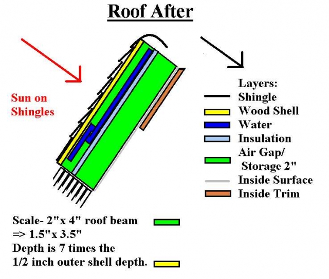

Then we look at the layering of the roof sections from the outer shingle side of the roof to the inner ceiling surface inside. Originally there was just shingle, a surface of 1/2 inch particle board and the inner roof beams.
The plan here is to put a layer of small water hose in loops surrounded with air gaps, so both air and water can flow through the sun heated roof compartments. these also serve to absorb the heat that would normally radiate into the trailer. So I can either draw the hot air of this compartment into the trailer to heat it, or push it out the sofits to cool the interior, by bring in shady air from the other side. Inside of the air/water layer is a layer of insulation to help control the heat or cold from outside of the trailer. (if winter then this keeps the cold of the shady side insulated from the interior, while I draw in the warm air. Or it keeps the hot air out on the sun side in the summer, there-by keeping the interior cooler.
And lastly I have a diagram for the proposed looping of the hose. I want to keep the hose layers thin to conserve any other space that I might have in the ceiling, so just two thicknesses of hose are as deep as the hose layer goes.

Well now I'm agonizing over the diameter of the roof hose to use, (ID) so that I can bend it and it will never kink under heat. I've considered down to 1/4 inch inner diameter, but it would need several parallel hoses to build up to the 1/2 inch for the pump output.
I think I may just have to use the "slouched/flattened coil" idea. If I make a perfect tower coil of the hose, and then topple it over and flatten it a bit that should be around right. With 1/2 inch outter diameter hose and then that coiled double thickness, that would give me 1" of depth. Another 1/2" for insulation on the inside, still leaves me with 2" depth of the 3.5" depth of the 2x4 stud walls and roof joists.
That is because of my worry that the smaller bends would get heated and end up a kink that would shut off the flow... Challenging to think into the future, go camping with it 10,000 times, decide how it worked for those 10,000 times and the fixes, then re-engineer it, and go through another 10,000 trips, etc.... til I finally get it right, then come back to the present and build the final design first. LOL (sounds great but we'll see how that works in practice...)
I am also deciding to make a single loop of hose on the wall top, have a basic "T" connector for the roof loop outputs and the latching valve 2 way for the roof loop inputs. I wanted to try to have cold water coming into each roof loop at an equal temperature and then hot water coming out of each roof loop at an equal temperature, instead of the warm output of one loop going into the next loop, because then one loop will be the constant coolest roof loop and one loop will be the constant hottest roof loop. I don't know if that is good or bad. LOL Hot water coils though will soften the hose, so I need to put it at a neutral, tightly controlled angles for that relaxed state. Too sharp an angle and not controlled positioning enough and the kink will be in and block the pump.
the order seems to be, put in the tanks. (3.5' long of 6" diameter pvc. undercarriage. now that I have it 6" higher from the ground.) Then go sink and pumps. Then add in the water heating system. No sense doing it in the reverse order... Although I'd like to get the ceiling compartments finalized so I can start using them for storage with the left over space...
