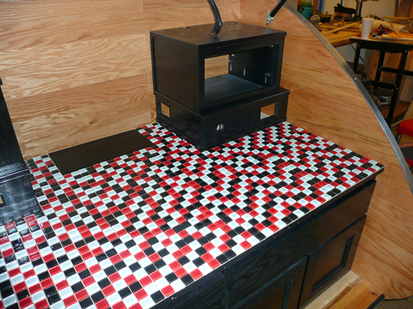

:? As I am typing this update at 8:00 pm, the temperature is 100 degrees. I'm not sure how much more of this I can stand.

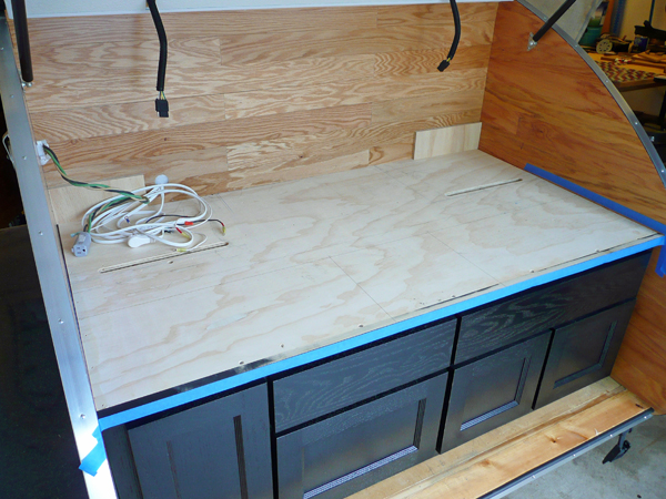

I did get a chance to work on the SB a few hours this afternoon. To be able to install the upper cabinets, so that I can install my converter and finish the electrical system, I had to finish my galley countertop.

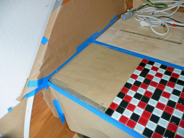

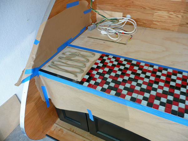

From an earlier post, I noted that I'm using glass mosaic tiles. Not having done any tile work before, I was concerned. With the teardrop bouncing down the highway, keeping the tile in place is a priority. I ended up using PL Premium as "thinset". Mark (Planovet) and Earl (Loader) among others have adhered their tile this way.
After drawing layout lines, I squirted on the PL Premium, then used a notched trowel to level the glue "setting bed", and positioned the sheets of tile in place.
I'm happy with how it came out. Seems to match my cabinets, and fenders, wheels and tires pretty good.

Danny, I agree the picture will make your head spin. In person, it doesn't look as busy as it does in the photos. The area between the two counter cabinets will have a microwave or toaster oven so part of it will be covered. I think the white grout I plan to use will also help tone it down.
