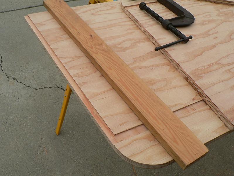

Bob Henry has the ticket...or when the work is too big for the tool, bring the tool to the work....use a piece of material as a fence, clamp it and use the router to cut your rabbet. Doug
Postby teardrop_focus » Thu Jul 08, 2010 9:18 pm
Hey fellas! Coffee break.
For a spline joint ??
No.

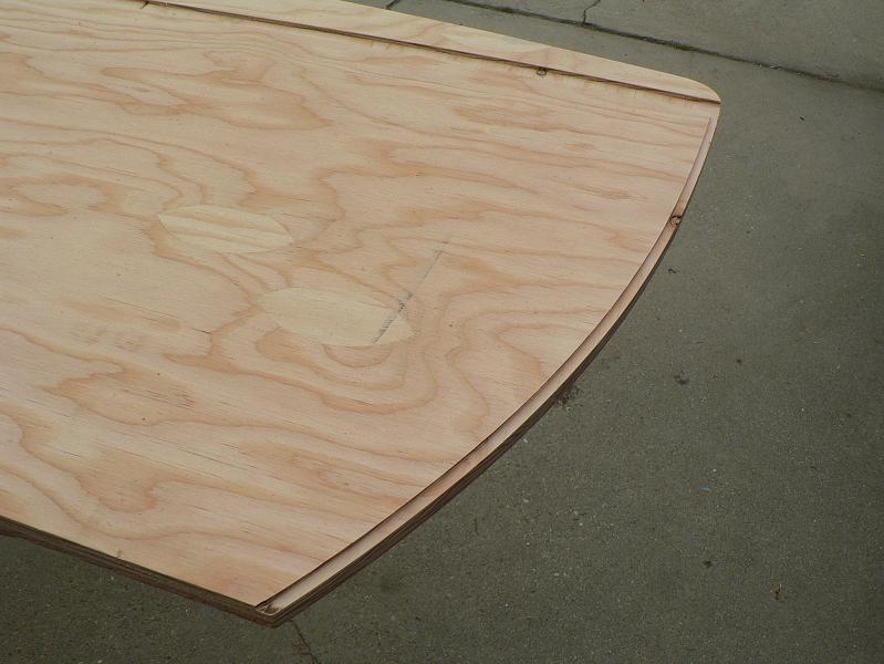

I'm working w/ 4 X 10 ply... and all the dados have been cut. What happened is that I spied a router table on my neighbor's table saw... so we tried to rout the 10' section that way. Next time with stuff that big like Doug says I'll bring the tool to the work instead of the other way around. I clamped various fences over the rest of the work to carve the other, shorter dados and rabbets.
Now, if I'd done this sort of thing before, it'd be going a lot faster!
:lol:
...but all that's left now are two rabbets on the front and rear of the trailer floor... both 3/16 deep, one 1/4" wide, the other 1/2" wide like what I just did on the walls this afternoon. Pics later tonight.

I can't just knock it out as I wanted to; I have a standard of precision... whether or not I actually achieve that standard is another story.
:lol:
As for the stain idea, the "good" side will be the interior facing and wiped w/ Feed-N-Wax, an orange-oil/beeswax emollient; the knots' side/exterior will be painted dark red. A tan-colored tarp will cover the open top.
Here're some pics from this afternoon's hacking:

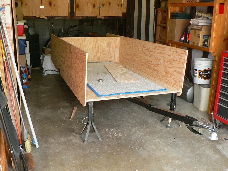

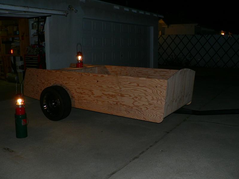

My next-door neighbor Bob came over to help with the tough job of getting the now-bowed 3/4 ply floor into the wall dados. He glued then held the wall while I drilled then screwed them onto the sides of the floor.
As I post this it's the middle of the night and I can't sleep. Think it might have been the big ol' mug of coffee I had at 7:30 PM?...
So here're some pics:
Walls up -
Don't let your ply floor sit around for too long if not layed flat on the ground. This ACX began to bow, which made our job a little difficult...
On the ground - (that headboard curve just kinda happened. The piece was too tall and we talked about best sealing the front of the tarp for travelling, so here we are, with this...)
Next is a piece of 1/4" ply for the rear wall, chassis wiring and some paint.
Okay, I'm going back to bed.
