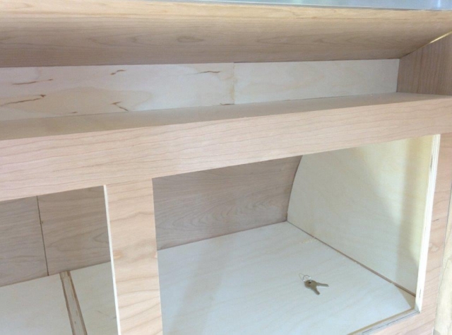

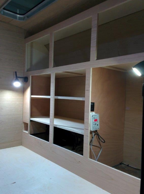

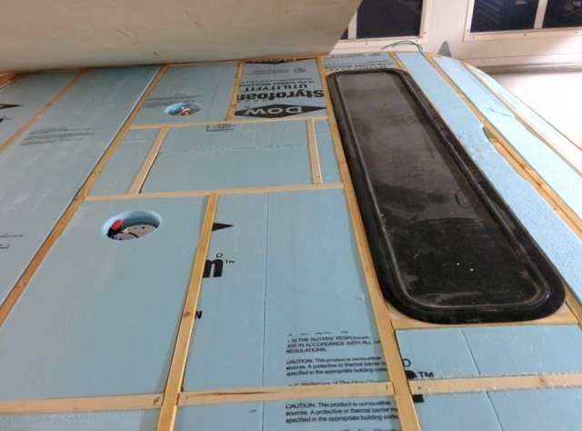

Postby Lambertdarr » Wed Nov 26, 2014 2:04 am
Almost compete with insulation other than the hatch
Totally finished with the cabinet frames in the front. The Cherry came out fantastic, Now to trim in walnut and to figure out stain
gallery/image.php?album_id=3768&image_id=126562
The little pocket in the pictures have a cigar electrical adapter in the back of each with usb chargers for cell phones. There is one on each side
gallery/image.php?album_id=3768&image_id=126564
Small shelf on the very top of the cabinet for little stuff like flashlights, books, etc It runs the enire length of the shelf
Rear shelves also in cherry. two top cabinets wil have sliding doors yet to be installed, the bottom one will have custom built boxes 3 on each side of the divider for clothes

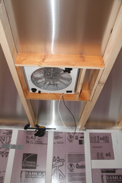

Postby KCStudly » Wed Nov 26, 2014 7:31 am
That is looking very fine, indeed! :thumbsup:
Just a heads up. Did you build the vent fan frame to match the screw pattern of a known fan? Despite the 14 inch standard size, and most people suggesting a 14-3/8 to 14-1/2 inch rough opening, what I found on my Maxx Vent brand fan is that the factory screw hole pattern is a bit wider still. This prompted me to use 2x2 surrounding my fan. you may want to take a closer look at this now, if you haven't already, to make sure that your vent fan screws will find wood.
I'm not familiar with other fan options. I suppose some do not come with the holes already in them, but if they do it would be worth looking into. 1x on edge isn't really a very big target.

Postby Lambertdarr » Wed Nov 26, 2014 11:00 am
Good call. You saved me a good deal of cussing and screaming. I will double up on those

Postby lrrowe » Wed Nov 26, 2014 4:45 pm
KCStudly wrote:That is looking very fine, indeed! :thumbsup:
Again, you are doing very nice work there! :thumbsup:
I just installed mine with 1x4" pine boards in a 14 1/2 x. 14 1/2 inch square. And I just noticed that two screws missed the wood frame. Darn. No leaks however. I will reinstall those two screws with a slight angle so as to install into the wood.
So I agree. Use wider boards.

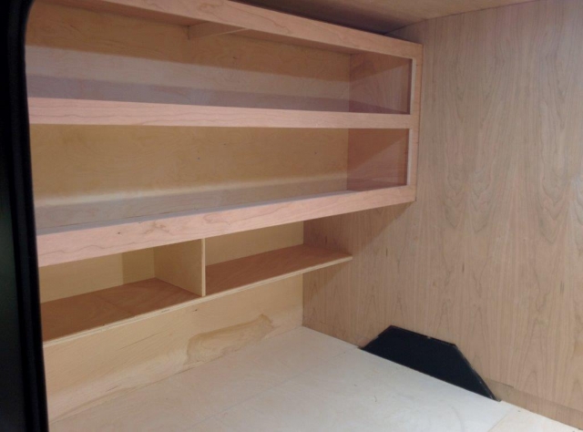

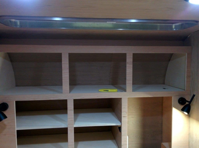

Postby Lambertdarr » Mon Jan 05, 2015 11:58 am
So, after finally figuring out how to do the water tank I have been able to complete the framing out of the upper cabinet along with the roof to that point. I have the hurricane hinge installed on the roof side just to see if it would fit properly!! The fridge is in and wired the counter raises up there for access inside. I cut a panel to hide it and keep it looking classy! I have to do the cherry veneer which i should start soon but wanted to get as much as possible done so that I could do all the veneer at once! After that it is the trim work and figuring out how I want to stain and seal all of it!! I have not figured out exactly where I am going to put the 12 volt ports, the 115 volt plug and the light switches

Postby Lambertdarr » Mon Jan 05, 2015 12:16 pm
I have all the Cherry done!! Now the walnut trim!!! It is going well!! To be honest my girlfriend cut and installed most of it!!
