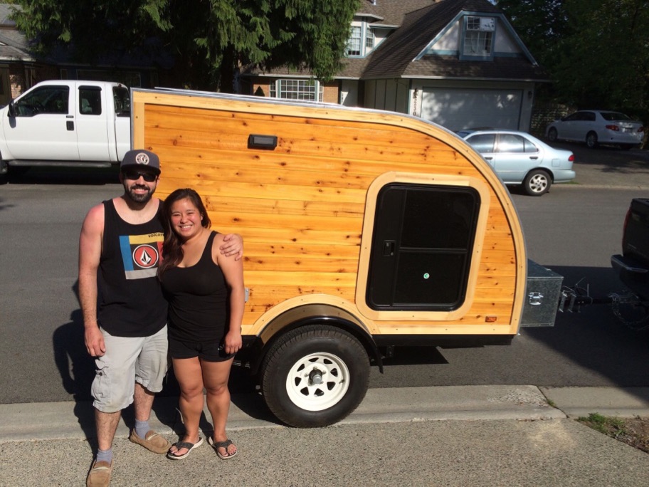

Here is our woodie style build all custom no plans. it has insulation in the walls, floor ,and roof 5x8' overall with 6' being inside sleeping area and the back opening up to a 2' full kitchen. It has a bar sink, upper cabinets and lower drawer pullout for both a cooler and a camp stove.
Full 30amp shore power and water hookup, 120v on demand hot water tank. Trailer is wired with both 12v and 120v it has led exterior lighting with interior led lighting for both sleeping area and kitchen.. 12v outlets and 120v outlets
The build process was long, we started with an old U built trailer from 1988.
We started April 2014 and we're still working on it almost a year later.
I'll start posting the photos of the whole process soon

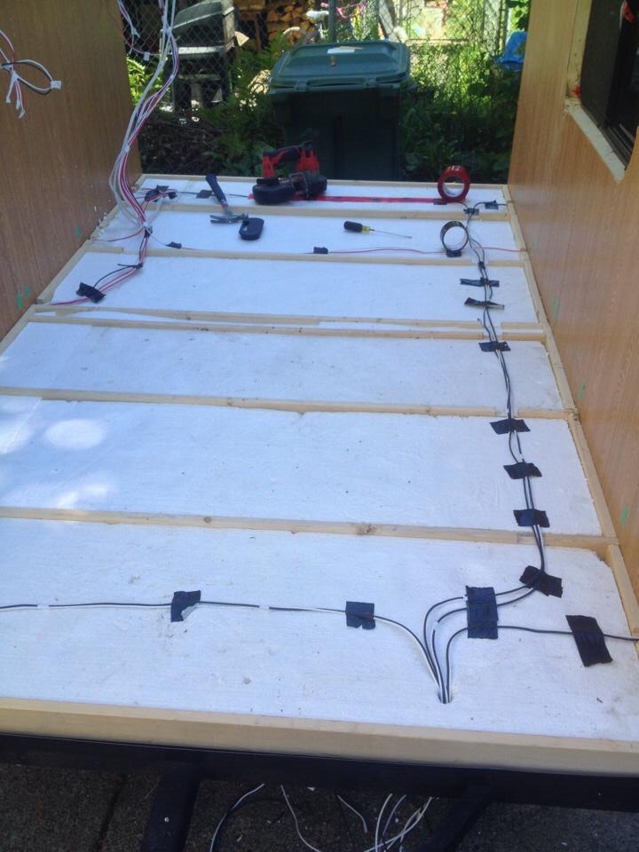

Here is the floor framed up 1x2 with foam insulation. Low voltage wires notched into the floor and tuck taped down. Everything had to be pre planned with the running lights, exterior lights, inside light, kitchen light and switches
The running lights were run to a central location close to the front to later be run into a box then connected to a female 6 dkdosoxoxkxoxoxox dkdkdkd

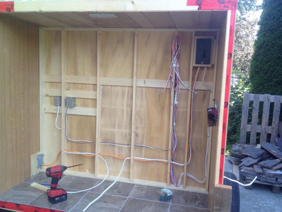

The wiring worked out great here. It all came together with the construction of the kitchen wall. Lino and everything worked out great.
Low voltage wiring and 120v wiring separated in wall and ran to the designated locations..
Kitchen mock up rough plywood and counter top installed.

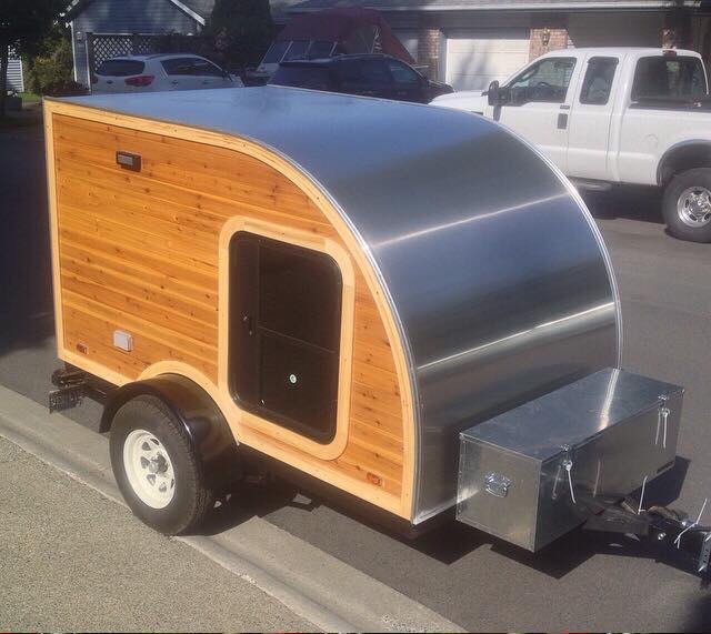

Postby wiseguydirk » Fri Jun 05, 2015 12:26 am
If you want to go down this route all I can say is good luck. So much time was spent using epoxy and clamping to make this arc.. I have seen a lot of people try and do angles and lap joints, but it doesn't come out as smooth..
My initial idea was to get a PVC deck board heat it up and bend it around a jig.. This would have made water proofing a lot easier. Adding this trim also made the trailer larger than 5'. So if you know about the aluminum trim this makes it a lot harder to get a proper seal. I
