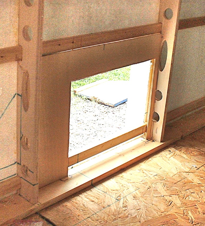

Eureka !! , think I’ve got it now .... only the top part where the angle bracket is , needs to be close to the wall ... the rest of the framing can surround the AC unit up close ... The unit will just push into the opening .. The top framing located slightly above the angle bracket to clear ..... Getting the wood out ... :dancing

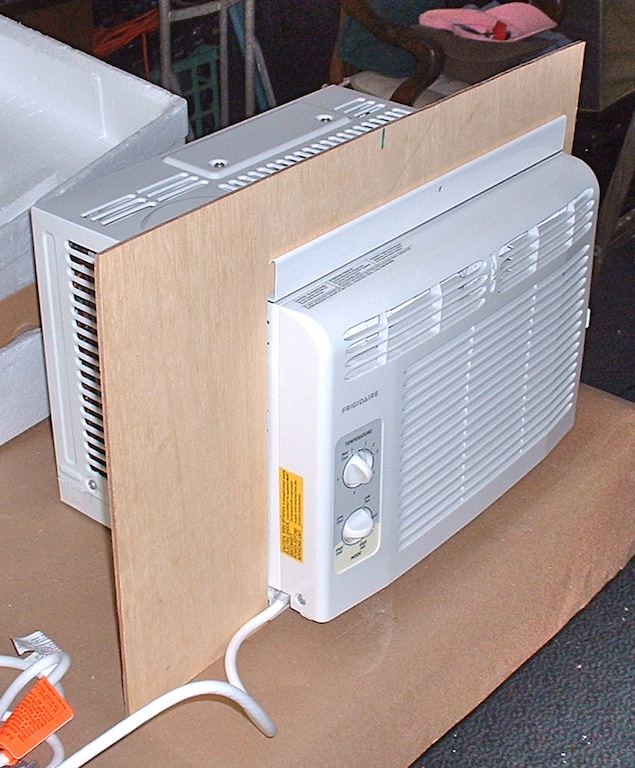

You may wish to make the bottom of the AC hole sloped a bit to the outside so rain water drains out, rather than puddles. Also look at what the AC unit expects for mounting.

Mel, the thing is , the AC won’t be riding in the trailer ... ever..., no need for sliding trays or other devices ... The AC will ride in the truck , in it’s little box . When we get to where we’re going , we just pop it in the trailer ... Much simpler for me to deal with ... Just trying to keep it SIMPLE ... ;) Around here it’s always warm , especially in EVAC season , so an AC is mandatory ... and at the top of the wife’s “must have list” ... :o
Bogo, the drain angle will be adjusted by the spacer I put on the floor , got that sorted. Thanks !!! :thumbsup:
Eagle , I guess this will be similar to yours, put it in when you need it ... If it’s cool outside , leave it at home ... 8)
The only thing I’m not sure of is the outside AC door ... May need to install some hard points in the foam (before we cover it) above the AC to hinge the door to ... Not a problem ...but we must do that Now ... could do it after the covering is on , but it won’t look as neat ... :thinking:

GPW wrote:Bogo, the drain angle will be adjusted by the spacer I put on the floor , got that sorted. Thanks !!! :thumbsup:
I was mentioning making the bottom sill of the AC mounting hole sloped out. That way any water that gets on it drains out. At some point water will get on it, either from rain water running down the unit's sides, or a spill over from the condensate drain.
I saw before that you mentioned tilting the unit for the unit's drains, but no mention of sloping the bottom of the mounting hole.

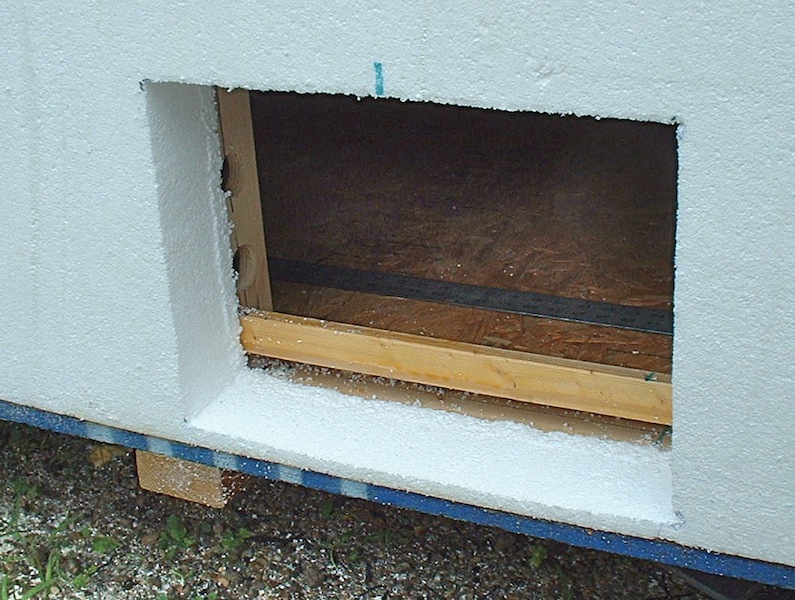

Back to the AC ... more pics of the hole , the plate and the fit ... so far ... :pictures:
Bogo, the foam slopes from 3/4” on the bottom plate to 0” at the base of the floor ...or will by the time we’re finished shaping it ... That should help eh ? :thinking:

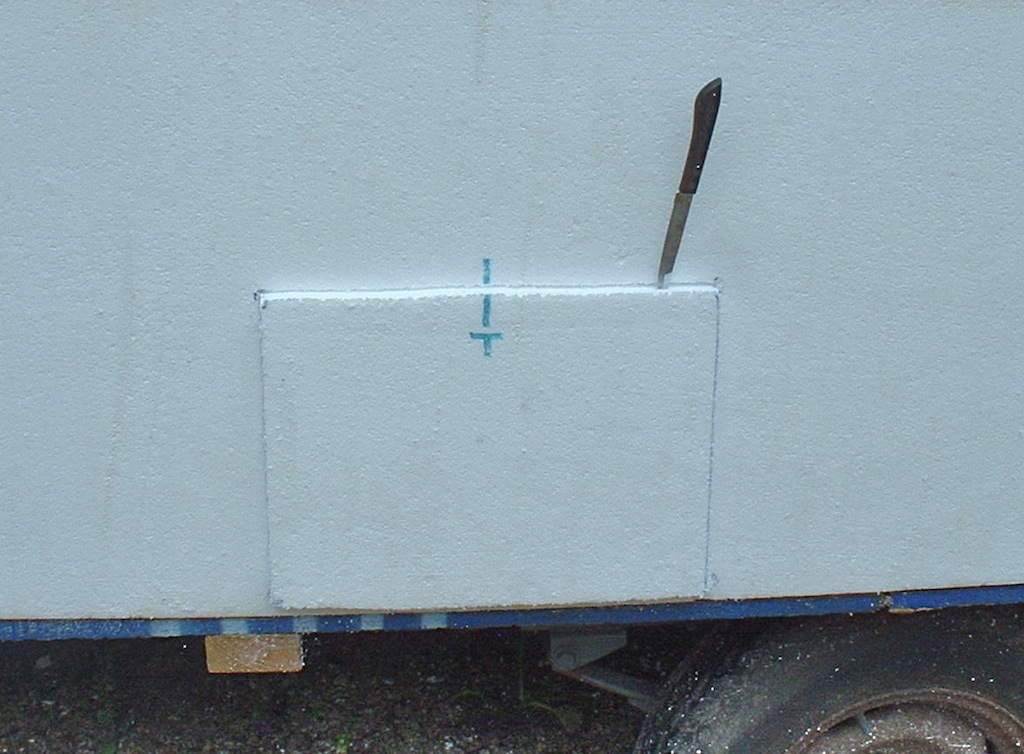

Postby GPW » Sat Jul 06, 2013 10:11 am
More :pictures:
Ps. I did cut out the hole with a jigsaw, and finished it with the serrated steak knife .... The Foamling’s most highly valued tool ... :lol:

Postby atahoekid » Sat Jul 06, 2013 10:56 am
I'm sure it was tough making a cut that size in a perfectly good Foamie wall. It was for me and all I cut was a three inch round hole for the water inlet. :frightened: :frightened: Looks like you got it right!! Measure twice, cut once and pray you did the math right! :o :lol: :D That's what I did! It's normally the math that gets me and I got A's in high school and college math. I guess I should have paid more attention in grade school :lol:

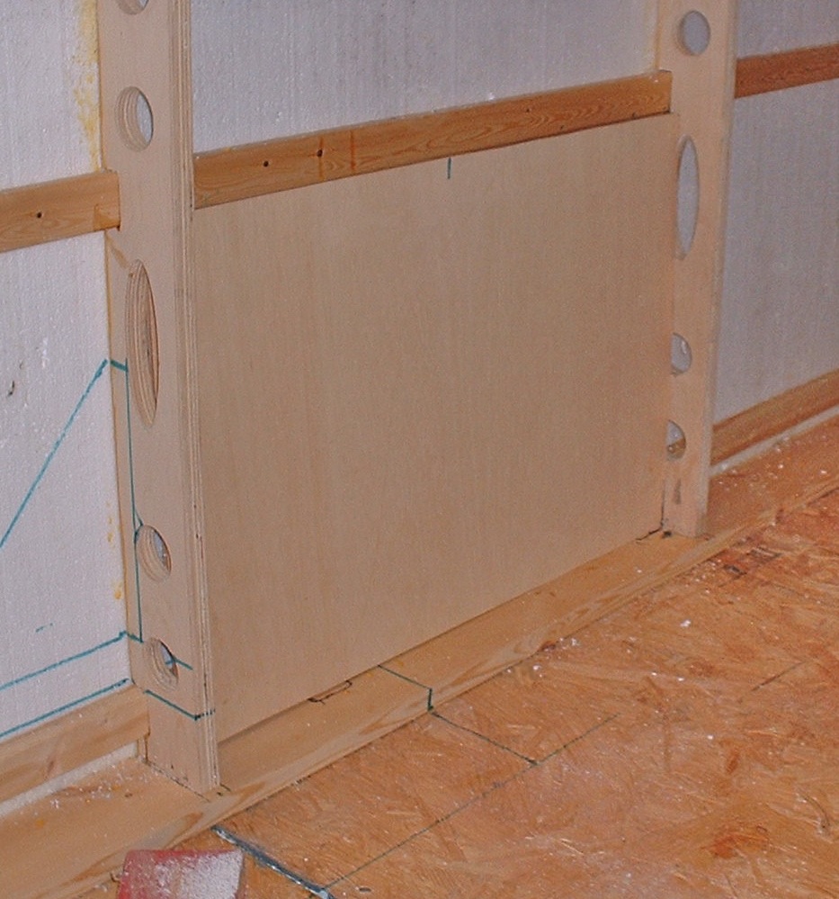

Postby GPW » Sat Jul 06, 2013 4:45 pm
Mel we never did worth a hoot in Math ... any time ... and have to measure three times , check it and then measure again ... just got Lucky this time ... 8)
Took the wife out to Lunch , came home , took a long well deserved nap , ready to start on the trailer .... and now it’s raining .... again ... :roll:
At least we can work on the framing of the inner wall plate .. get that done , and we can glue and screw it all in solid ... ready for a test fit of the unit ... then we can make the fine “adjustments “ .. :thumbsup:
