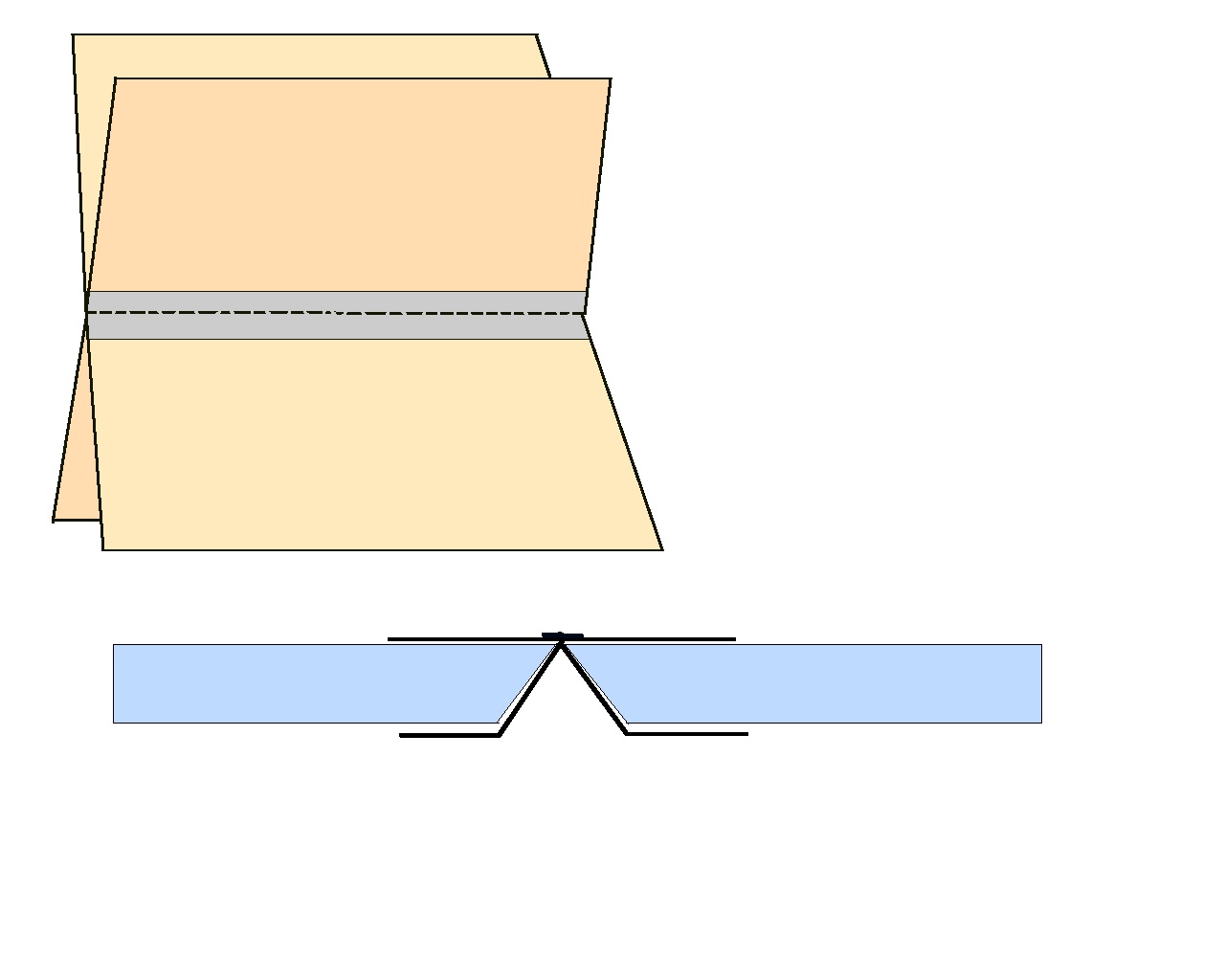

Living hinge... :thinking: How about taking two pieces of heavy canvas, sew them together across the middle with something strong like kevlar thread , then “rubberize “ that section ... install it as a hinge .. ? We’ve been using hinges like this on foam planes for years ... they never fail, and they don’t leak ... ... :thumbsup:
canvas hinge.jpg (61.46 KiB) Viewed 1598 times

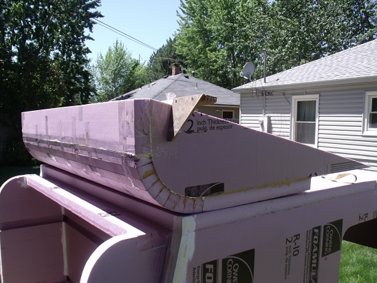

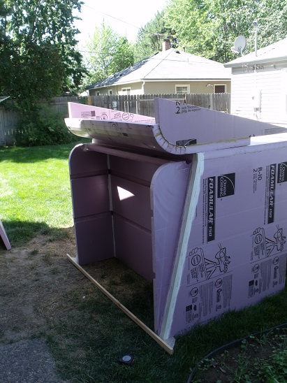

Working on the hatch some this morning.
Getting it straight
DSCF2129 small.jpg (135.4 KiB) Viewed 1583 times
New roof piece is installed.
Roof piece on
DSCF2130 small.jpg (132.48 KiB) Viewed 1583 times

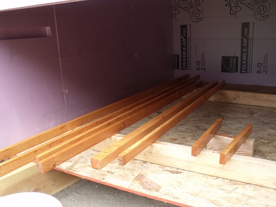

Next to bolt the frame rails back in. They came off to be stained and varnished. Now I need them back in to align the body to the floor.
Frame rails
DSCF2014 small.jpg (96.47 KiB) Viewed 1583 times

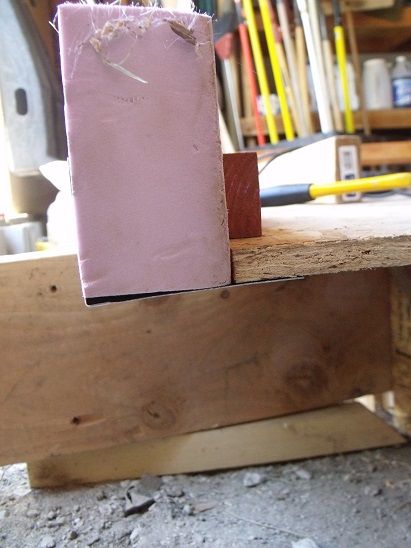

Postby ghcoe » Sun Jul 07, 2013 8:39 pm
Got too hot here to work on the foamie much. I did manage to get a couple frame rails installed and made my front wall extension.
front wall extender
DSCF2131 small.jpg (125.65 KiB) Viewed 1550 times

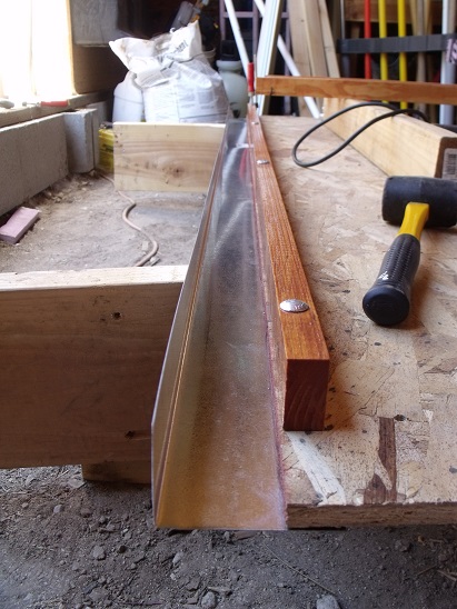

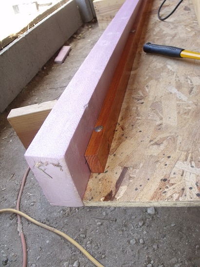

I used 2"x3" flashing to go under the floor and attach with the bolts that hold the forward inner frame rail in place. This will give a nice hard edge along the bottom of the front wall and will help hold the wall in place better than just gluing the wall to the OSB edge.
Side view
DSCF2132 small.jpg (119.84 KiB) Viewed 1550 times
With foam
DSCF2134 small.jpg (142.4 KiB) Viewed 1550 times

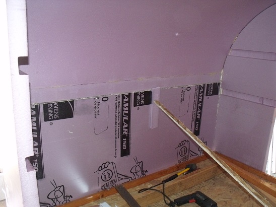

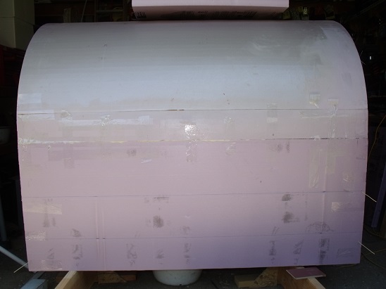

Postby ghcoe » Sat Jul 20, 2013 3:47 pm
Did a bit of work today. Got the last piece on the front.
Front
DSCF2140 small.jpg (70.73 KiB) Viewed 1469 times
Inside front
DSCF2141 small.jpg (98.01 KiB) Viewed 1469 times
One thing I notice while working today is that the foam on the front is turning color. Looking closer at it I realized that it was deteriorating from sun exposure. So keep your foamies out of the sun until you get them covered.
