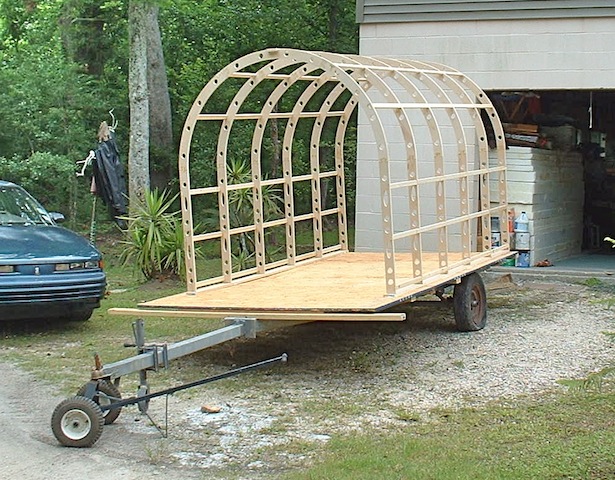

I put the call out , just waiting on some friends to come help me move the skeleton on to the trailer ... Should go fairly quick once that gets done ... ;)

Still stuck at the same stage of assembly , waiting for helpers ... :duh: While waiting , decided to Clean up the mess in the Studio ... Got an amp buddy in from Australia ( I make tube guitar amps too ) , don’t want him to see a messy yank' eh ... :frightened:
At least , the yard guys will be over tomorrow , so I can get them to help ..... Once the framework is on the trailer I can start attaching it to the floor and adding the foam ...up to 4’ high ... and then we have to do the kerfing’ ... :roll: :frightened: :NC I did the calculations , wrote down the measurements ... still “not sure” ....??? Have to make that kerf tool now ...
Got a nice new HF HD tarp to throw over it all to keep it dry while we’re getting it finished , outside ... :thumbsup:

Thanks Mel !!! The only problem so far is I’m doing it all by myself ... having to prop things up , square it off, clamp this , hold that ...I even screwed rib #1 to the loft wall and ran a plumb line ... With two people (the wife is Useless , Polish girl ! :roll: ) It would have been on the trailer already :thumbsup: ... The skeleton is just a too awkward to move by myself , it really doesn’t weigh that much , just @ 10’ long it’s cumbersome for one ... two people , no problem ! :thinking:
Toughest part was moving around those OSB sheets ... Pretty HEAVY stuff ... :frightened: Old muscles still recovering from that day I can tell you ... :o But that will keep most of the weight low on the trailer , low center of gravity ... since my trailer is a little taller than wide :o ...I dare say the floor (OSB @ 3 sheets 3/4” thick, plus the (6 ) 2X4s ) weighs More than the rest of the skeleton plus foam combined ... :shock: WAG, 195# just the OSB ... based on 2.5#/ sq.ft. and floor area Trailer and floor are already likely around 600# (guesstimating )... Luckily the shell/cabin will be much lighter ... Still shooting for < 1000# ... :beer:

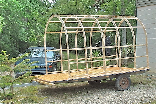

Ok, got it glued and screwed to the floor , and it all Fit !!! :thumbsup: Now a bit taller than I expected .. :o

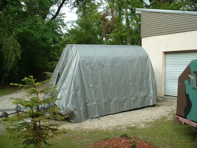

Got it all covered with my overly LARGE HF tarp .... Looks like one of those elephants they use as "roadside attractions" ... :lol: :lol: :lol:

Postby Wobbly Wheels » Sun May 19, 2013 5:40 pm
Lookin' good !
:thumbsup: :thumbsup:
I got that surprise too - downside of keeping the deck up high I guess...what looked reasonable on paper was a behemoth in 3D

Re: FoamStream...
Postby Wolffarmer » Sun May 19, 2013 6:32 pm
Some beer will help with the height problem. In more ways than one. :lol: :lol:
But looking good. 13 days until windy season.
