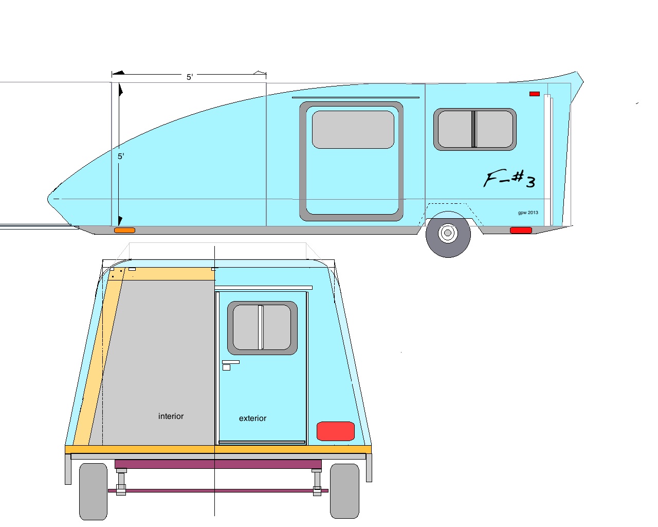

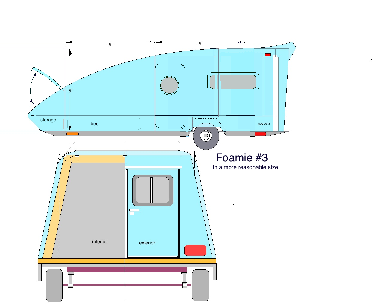

Thinking about #3 ... it seemed a bit long eh ? ... around 18’ ... :o so here’s a shorter more manageable size ... still @ 15’ it’s no small trailer ... :thinking:
Next step is to completely re-design it to fit a 4’X8’ sheets of foam ... Thrifty !!! :thinking: ... and we don’t want any leftovers , because then we’d have to build another one , and we’d be out of out of trailers ... :frightened:

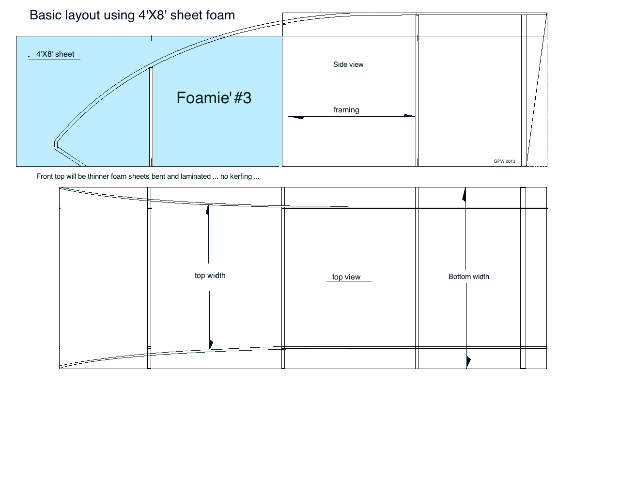

Here’s a basic layout drawing using 4’X8’ foam sheets .. Just seeing what will fit within those restrictions ... :thinking: Really like the way the top goes toward the nose and flares out wider ... That should look Cool !!! 8)
