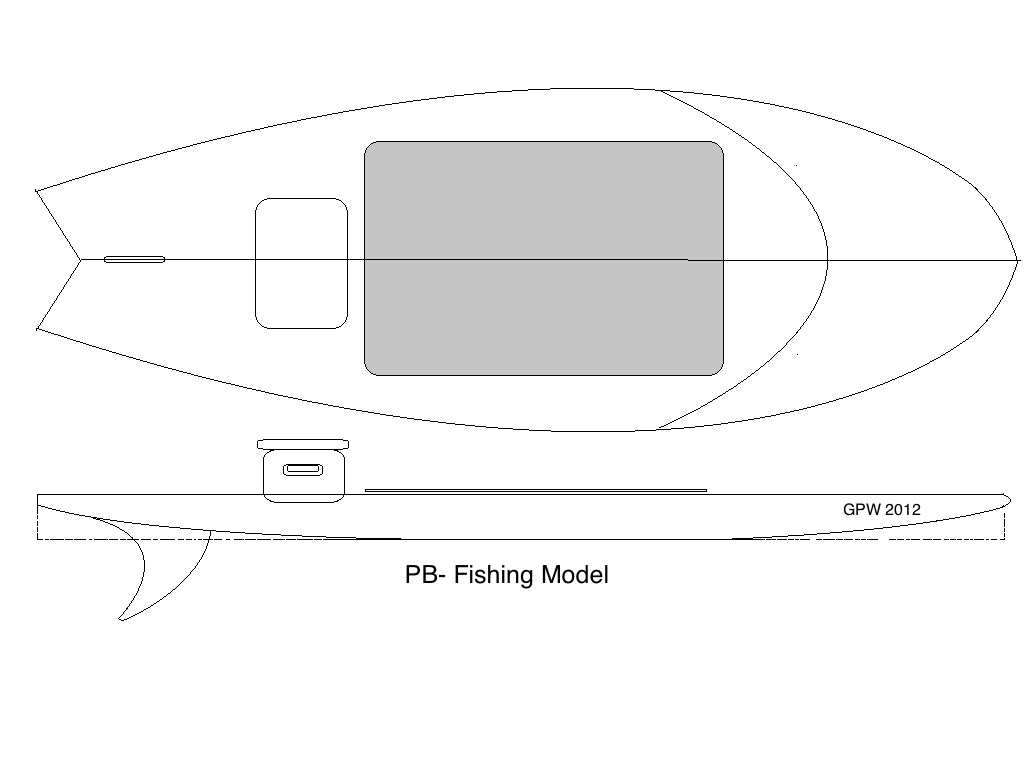

Of course I had to do a drawing ... just something simple for flat-water fishing .. ~40” wide for max stability (sans training wheels :lol: ) 12’ long , 6"-8” Thick ... “rocker” just hot wired in , rails just rounded , that’s it ... :o Or I guess I could glue several sheets of 2” foam together with GG and weight the center between two outer supports for some real “rocker”, then just cut it out... :thinking: Maybe just a simple canvas skin , No FG ...

+1 on attachment point for the paddle...and the tackle box...and the fishing pole. Little "U"-shaped cleats with two hole anchor points, that way you can use the small spring clips and lanyards for freedom of motion, or even cargo netting.
Don't forget a hand grab/tie down. The rotomold kayaks I've seen use a simple hank of nylon cord with a short plastic dowel or tube as a handle. Gives you something to grab onto when launching or throwing on top of your roof rack, and also a place to tie off in transport.
