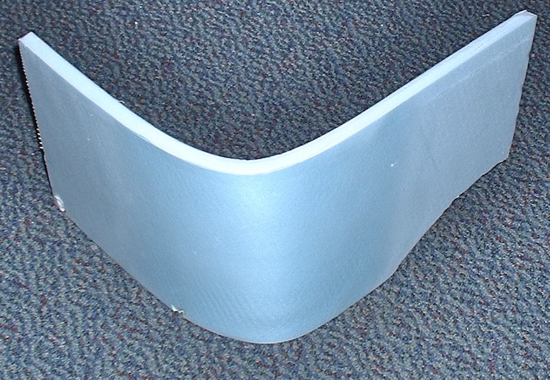

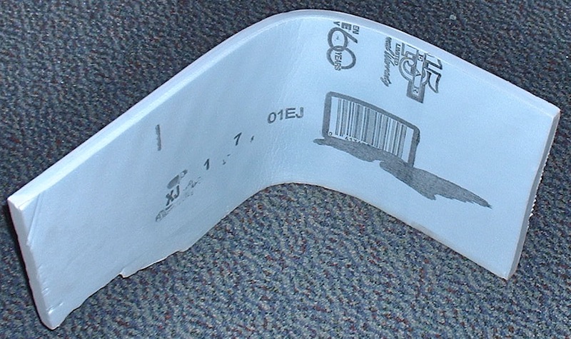

Postby GPW » Tue Sep 24, 2013 9:15 am
Jack , here’e the results of the 1/2” foam heat bending experiment ... scrap 1/2” piece on the table end held down with a brick , heating and bending free hand ... using my 400F Hobby Heat gun ... Would be easier /quicker with two heat guns heating the back and front simultaneously ... had to keep the heat moving so as not to burn the foam ... not that tricky ... ;)

Postby Jack B. » Tue Sep 24, 2013 10:55 am
Now that's what I'm talking about. Was that with the heat being applied to only one side or alternating sides? If one person was doing the work on a 4' X 8' sheet it could get a titch difficult trying to control the bend, the heat AND running from side to side to apply heat on both sides.
Getting curves like that is sure a great argument for building these things up in layers. It looks like a person could almost get some gentle compound curves going in the thinner materials. Might be a way to get a sort of rain drop type shape working. Say from front to back, inward and downward at the same time. Or how about getting say 6"-12" wide strips in a twist for getting different roof lines or wall shapes.
Now if the thinner sheets were to act like stained glass in a kiln, it might be possible to assist it into "slumping" into an arched quarter dome shape like the nose of the FS. Would perhaps have a ribbed cage shaped the way you wanted and then work the heat gun magic, top and bottom, while helpers slowly bend (slump) the foam onto the three dimensional formed shape. It would seem this could be possible on a larger project where the curvatures don't have to be too extreme. Once slumped into the shape needed you then would only have to trim the edges to meet up with the mating edges of the walls and roof. Do two 1/8 domes or maybe just three or four triangular three dimensional "slumps", glue into place, fabric strip the seams and then do your exterior fabric job.
Just letting the imagination run away with itself her, but it seems doable. But hey, what do I know? Now I think I'll go see if I can make a cat fly across the room and land in a pail of water. Thank you Monty Python for that last idea.

Postby GPW » Tue Sep 24, 2013 11:41 am
Jack , it really does take more than one person on a larger sheet , unless you have some type of jig . But it sure beats the heck out of messy kerfing ... at least the way i did it ... :roll:

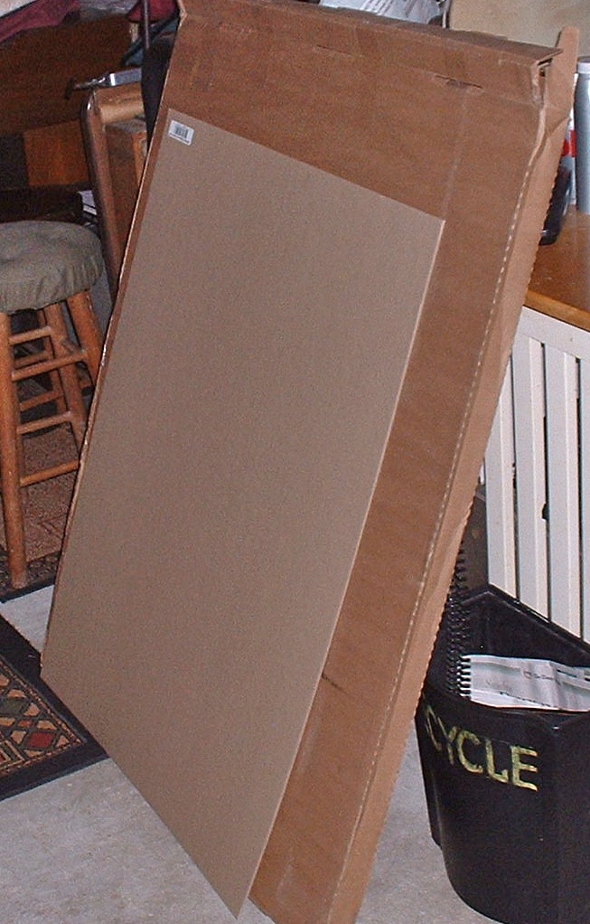

Postby GPW » Tue Sep 24, 2013 5:36 pm
Now we’ll be bending chipboard .... which just came from the PO (finally) ... :D 8) :thumbsup: :dancing

Postby GPW » Wed Sep 25, 2013 5:11 am
You don’t have to be retired to tell people to stuff it ... but it helps !!! :lol:
Here’s a piece of the chipboard .... nice and thick :thumbsup: getting out “the Mix” today and waterproofing the chipboard ... Then we’ll fit it to the inner nose , paint it and screw it to the vertical supports using some finishing washers ... ... :D
