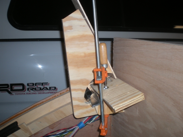

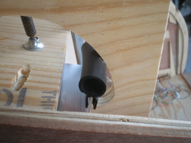

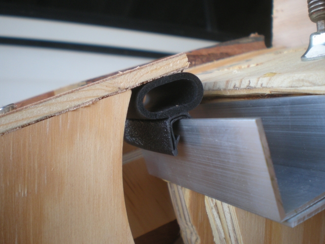

Or is it 5.0? New version today based on 3.0. Made room for a 1" aluminum gutter on top, plus I actually get more opening angle! :thumbsup:
Side view, with gutter:
Full open. I get almost 90 degrees! I'll need to design in a stop.
Here's the gutter peeking out right next to the side gutter:
Excellent squish:
It needs a little more room in the throat:
The gutter is improvised from 2 pieces of angle. 1x1x1/8" C-channel is what I want to use. Titebond doesn't seem to hold to aluminum.
This feels better than 4.1. We shall see.

Brad, excellent build and what a patience!! :shock: I would have given up and resorted to the typical method. :lol:
I must say person like you that have an ability to dramatically change the course of "how things are normally done". :thumbsup:
If I may, I would like to chime in with my suggestions.
1. Would it be possible to extend the hatch over the gutter and possibly add another seal on top side of the gutter to stop unnecessary water from going into gutter? I would hate to see water inside of hatch even though you have the seal. Once the water gets into gutter, only way out is into your galley if something goes wrong.
2. You may want to look into something like "F" shaped channel instead of making gutter from 2 angles. I still don't know how to turn the corner, but F shaped trim should give you a channel for water with a flange for mount.
I enjoy your progress very much and keep up the good work. :thumbsup:

Each step is a refinement. This latest version looks pretty good. :thumbsup:
Is the plan to leave the gutters exposed even when the hatch is closed, or will they be partially/mostly covered?
The design is not simple, nor particularly practical to build, and possibly a dismal failure waiting to happen, but then you already know that. I appreciate your soap box words as they surely indicate that you are accepting my comments in the spirit that they are intended, as a second set of eyes and a different perspective with the intent to help solve an interesting challenge... and you obviously have a well developed sense of humor!
Something to keep in mind that has tripped up plenty of people, water doesn't just run down hill like one might tend to expect (like Kahn in the Star Trek movie, that's "two dimensional thinking"). It can have momentum from falling or rolling down in a stream, and can run up hill when redirected, or be wind driven directly and/or by vortices. Might be worth a mock-up wet test to be sure that water running off of the roof doesn't shoot past the lower rear lip of the gutter. But then again if it is raining that hard you will likely close the hatch.
Any thoughts on the chosen size of the gutter (arbitrary based on available alum.?) and have you given any thought to pitching it toward either side?
Maybe I'm over thinking things, as usual. It is hard to turn the engineer in my brain to the "off" position.

ryuandwings wrote:If I may, I would like to chime in with my suggestions.
You certainly may. :ok:
ryuandwings wrote:1. Would it be possible to extend the hatch over the gutter and possibly add another seal on top side of the gutter to stop unnecessary water from going into gutter? I would hate to see water inside of hatch even though you have the seal. Once the water gets into gutter, only way out is into your galley if something goes wrong.
It's kind of a Zen thing. How do you keep water out of the galley? Give it somewhere easier to go to. So the gutter across the top will feed into the gutters on the sides, which will go to ground. I want to see if that approach works before I try more drastic measures. Remember, what I've done up to now is just mockup so I have a better idea where I want to go later. (Am I "mocking" my own design?) :laughter:
ryuandwings wrote:2. You may want to look into something like "F" shaped channel instead of making gutter from 2 angles. I still don't know how to turn the corner, but F shaped trim should give you a channel for water with a flange for mount.
That would be convenient. :thumbsup: Do you have a source? I've only started looking for stock aluminum shapes. I'm looking for a 1" high, 1" wide (maybe 1=1/2"?)gutter. I used 2 pieces of angle because that's what HD had today.

KCStudly wrote:Each step is a refinement. This latest version looks pretty good. :thumbsup:
Thanks, KC. I feel like this one's pretty close. :thumbsup: Of course, I said that yesterday about 4.1. :(
KCStudly wrote:Is the plan to leave the gutters exposed even when the hatch is closed, or will they be partially/mostly covered?
They will be partially covered, but open to the elements. It's the Zen thing I 'splained to Ryu. :)
KCStudly wrote: I appreciate your soap box words ...
You are exactly right. I appreciate all comments, and have taken no offense to yours or anyone else's comments. In my engineer years, I found that others have their own insights which may lead to a better insight of my own. A' la Brainstorming. Au contraire, (keeping the French lingo theme) keeping up this build journal wouldn't be worth the effort if nobody ever said anything.
KCStudly wrote:Something to keep in mind ... But then again if it is raining that hard you will likely close the hatch.
When you're "out there," you need to keep an eye on the sky. Plus I don't want some varmint (4-legged or otherwise) stealing my Cheerios when I ain't looking.
KCStudly wrote:Any thoughts on the chosen size of the gutter (arbitrary based on available alum.?) and have you given any thought to pitching it toward either side?
1" deep seems to work out pretty good. 1" to 1-1/2 " wide. Know any source for F-shaped stock like Ryu said? I want a standard size/shape. Can't afford a mill run. :roll: I have thought about how would I make it high in the middle, but :lightbulb: maybe just to one side... :thinking:

I'd keep looking for stock forms and not fab the gutter. Something
that long is difficult to make and place undamaged in sheet goods,
especially with the tension of the gasket.
:thinking:
How will you join the side gutters to the top section?
