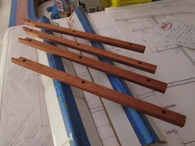

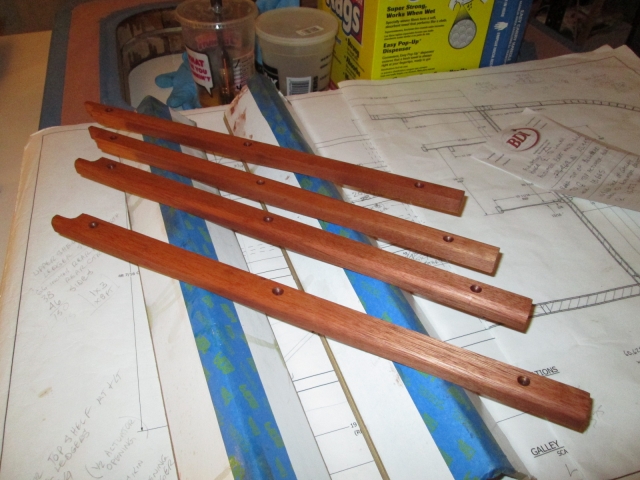

I started by doing a stain comparison on a scrap of the Red Grandis cleat stock, "natural" on one end and the red chestnut on the other. Not sure it was a valid test since the pigments in what is left of my tub of red chestnut have settled out and clumped into a grainy paste like substance; wouldn't go into solution anymore, so I will have to pick up another quart.
I unscrewed the outer galley shelf cleats from the bulkhead and did a little more sanding to get those ready for stain. They won't ever match the maple, and they don't take the dark stain as well as the Okoume does, so I gave some thought to painting them with the gloss black trim color. This would have the added advantage of being an easier finish to apply, just one or two no fuss coats. Still undecided.

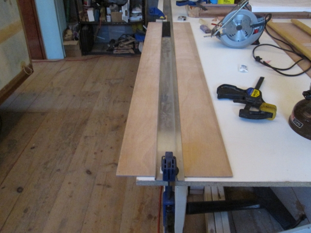

Next I cleaned and oiled the blade on my skil saw. Then I used the extruded rip fence and the skil saw to rip the edges of the galley upper shelves to final depth (front to back dimension); avoiding using the terrible table saw. Had to tweak one of them slightly with the Surform rasp to get the final fit just so, with a little bit of float. The second one went better and fit perfectly on the first try.

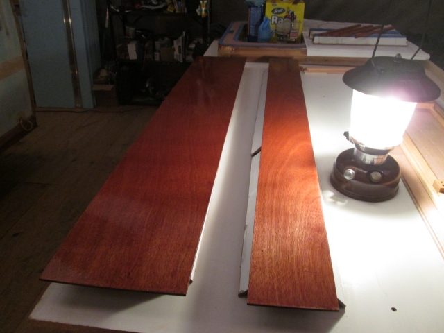

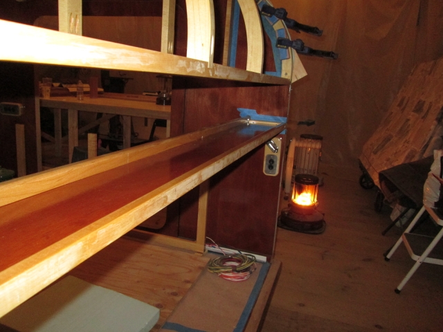

Here’s a pic I took last night of the ripping set up for the galley shelf panels.

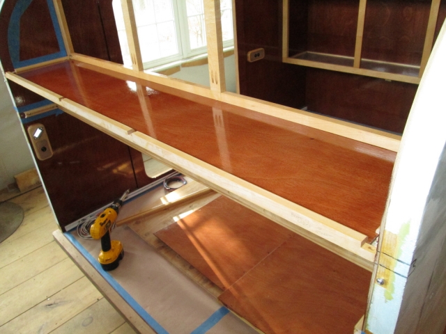

Today was another long grueling day at work, but I managed to force myself to swing by Ho-De-Po for some more stain and put in about 1-1/2 hrs at Mecca.
The galley shelf cleats took the fresh stain much better. First pic is w/o flash, second is with.

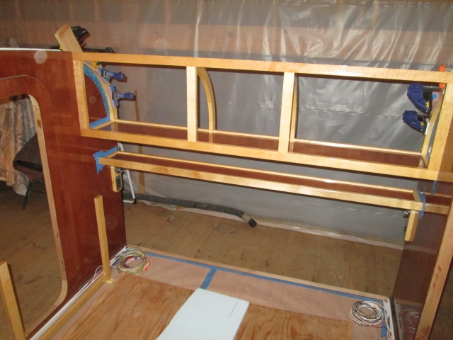

I finally got back around to the front cabinet floor and the key catcher panel. In the course of fitting these into the ledgers multiple times, I decided to trim a skim cut off of the length (width of cabin), so I touched up the stain on the cut edge. The cabinet floor had that blotch that needed another coat of poly, and I thought the key catcher needed another coat on one side, too, but when I looked to see which side it was I couldn’t tell the difference; so that piece is done other than just touching up the trimmed edge with the hobby brush.
Worked the cabinet floor over with 220 grit, then 320, then wiped it down and laid the last (?... hopefully!) coat of poly.
Doesn’t seem like much, but it is something.

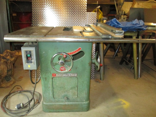

Spent all day Saturday running errands, using the Charcoal Briquette to go get a Powermatic 66 Uni saw (2hp, 3ph motor), getting it unloaded (Karl’s fork truck), and going over it. It’s a good old cast iron top, closed base, tilting arbor 10 inch saw. (All that and I didn’t take any pictures. :? )
It’s a bit of a clunker and needs 3 phase power (less popular with home owner hobbyists) so I got a great deal. Needs a little TLC, but I have that. Needs new belts, but the ones that are on it should work until I get new ones.

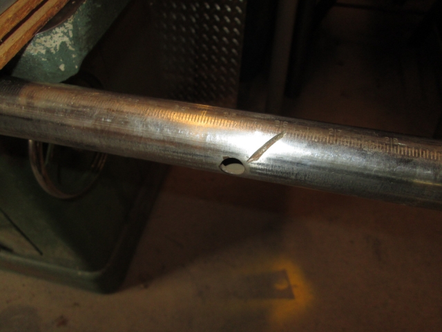

The boss for the pinion gear on the rip fence clamp casting (the fine adjust on the rip fence) was broken, so the seller removed it and included the fence and casting from another, newer, saw. Unfortunately the location was very dimly lit and I didn’t check the swapped fence very closely; the pinion gear is frozen in the casting (soaked it with WD-40… we’ll see), the pinion gear teeth are stripped, and the extruded aluminum portion of the newer fence (along with the rod that actuates the far side clamp) is an inch too short. The round guide rails for the fence are held away from the edges of the table by concave washers and one is missing, but all of the special bolts are there and I can fab a new washer easily. I spent a fair bit of time cleaning the top and rails, and disassembling the fence to learn what was what.

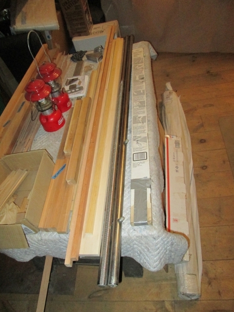

When I got home I did some research and found that the extruded portion of the fences are available NOS, if you can figure out which is the correct one. Also, lots of people have upgraded, so there are a lot of ‘take offs’ for sale, as well. I considered contacting the seller again and seeing if we could swap back just the fence and far end clamp, but that seemed just as difficult, and an hour drive one way.
I worked all day today (Sunday) at my day job with Larry (my lantern picker buddy at work) and he is pretty sure that he has the correct fence with extended rails (from a saw that he upgraded), and is willing to offer them up, so I am hopeful that it is the correct length fence. Apparently there are 27 inch deep tables (which seem to be common) and 28 inch tables (like mine). He believes that the washers on his were significantly thicker, so we are hopeful that his fence is the correct length for my saw with the thinner washers; perhaps a transition point in the designs year wise, or the extended rail option was made universal(?).
Anyway, we were both too beat from 9 hrs on ladders to go look at it after work, so he will bring it in during the week for me to check out. Deal.

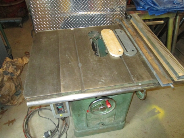

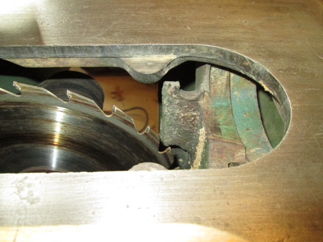

Here it is, the Powermatic Model 66 Unisaw. It’s one of the early “vintage” units with 3 drive belts.
Heavy cast iron top.

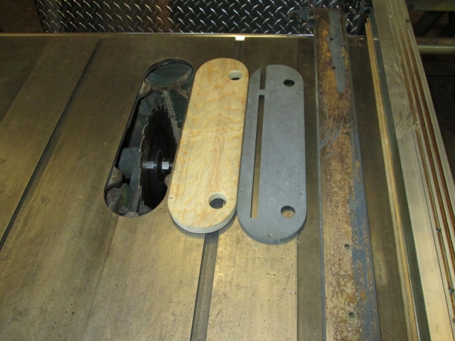

The top needs to be realigned slightly for the die cast OEM insert to fit properly, and the insert may need to be sanded a tad to fit the recess; must have come off of another saw. The plywood insert started out as a rectangular chunk that I grabbed to toe the saw to the front of the UT on the trip home. It just happened to be the perfect width and about the correct length so I rounded the ends over on the band saw and drilled some finger holes with a Forstner bit as a start on a zero clearance insert.

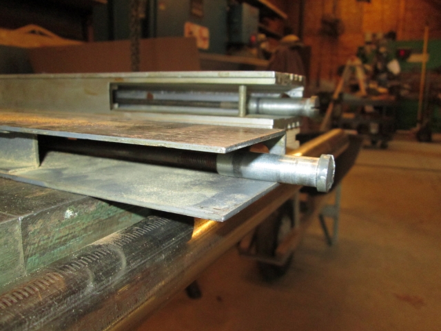

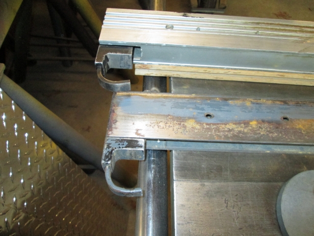

This is the end of the fences where the front cam clamp castings attach. We took them apart to investigate options for making them longer; 28 inch table, 27 inch fences. You can see the special female bolts that pull the clamp rods when the cam lock is engaged.

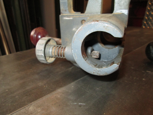

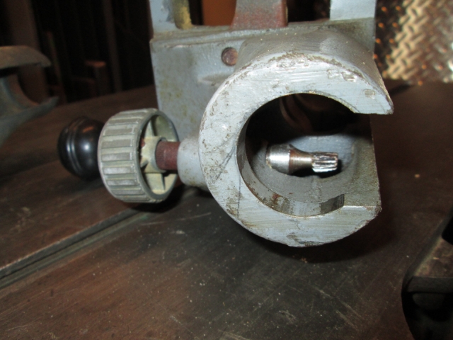

I didn’t get a good overall pic of the fence latch casting, but here you can see the one that the seller included. The rusty shaft with the aluminum knob has a small pinion that you are supposed to be able to push in to engage the gear rack on the underside of the front fence guide rail, allowing it to fine adjust the fence. The shaft is frozen in the casting and the pinion is wiped out.
Here is the one that Larry gifted. The pinion shaft turns freely and it has a lightweight spring that disengages the pinion from the rack when you let go of the knob. Also, the pinion is in great condition. Not visible, it also has a small spring to move the locking bar off of the rail when the cam lever is freed. The other one is missing this spring and, not surprisingly, the locking bar is worn down from dragging on the fence to the point where it no longer clamps tight. Plus the red knob is cooler than the black one.
Not unlike the fender on The Charcoal Briquette, someone used the table saw as a saw horse and ran a skil saw into the front fence guide rail.
Nestled in with some other stuff on this table you can see the longer guide rails that Larry provided. These will allow me to make a table extension to allow ripping much larger sheets.
The blade is junk and here you can see the threaded hole that is broken out of the main carriage cradle casting. I think this may have been the mount for the riving knife on the earlier saws, whereas the later saws mount the splitter from the rear with the guard and just clip into something else on the cradle. We plan to attach a vertical splitter to the zero clearance insert and are keeping our eyes open for the guard parts. I have seen the cradle castings for sale, but they do not have this feature (must be from newer 2 belt saws?).
We did plug it in the other night (using Karl’s 3 phase convertor), ran it up, and she runs good and quiet. We could hear a little electrical hum out of the switch box; not sure if that is anything. I did some digging around on the net and fed some links to Karl. He has already ordered new belts and worked out a deal with a seller for a vintage miter gage.

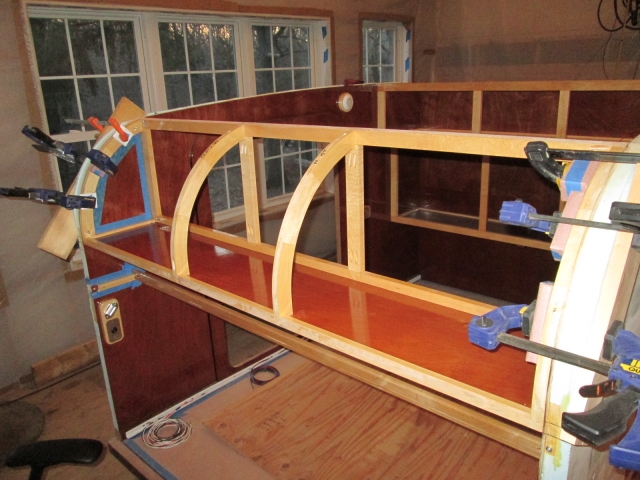

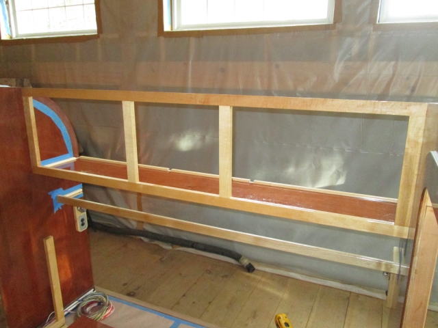

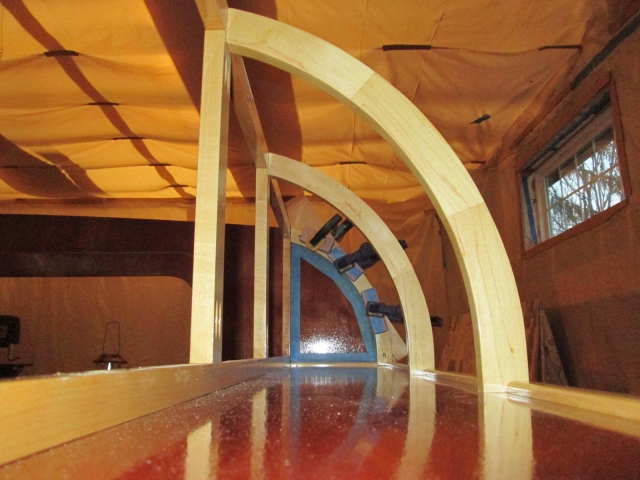

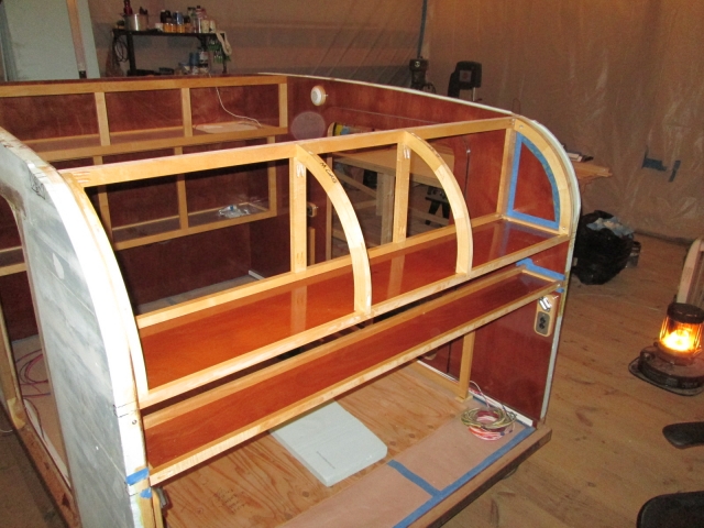

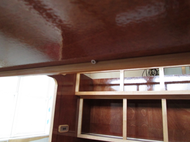

Tonight I made some great progress on the camper build, with a small milestone achieved; the front cabinet, riblets and key catcher shelf are finally installed.
Here the front cabinet floor and ledger have been permanently installed.

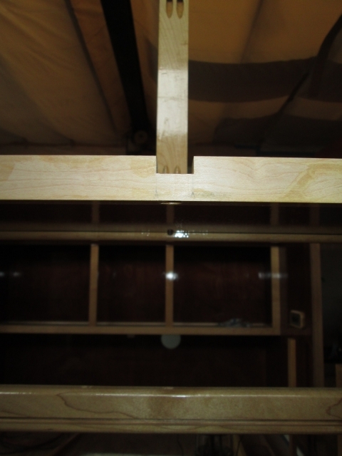

As with the other cabinets, I drove a couple of screws up thru the panel and into the face frame to pin the panel into the groove and prevent the face frame from flexing away from the panel.
Here you can just see how the screws line up between the pocket screws into the face frame stiles.
The dark dot to the left of the flash glare is the screw head (not a great pic).

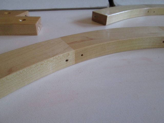

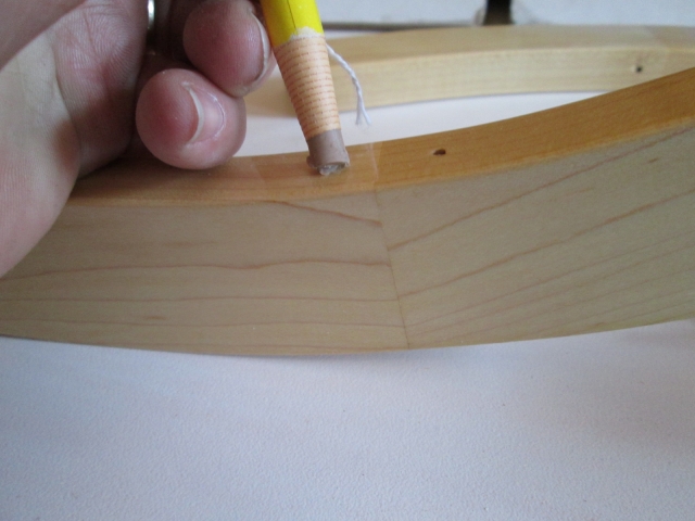

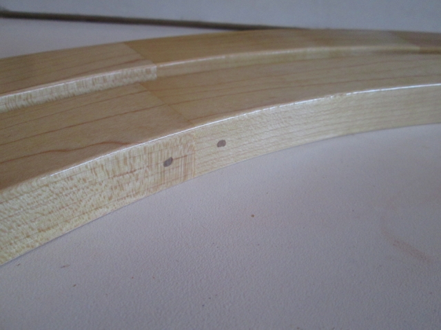

Next is a mini tutorial on using a putty stick to fill screw holes. I have found that wood filler does not take stain well at all. So I have been using the Minwax colored putty sticks to fill some staple holes and whatnots. The putty is waxy and will not take finish, so I waited to apply it after all finishing is done. I haven’t had to fill any of the maple yet, and I wasn’t sure how well the lightest shade would match, but I needed something to fill the holes in the riblets left by the screws that I used with the spring clamps when I glued up the riblet blanks.
The color match could have been better, but it is better than a dark hole, and I have to keep reminding myself that it is the inside of a cupboard.

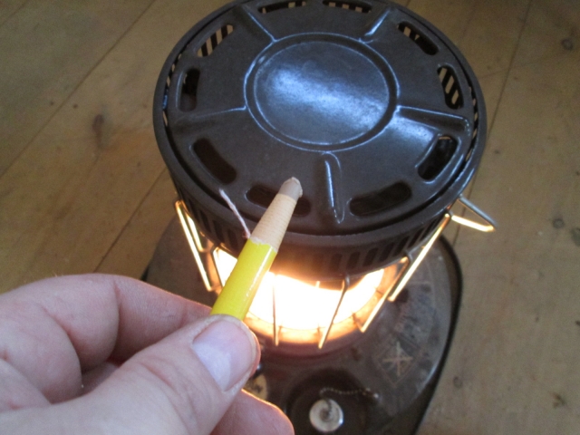

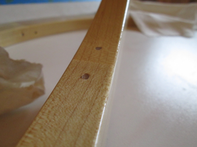

Here are some extra details on how I did it. First, the heat was still coming up in the loft so the putty stick was hard. So I ended up holding the tip of the pencil over the heater enough to soften the end.
After doing a couple I found that if I rolled it back and forth between my fingertips I could form a sharp point that made it easier to get some of the putty down in the holes.

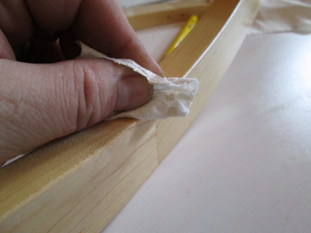

Over fill the holes and press down hard with your finger to make sure that the putty is going into the hole and not just bridging over.
Next I buffed the area with a clean soft cloth (or paper shop towel) until all of the smeared wax was gone and the shine of the poly returned.
This leaves the putty in the holes slightly recessed, but I’m good with that.

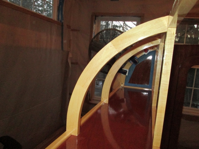

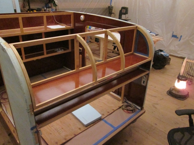

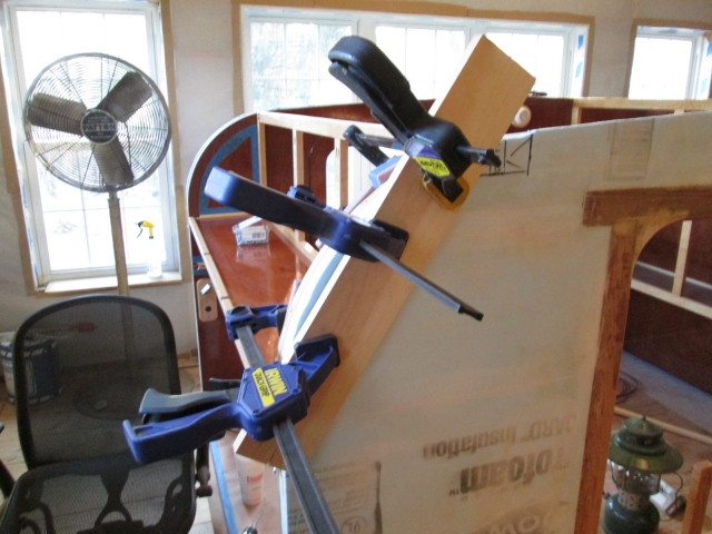

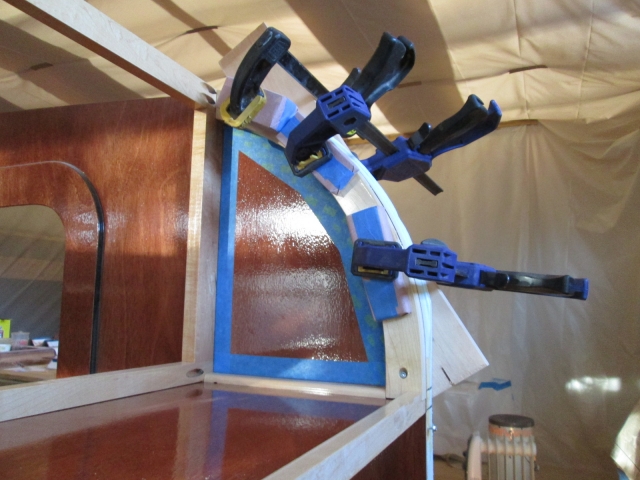

So now, after scuffing some excess poly off of the raw glue areas, the riblets were ready to install. Here is the street side riblet glued, screwed, and clamped (with a backer board to protect the foam and rosin paper wrapped blocks to protect the wood finish).
Curb side was done the same, and the middle ones were just glued and screwed at their ends.
Finally, I installed the key catcher shelf panel and ledger, pinning the panel to the face rail and just gluing, and screwing the ledger into the side walls (all of the panels are allowed to float in the grooves except for where they are pinned; no glue joints to pop).
Milestone achieved.
