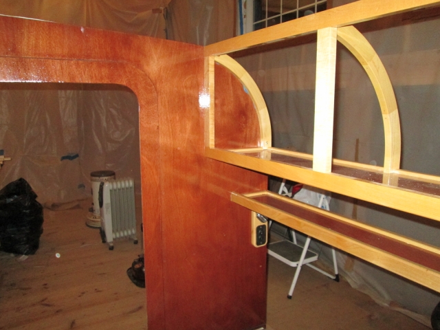

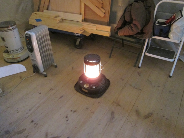

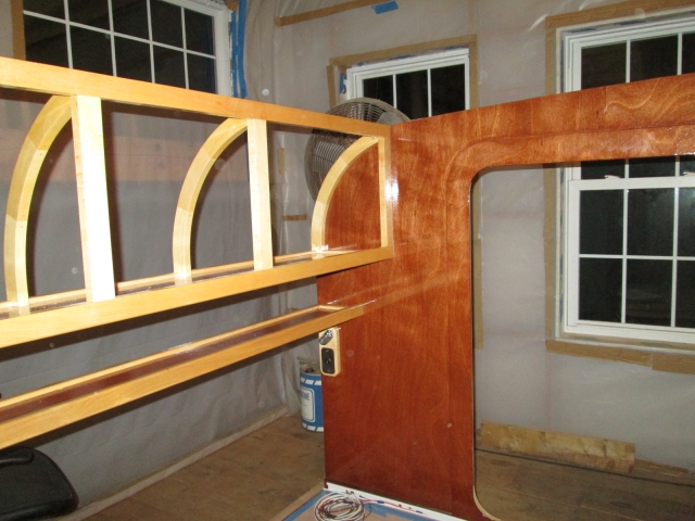

:o So after working over 1-1/2 hrs I still went out to Mecca and put another 2-1/2 hrs in.
Started out by cleaning the wick on the little kerosene heater. It had been sending out some licking flames and sooting up the glass.

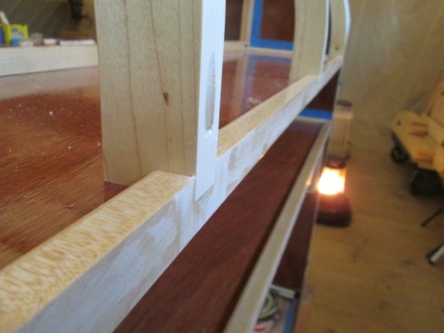

Despite having dry fit the riblets, some fine tuning still needed to be done to get back to fair after gluing. I wanted to make sure that all of this is fair so that there aren’t any gaps when the ceiling panel goes on. Here I have used the little matchbox plane and sanding block to fair the bottom of this riblet to the ledger.
The side riblets ended up just a hair under the inner wall skins, so I shaved and sanded them just a tad. Here is the street side.
I took a piece of the 5mm ply with the outer ply grain running across and did a test bend over the small profile radius; IIRC it is about 13-1/2 inch R. Had to use the timer feature and prop the camera up on some shims to get these shots. The minor gaps should pull out just fine when the skin is fastened properly. Only minor creaking of the test piece, so if I go slowly with the real deal full size piece I think I can make the bend without too much trouble.

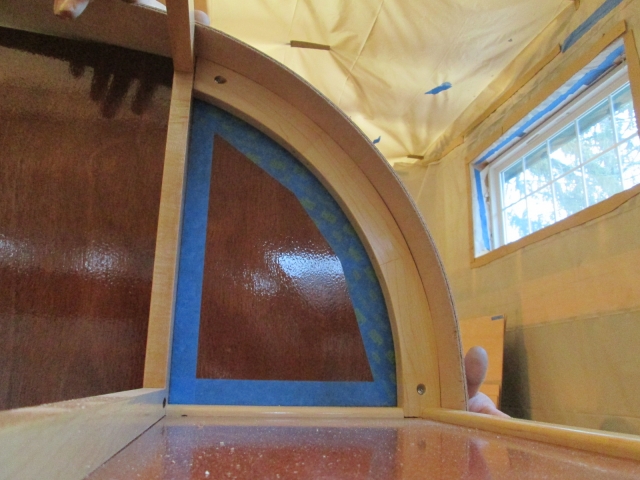

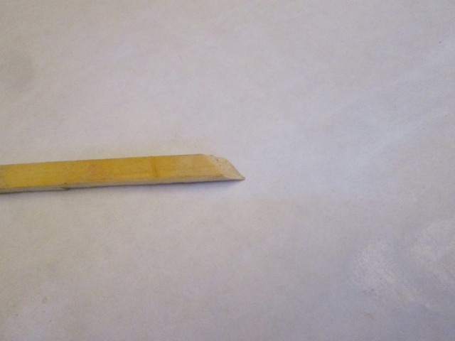

Finally, I spent some up close and personal time peeling blue tape. Rather than risk scratching the finish picking the tough spots with a razor knife, I made this little compound miter tipped wooden stick. Using a hair dryer for gentle heat, it really helped get under the edge of the tape where I couldn’t get my fingertips into the tight corners, and I could get pretty aggressive with it without damaging the poly. I still had to use the knife in a few spots, but a lot less than without the stick. I just kept the small sanding block with 100 grit paper on it handy, and used that to sharpen the stick periodically.
I wanted to get all of the tape off of the front, and I nearly did, but it was getting late and I was getting a little sloppy working in the awkward positions, so I left a small bit inside the street side riblet to get the next time. Still, you can get a better idea of the finished product from these pics.
Don’t mind the dusty shelves. I’ll give everything a good dusting off before the roof goes on.

I would have never thought to make a special tool to take off blue tape. It was the razor knife or fingernails or nothing... You simply amaze me!

Mel, I guess the stick just seemed like a solution to a problem. It’s funny the things which are meaningful. Scientists have observed apes using twigs to fish ants out of ant holes in the ground, too. They were impressed to learn that man is not the only known species that uses tools. Opposable thumbs come in handy that way, but sometimes they are too large to get the job done! Thanks for the kind words.

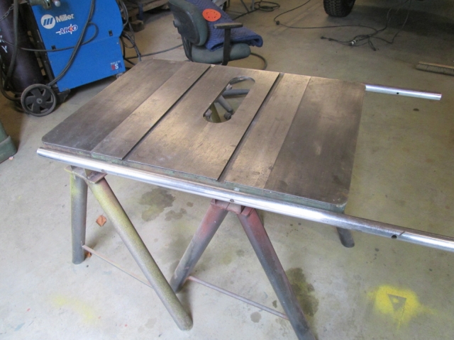

Here we go on a slightly off topic tangent while I take you thru what Karl and I did today to tune up and recommission this grand old saw. It will contribute useful work to the build, so it is relevant in a way.
So after zonking out much earlier than usual for me last night, and sleeping in a lot less than I would normally on a weekend, it was up and out before 8:30 this AM. Picked up Karl for the ride, stopped for coffee and a breakfast sandwich at a podunk deli/convenience store we frequent and then hit the road to do the “rip fence swap back”.
“I wish, that, I knew what I know now, when I was younger” – Ooh La La, The Faces
I have learned a lot about these old American made vintage saws and the variations between eras and brands of similar makes. It’s so hard to make a thorough assessment in just a few minutes with no prior knowledge in a dimly lit room… but in the end, we did okay!

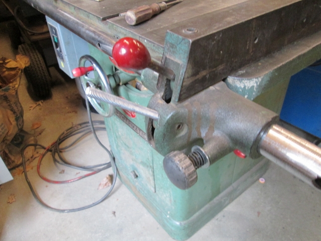

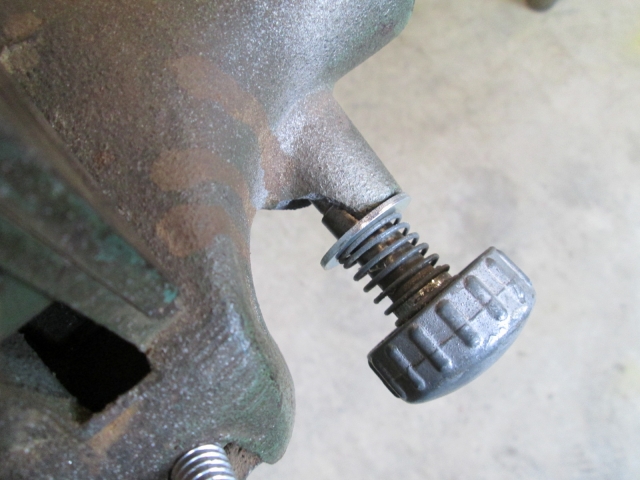

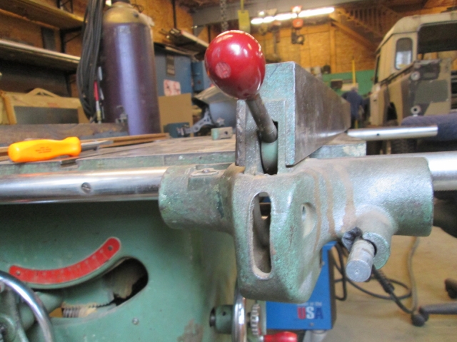

As soon as I saw the original fence again I could see many of the differences. The early ones had separate levers for the front and rear clamps, and the ‘T’ casting, although similar to the other, presumably newer ones, really isn’t the same. They are not interchangeable. This one has a single recessed socket head screw for each the ‘T’ and the far end clamp mechanism, and the far end clamp is actuated by a larger diameter push rod, rather than the smaller pull rod on the “newer” ones. That, and the fence body itself is also cast iron! This thing is HEAVY!

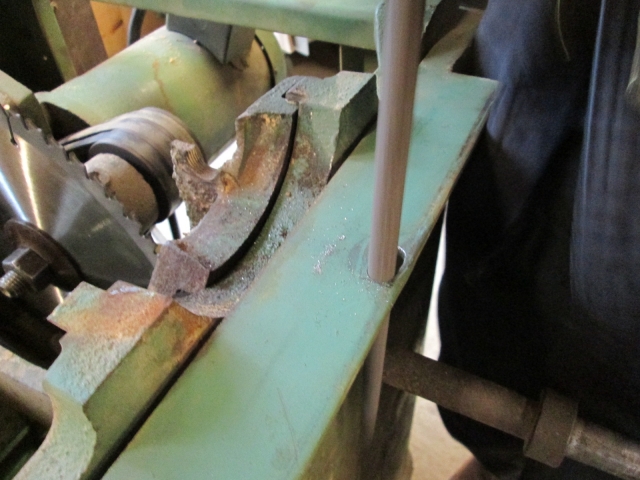

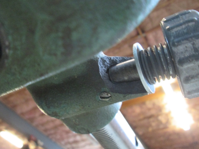

Karl and I more or less came to the conclusion that the saw had been knocked over and fell on its face. The small adjust pinion shaft casting boss was busted, the pinion shaft was bent, and the lower near side fence clamp lever was broken off clean at the threaded end with the broken end stuck in the cam. That, the flattened fence rail on the left front end, and the fact that the table top bolts were later found to be kind of loose, all lead us to believe that the saw had been dropped, or at least flopped on its face.
In order to get the broken stub of the lever out of the clamp cam we had to drive out both 3/8 inch roll pins; one to move the clamp dog with its return spring and spring locating screw out of the way, and the other for the cam itself. While I worked on the fine adjust pinion shaft, Karl was able to extract the stub from the cam and grab a piece of threaded rod to use (temporarily) as a replacement for the near side clamp lever.

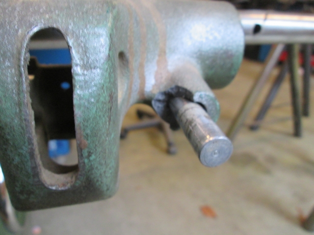

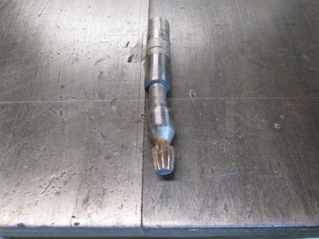

Meanwhile, I removed the set screw that retained the fine adjust pinion shaft, pulled the bent shaft and attempted to straighten it.
I was able to get the shaft pretty straight, but the pinion still ran out quite a bit and it ended up breaking before I could get it to a useable state. Fortunately, the one in the fence that Larry gave me was identical, so I swapped it in, complete with the return spring. I added the washer to keep the spring from fetching up on the jagged edge of the broken casting.
The outer portion of the shaft is no longer supported, but the feature works again, quite well.

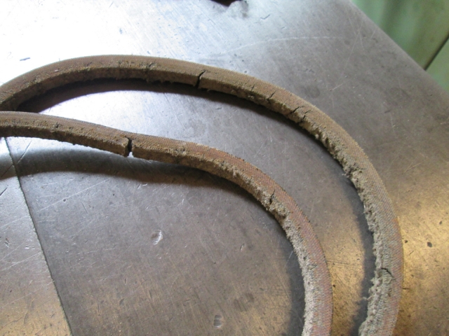

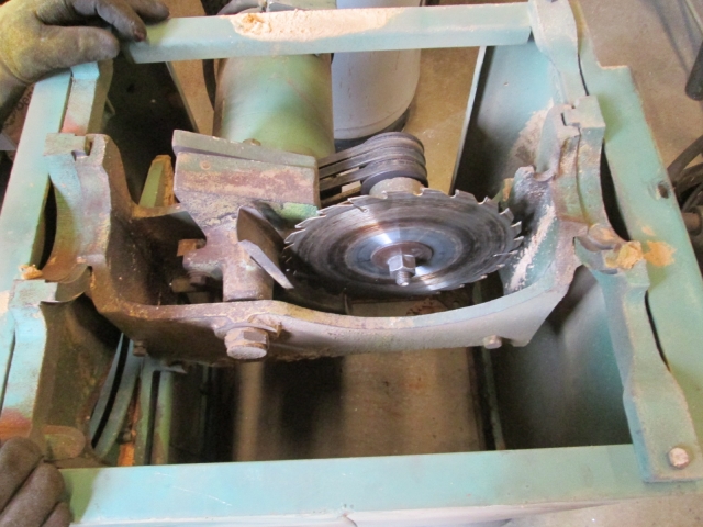

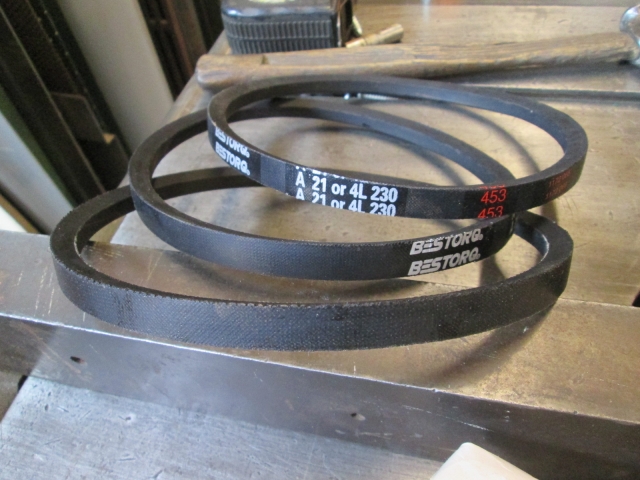

Although not necessary to change the belts, since the table alignment needed to be adjusted to work with the std. insert anyway, we went ahead and took the table top off so that we could better assess things.
Here are the guts in all of their cast iron glory.
Having the top off made it much easier to locate and remove some wood splinter debris, clean and lubricate running surfaces, and change the belts.
Old ragged belts.
Nice new belts.

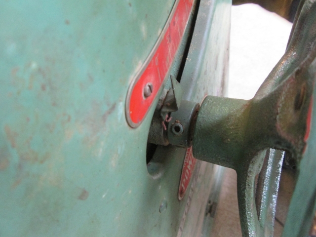

Karl had noticed quite a bit of backlash in the blade height adjustment, and while tightening the belt adjustment bolt on the motor carriage I noticed the blade lifting and dropping about 1/4 inch. So by resetting the shaft collar (located between the hand wheel and the tilt position indicator tab in this pic) we were able to take the play out.

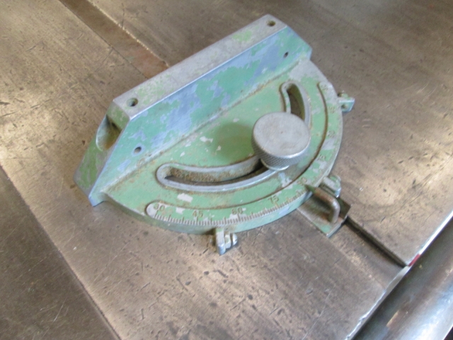

The vintage miter gauge that Karl bought arrived with the belts as we were pulling in from our road trip.

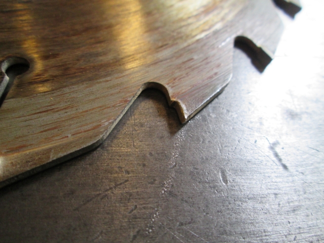

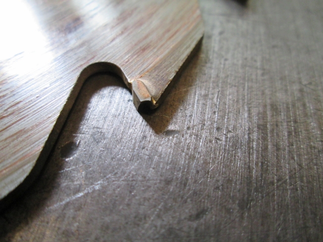

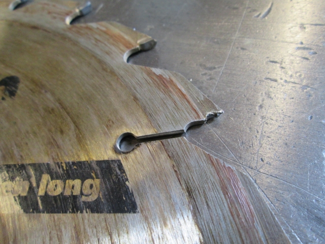

Besides having visible run out and being badly scuffed, the old blade was missing a couple of the carbide teeth and had chunks missing out of a few others.
We needed some set screws to replace the missing ones used to jack the table insert flush to the table top, so we ran down to the local hardware store and Karl ponied up for a new blade, too.
Karl had been reading up on the preferred saw blades, with some really high dollar ones guaranteeing 0.002 inch max run out. When we checked this one it was +/- 0.010 and was readily perceptible to the naked eye when turned by hand. I guess that must be pretty normal for a “good” (not excellent) blade.

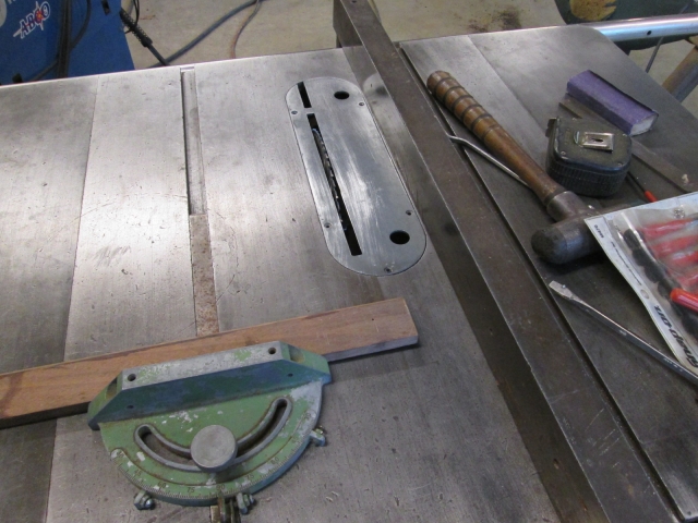

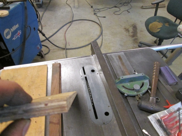

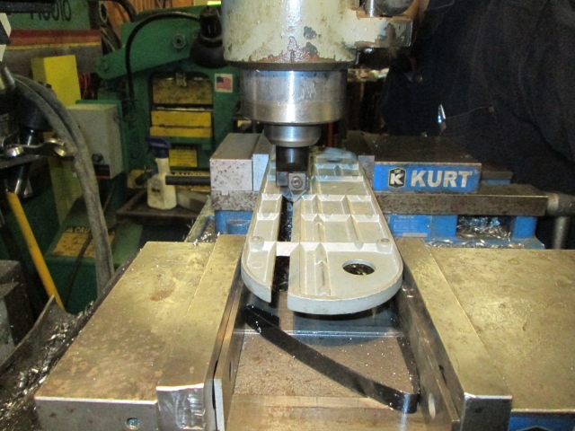

I had hand sanded the side of the table insert (using a couple of strokes from the small hand block with 100 grit) so that it would drop snuggly into the table opening. However, when we went to set the table parallel to the blade we couldn’t get it to move far enough to the side for the blade to clear the insert when tilted. We ended up filing the bolt hole slots in the top of the cabinet with a rat tail file to extend the table adjustment.
Despite fitting the table several times and filing more several times (thinking that something else must be interfering), we just couldn’t get the table to move over enough, and when we tried to dog it down parallel it would shift out of alignment just a bit.
After investigating several potential fetching points, eventually we figured out that one of the ribs on the underside of the table was catching on the edge of the cabinet. A little hit to both edges with a flap disc in the 4-1/2 inch grinder (just under the bolt head where the paint is removed in this pic) took care of that.
Now with the table aligned and the blade centered in the insert opening, the blade still wanted to hit the insert when tilted. Rather than increasing the adjustment slots further, having to remove the table for the umpteenth time, and having to realign the table again, we took the insert to the mill and clearanced the back of it with a 90 degree countersinking cutter.
After a bit of hand filing at the ends of the slot where the mill wouldn’t get into the corners, we got it to where we were happy with it.
One of the screw bosses for the fan shroud on the motor was busted out so the shroud could move on the other two screws. When we started hearing some noises while rolling the blade over by hand, I figured that the shroud was probably rubbing the fan. Then I noticed that the fan wasn’t turning with the motor, so I figured it must be slipping on the motor shaft. So I took the fan shroud off and was only mildly surprised to find that the fan was missing. The aluminum ribs on the motor end casing had fooled me to thinking that I was seeing a fan behind the slots in the shroud. We figured that the screw boss had been broken years before, and that when the shroud had rubbed on the fan someone's solution was to remove it. It’s probably not a big issue for intermittent use, but for production work or big jobs with lots of cuts, no bueno. I’ll keep my eye out for scrap motors at work and see if I can scrounge up a replacement. I think if I add a machine screw with nut in the shroud it will prevent it from swinging past the unbroken portion of the screw boss, and will keep the shroud out of the fan. The noise I had heard ended up being the little tin chip chute ahead of the blade; it needed to be tweaked so that it didn't hit the underside of the table when tilted in the fully raised position.
So how did we do? Well we could set the fence and adjust it exactly. It still wanted to be measured and checked and carefully adjusted (it didn’t just snap into place precisely), but having individual control over the clamps at each end is a plus for this, it is not that onerous to do very accurately, and once locked the fence is not going to move.
