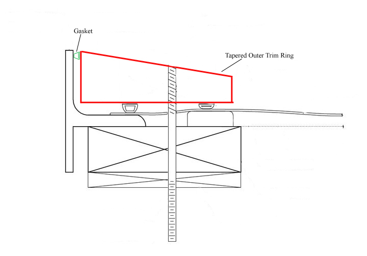

I see one problem waters going to pool between your vent and trim ring. It's hard to tell in the pictures whether the ring has higher sides than the vent. If it is the first rain you will find out if the vent fan lid has a water tight seal.

IASCOTT wrote:I see one problem waters going to pool between your vent and trim ring. It's hard to tell in the pictures whether the ring has higher sides than the vent. If it is the first rain you will find out if the vent fan lid has a water tight seal.
Scott
Yeah that was one of my concerns. The top lip of the fan housing is about 3/4" higher, so that shouldnt be a problem. I thought about drilling a couple "weep holes" in the back of the trim ring to maybe help some water drain out. Didnt get a chance to test it yet, but I'm gonna take a bucket of water and just dump it on the top to see what happens. If it just sits up there and doesnt leak in, I'm ok with that. That whole area is covered with silicone caulk, so I'm not worried about damage to the roof spars.
Scott
I've been thinking about this too. Thought about redesign of outer ring. If you widen the ring to put it against the fan housing and add a gasket. Maybe taper the ring to help shed water away from the fan housing as well.
I'm no designer, but I'll try to draw a pic and post it.
OK - tried to modify your drawing. Here's my thought:
Then I see you only have small pool between upper gasket and fan housing.
I'd keep the gasket you have on the bottom as a backup in case the upper gasket leaks.

Postby absolutsnwbrdr » Mon Nov 01, 2010 10:10 am
The issue with trying to seal up tight against the side of the fan housing is that the fan cover is larger than the fan housing itself, so you cant make the inside dimension of the "trim ring clamp" small enough (if that makes sense).
I did get poured on this past weekend on the way to the Knoebels Hallo-Fun Gathering. Unfortunately I cant say the trim ring was a complete success. It wasn't a complete failure either though!
Some drops found their way in, but for as much rain as I went through I was pleased. Once I got to my site and got my canopy set up I went to work investigating the leak.
It appears that the underside of the marine vinyl may have acted as a wick, and drew some water into the middle of the 2 rubber seals, and allowed it to run in through the bolt holes.
John, I do like the idea of the tapered top though... I think I'll end up modifying the trim ring to incorporate that!

While I was working on the trailer this weekend, I decided to try out my modified trim ring clamp thing. I didnt bevel the top edge yet, but I did trim the vinyl opening about a 1/2" larger so the edge of the vinyl rests between the inner and outer weatherstipping on the trim ring. Also put another ring of weathersripping on the base of the fan housing so it aligns with the trim ring. Then I slopped on a bunch of silicone caulk between the fan base and trim molding. I dumped a 3 gallon bucket of water on the fan lid and NO WATER LEAKED IN!! It did pool up between the fan housing and trim ring, but at least it stayed there and didn't leak in! Cant wait until I can actually sit through a rainstorm test it under real-world conditions!!
And heres the obligatory diagram in case my description is unclear...

Postby parnold » Mon Nov 22, 2010 11:19 am
Zach:
The only problem I see it the possibility of creating a dam. See attached. What about a little vinyl "bonnet" to cover the vent, attached to the outside of the removable trim ring? Also see attached..

Postby absolutsnwbrdr » Mon Nov 22, 2010 11:38 am
parnold wrote:Zach:
Thats exactly what happened when I dumped the water on it this weeekend!
The additional vinyl cover might be good insurance for while driving through thunderstorms, but I still want to be able to open the vent even while its raining :?

Postby GuyllFyre » Mon Nov 22, 2010 11:47 am
Why not make a trim ring more like this so it can be properly sealed and directs the water away?
