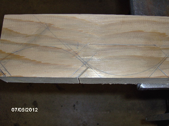

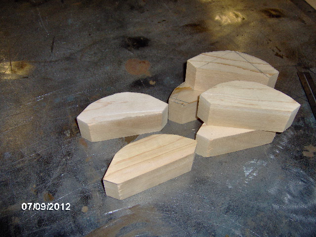

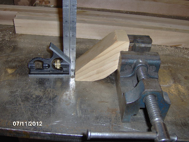

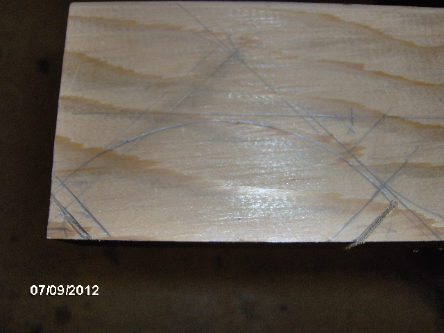

Here are some pics of the layout I did for the door corner blocks.
Karl thought that I should be able to just cut these out using the jigsaw, but when I tried that I could see that it was not going to be accurate enough.
That's how I arrived at the upstairs-downstairs method described earlier to get these.
The radii are just rough cut for now, but I did hit some of the rougher edges with the Surform rasp to knock down some of the steps that the jig saw left.

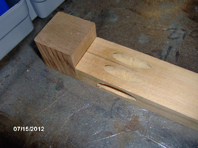

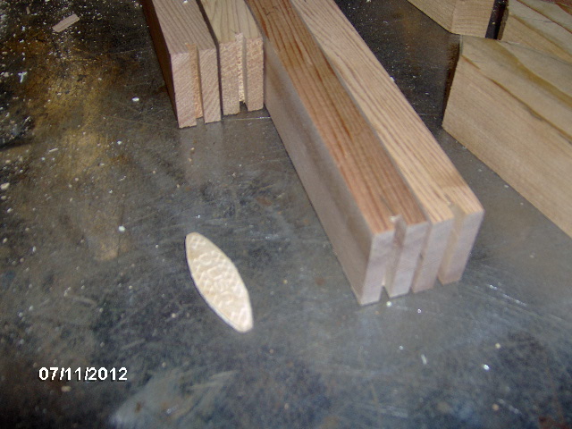

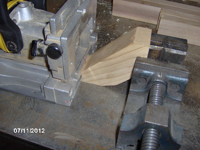

That was Monday. Tonight I started laying out and dry fitting one of the door assemblies. Once I had that situated, and had worked out where all of the biscuits needed to be I started cutting biscuit slots.
The corner blocks do have a small flat area at the tangent point, but I was not crazy/stupid/daring enough to try to hold such a small unstable piece while plunging the biscuit cutter blade toward my little pink digits. So I took Karl's small machinist vise and used it to clamp each side of each corner block square to the table.
That allowed me to hold the part securely while operating the joiner.
(Posed photo.)

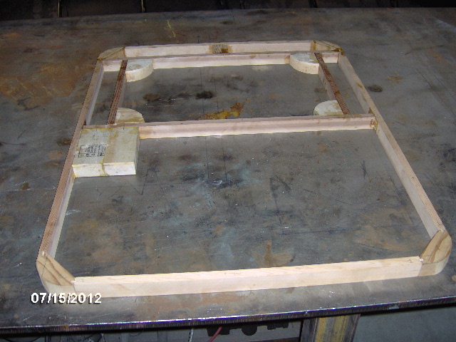

The door hardware (latch/lock/bolt mechanism) blocking is made up out of two pieces of 2x4 ripped to 3 inches wide x 6 inches long (actually a little less than 3 wide because I decided to rip off the remaining factory edge radius, after already ripping to 3 wide. Karl had a scrap piece of 2x10 or 12 that I could have gotten these out of in one piece, but it was fir and had some splits and checks in it, so I decided to use the fresher pine stud material on hand. The latch blocks will be joined using several No. 20 biscuits, while the rest of the door frame will get No. 0 biscuits. The ones in the vertical edges of the corner blocks needed to be cut down about 3/16 inch on each end so that they did not extend out of the slots and potentially interfere with the frame laying flat on the table during glue up.
Here is the completed dry fit up with all biscuits in place (after missing some slots in the wall sill, no more skipping the complete dry fit step with all biscuits installed).
The outside radius blocks in the corners of the window opening are just the off cuts from the door surround corner blocks and will eventually be template cut to inside radii using the same inside corner template as before. The header at the top of the window opening intersects the tops of the jamb and latch stiles, so I could not use a biscuit at this location without cutting the corners off of the stiles with the joiner, so these joints will be glued and screwed with no biscuit.
The No. 0 biscuits that I have seem to fit the slots loosely compared to the larger biscuits, so the corner blocks are not as stable a fit as I would like them to be. This will make it harder to get the alignment right during the glue up. If I had it to do over I would have designed the corner blocks differently, but I was trying to save a little weight... not going back.
My original thought was to use 1/4 inch shims on two adjacent sides of the door frame and clamp those sides into the wall frame opening, then use wedged shape shims between the other two sides and the wall frame opening to drive the parts together during glue up. However, the corners being unstable and rough cut means that that won't work like I thought it might. At the moment I am thinking that I could tape freezer paper to the table, trace the door surround opening on to the paper, then build the door frame over the paper aligning to the tracing (ugh!). If I pre-glue some of the window frame parts first that would help stabilize the rest of the corners and I might be able to put a strap around the whole door to pull the corners in tight at glue up. Lot's of hard ways to do it with little assurance of success.
Need to noodle this one over before going over the falls in a barrel, so to speak.

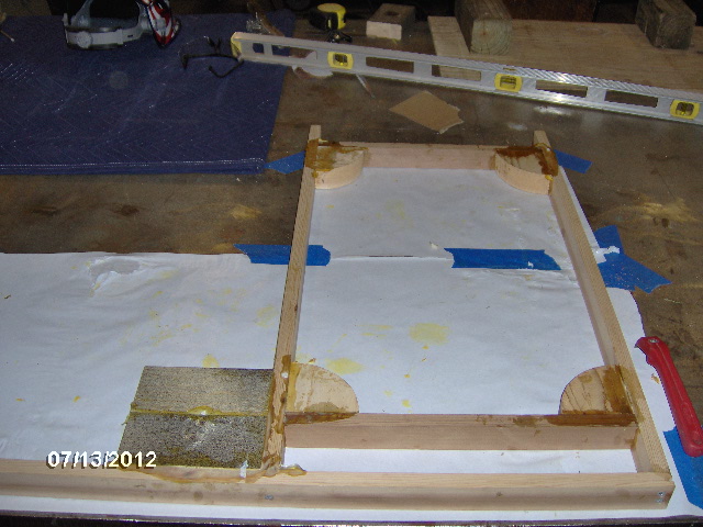

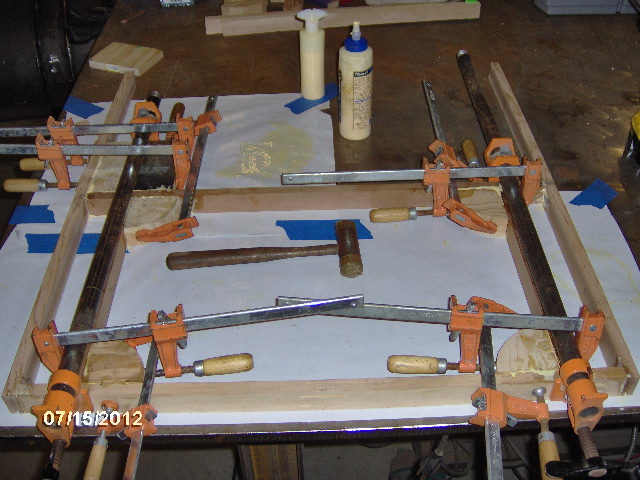

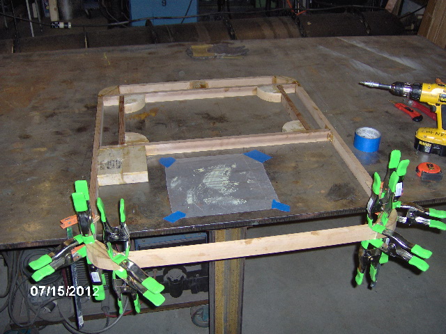

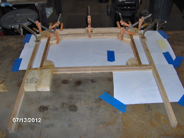

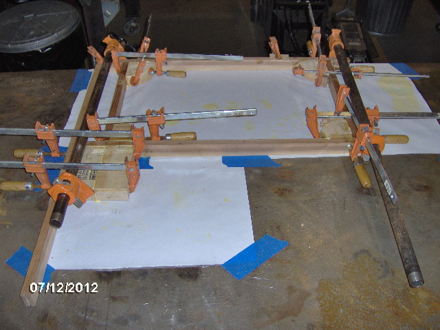

After discussing the many options for gluing up the door frames with Karl, I decided the most practical way was to just glue the door frame up by itself on the bench, making it as square as I could, then fit them to the door surround as best as I can either by planing or sanding the door.
One of the things I noticed during the dry fit up and biscuit cutting of the door parts was that the window header, being flush with the top of the jamb and striker stiles, could not be biscuit joined to the stiles. If I were to cut slots for both the window header and top corner blocks, the slots would intersect and cut the corner off of the stiles. So the window header would need to be screwed and glued. So as to miss the biscuit with the screw and to have the screw go through the end grain at an angle I set up the joint like this.
The block in the corner is just being used to square the joint temporarily.

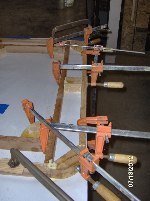

Here's the window frame with the blocking for the latch hardware and the striker stile glued and clamped.

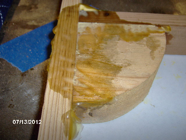

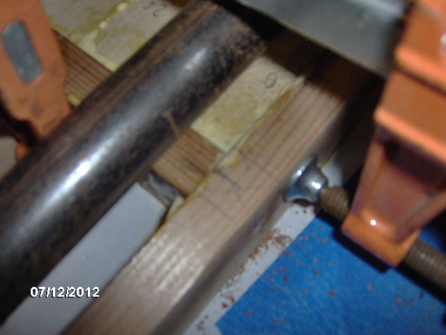

At some point during the glue up, when I put one of the pipe clamps on, it shifted the joint at the window sill by about 1/8 inch (there's that number again). I measured everything and I couldn't find anything else that was more than 1/16 inch out, including the diagonals, so I sunk a screw in to lock it down. Later I was able to figure out that I had not put the pipe clamp in a direct line with the window stiles (side verticals) and that had actually bowed the window sill about 1/16 inch in the middle, but about the 1/8 inch at the latch blocking. The window will fit fine, and there will be no outward evidence, so it will be fine.
Here is the partial door (window frame, latch block and striker stile) prior to scraping excess glue (top of window is to the right).
Here I have glued the top header and upper corner blocks onto the window section.
In this close up you can see that I have added a middle block to help stabilize the header. The corner blocks were not stable enough by themselves in dry fit to hold square. (Top of door is to the right.)

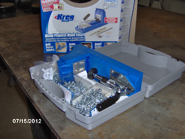

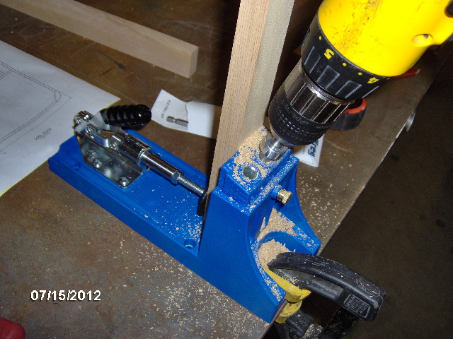

Today (Sunday) I stopped at Ho-De-Po for some more #20 biscuits, pneumatic staples, and a Kregg pocket hole screw jig kit. Here it is assembled and with the extra screws I bought.
Tested it on some scraps.

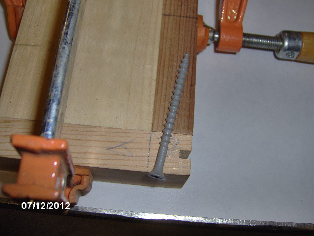

Back to building door frames. Here I have scraped down the excess glue and dry fit the partial door frame with the bottom plate and corner blocks.
I decided that the most stable way to glue up this bottom part, without resorting to extra blocking, would be to use my spring clamp and dry wall screw clamping technique.
On the second door frame I decided to use the Kregg to lock the window stiles to the window header and sill, and to tie the window header into the side stiles.
Here is the second door, shown upside down, with all but the corner blocks, and sill and header plates installed.
Came out great after the learning curve from the first door.
Tomorrow I should be able to get at least the header on the second door, if not the sill plate, too.
